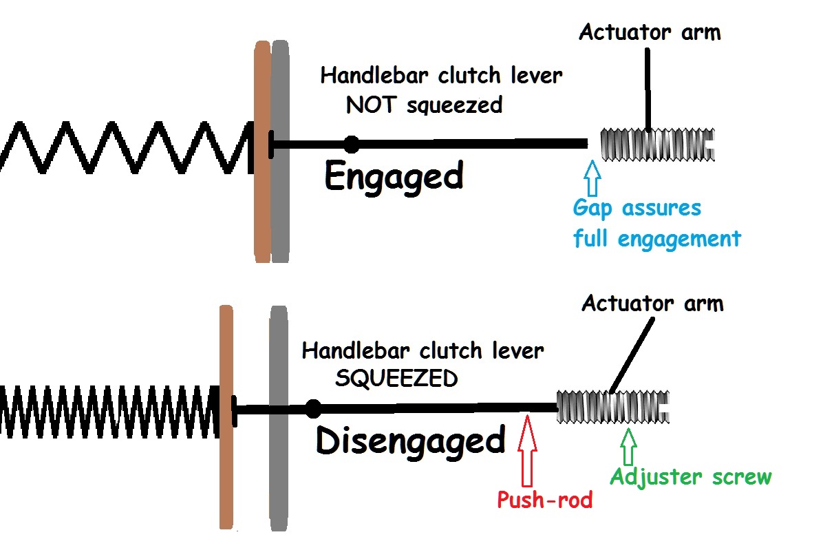

Yeah... something sounds a little funny - it really shouldnt need constant adjustment. granted they so stretch at first, but not too much, and not for long.
Have you adjusted it at the middle adjsuter correctly? That takes up lots of slack usually.
OH, make sure you have correctly setup the clutch rod pressure on the sprocket cover (engine case).
maybe the nut has slipped and its backing away from the rod... :blink:
Check it.
Check it.

29 May 2011 09:52TeK9iNe wrote: ...correctly setup the clutch rod pressure....
Yes. The gap might be too big and thereby requiring excessive cable play just to close the gap before the adjuster screw meets and begins to press against the end of the push rod.
