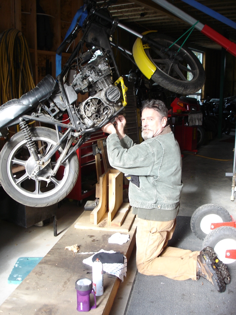

Here are some pictures of my bike, hopefully someone can identify it correctly.
I'm currently still trying to remove the clutch casing and still no signs of budging.
