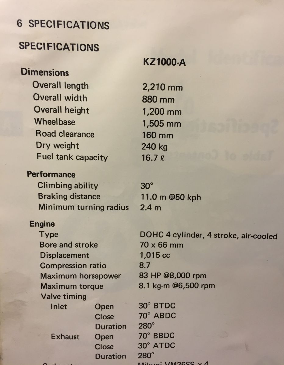

Yes...
Below is page 6 out of my Factory Service Manual showing fuel capacity at 16.7 liters....or 4.4 gallons!! NO F'n way!!
