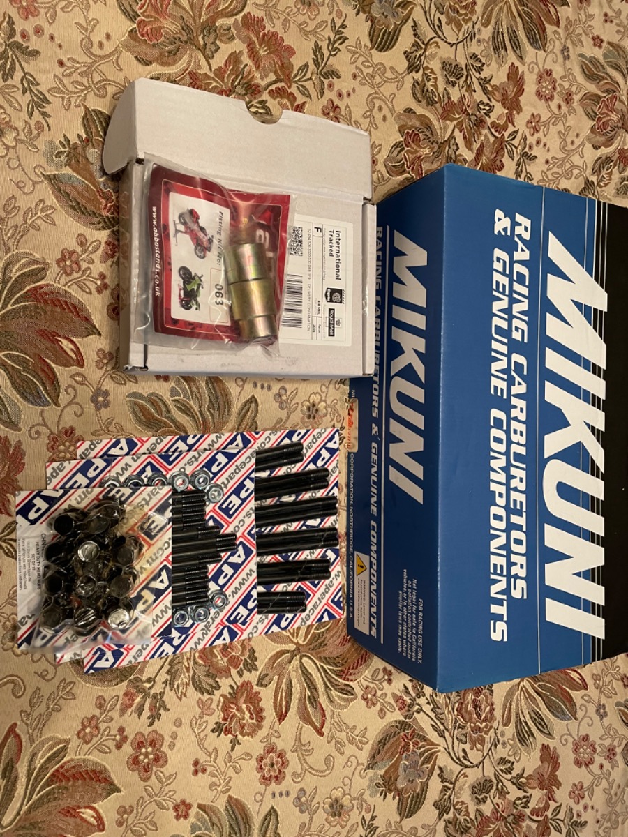

Welp, my KZ has lived disassembled in the back of my gayraj far too long, so I am finally gathering what I need to get it back on the road. I will start a proper build thread soon, but wanted to begin with this thread, as I will have some preliminary questions. I have been accumulating some parts along the way, and here are the most recent arrivals.
