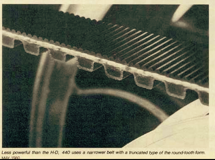

Nope, the teeth are different shapes.
The Kawasaki is a more squared tooth whereas the Harley tooth is more rounded.
I gave up after days of research and converted to a chain.
It could work but I wasn't going to risk it.

If the pulley teeth fit fully into the belt spaces, I am not so sure those rounded corners would matter.

08 May 2022 03:11 - 08 May 2022 03:16I would agree with Texas, if correctly tensioned I can't imagine the 400 has enough torque to tear up the belt. However looking at F64's post it looks like the HD belt is wider so will it fit between the belt guides on the sprocket (if it hangs over the edge this will create a weak point at the edge of the sprocket )If the pulley teeth fit fully into the belt spaces, I am not so sure those rounded corners would matter.

From the video he posted, it looks like it fits well width wise. My 1983 model runs a 1 1/4” wide belt. From the manual the older bikes run a 1” belt. I am not sure what year that changed. My concern with the rounded teeth is how tall the teeth are. Is there enough flat on the teeth or are they completely rounded from the base.

If you have concerns about the belt take a look at the link below, I used to maintain these bikes and none ever stripped a belt ( even the 110 inch screaming eagle FXDX with 100 ft-lb of torque) even with this Level of abuse. I get the difference in tooth profile but as I said, if it is adjusted correctly I don't see you having an issue (for the belt to slip it has to flex away from the sprocket)
