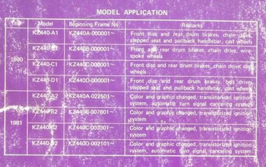

Okay, so i picked up a 1981 KZ440 LTD (according to the gentleman selling it) now going through kz400.com and the model identification page, i discovered by getting engine numbers and frame numbers that its actually a 1980 KZ440D (im assuming) but then the manufacturing date says its from June of 1980 which makes me think its actually a 81 but like i stated earlier numbers all suggest its a 80. ANY SUGGESTIONS?

Thank you so much both of you, with the information that was provided I'm pretty sure I have a 1981 D2. Now to find a belt.
