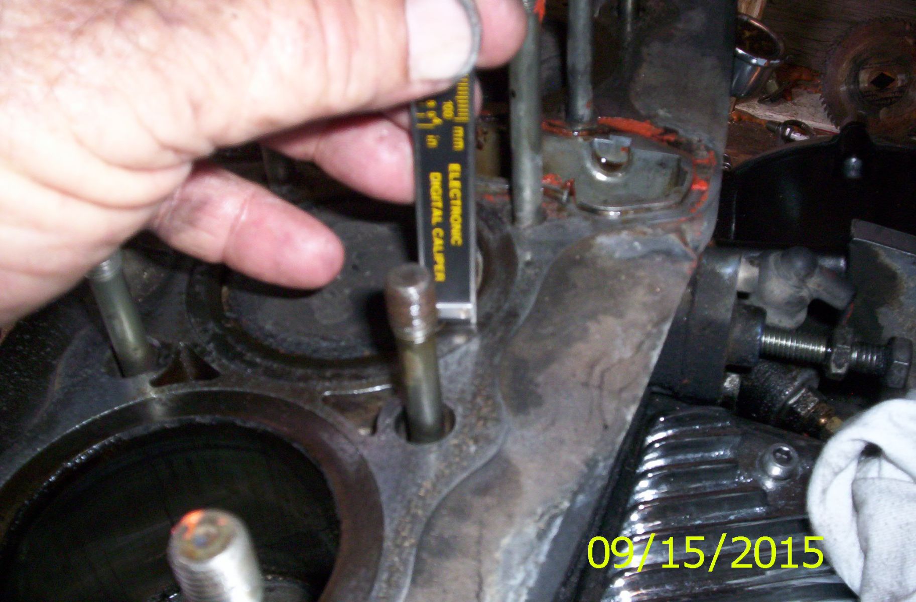

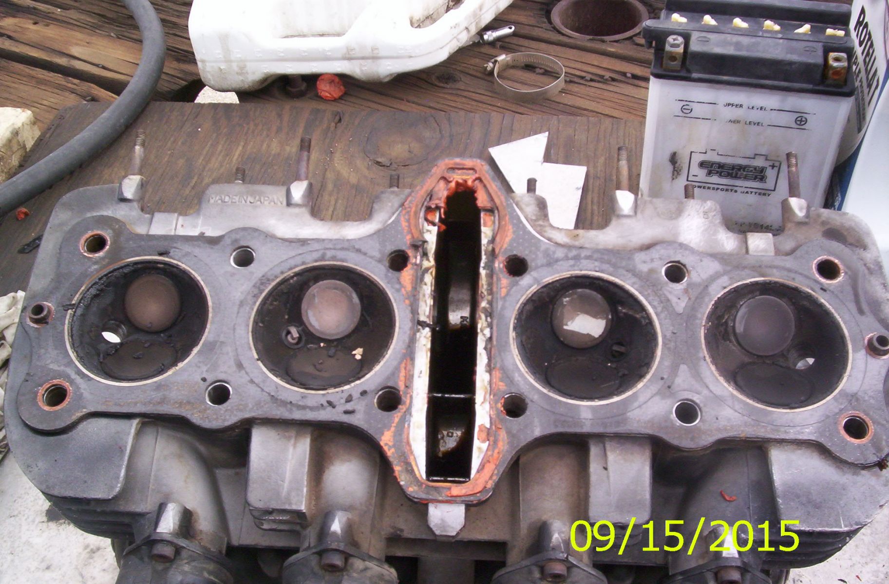

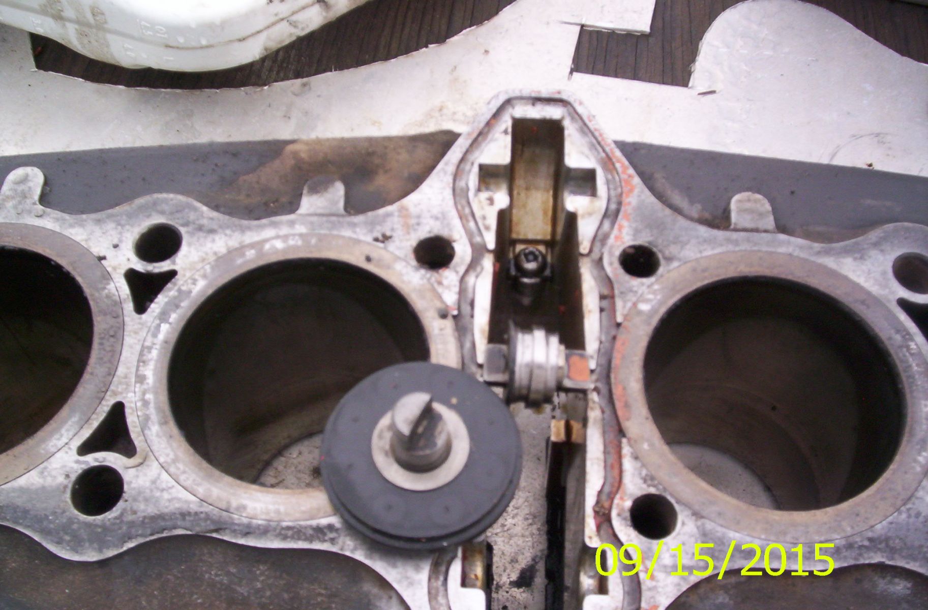

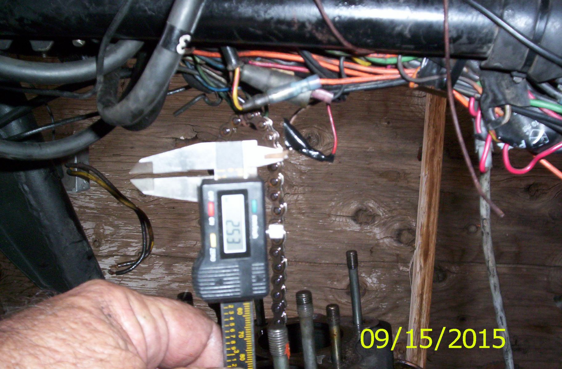

DAMAGE; I've been saying the manual adjusters are dangerous. Here's why.
I got it too tight and destroyed the center rubber roller and the front guide. As the chain became noisy, I kept adjusting it. Good thing I bought some extra parts and decided to do this. :dry:
The 903 block is in front. The 903 gasket worked just fine.

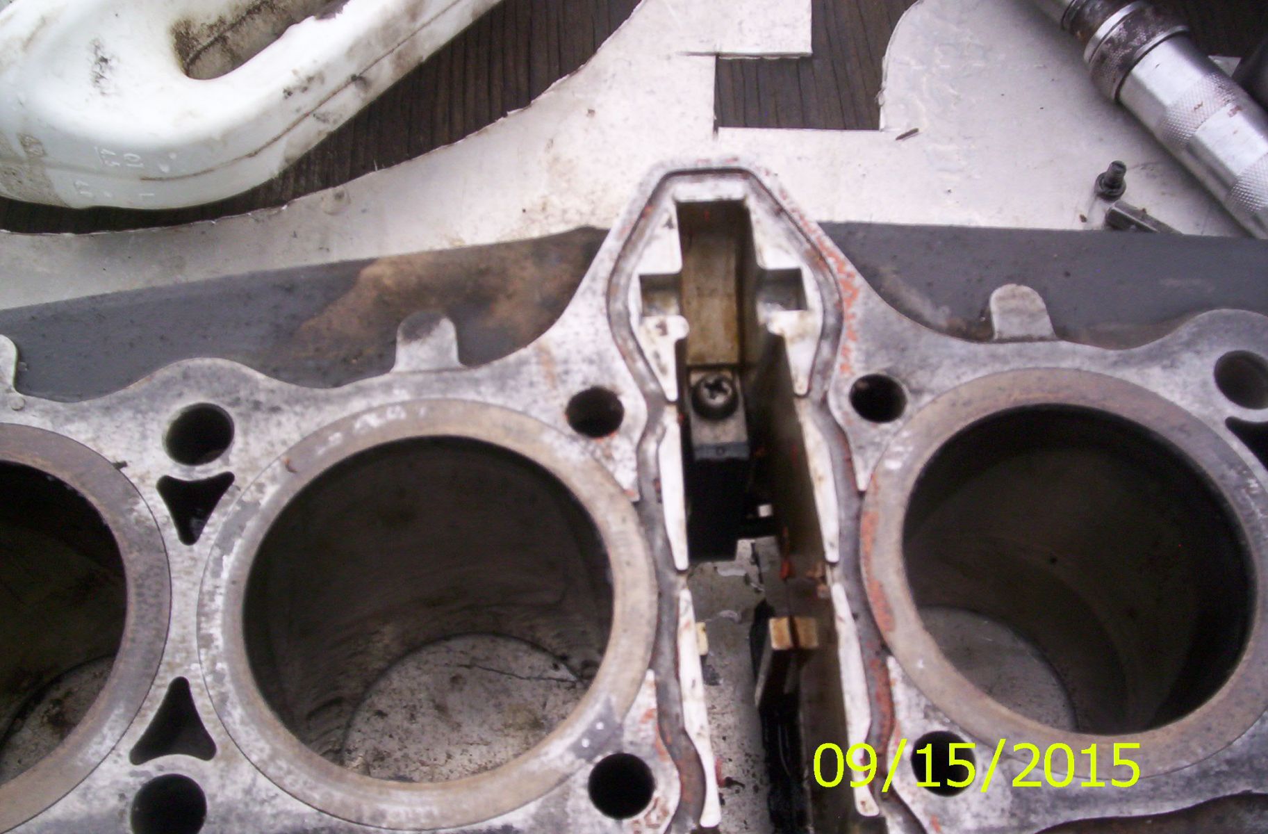

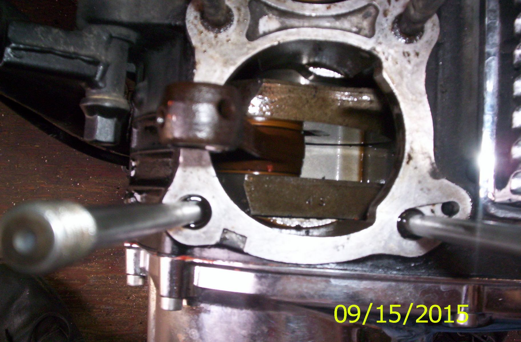

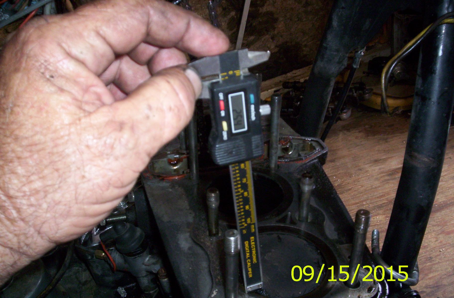

Here's the deck height.
2,5mm below the deck.

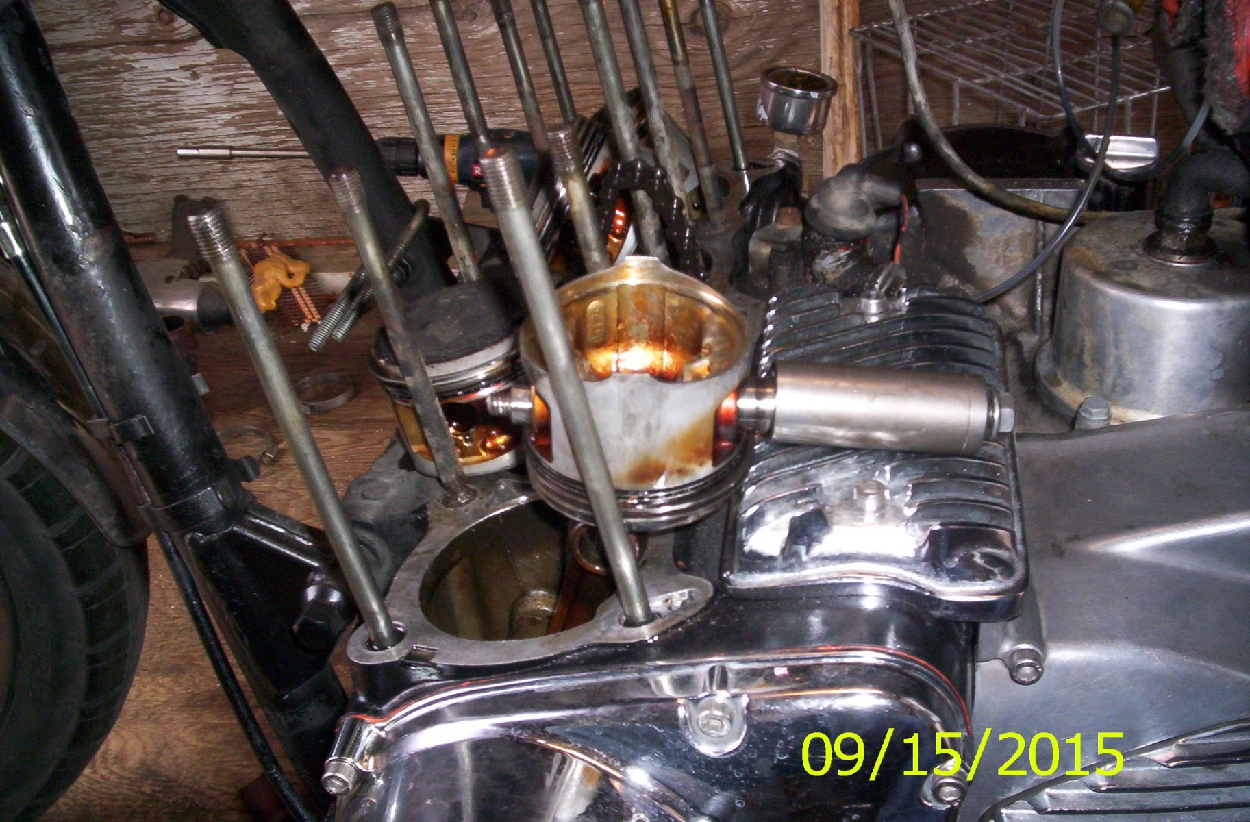

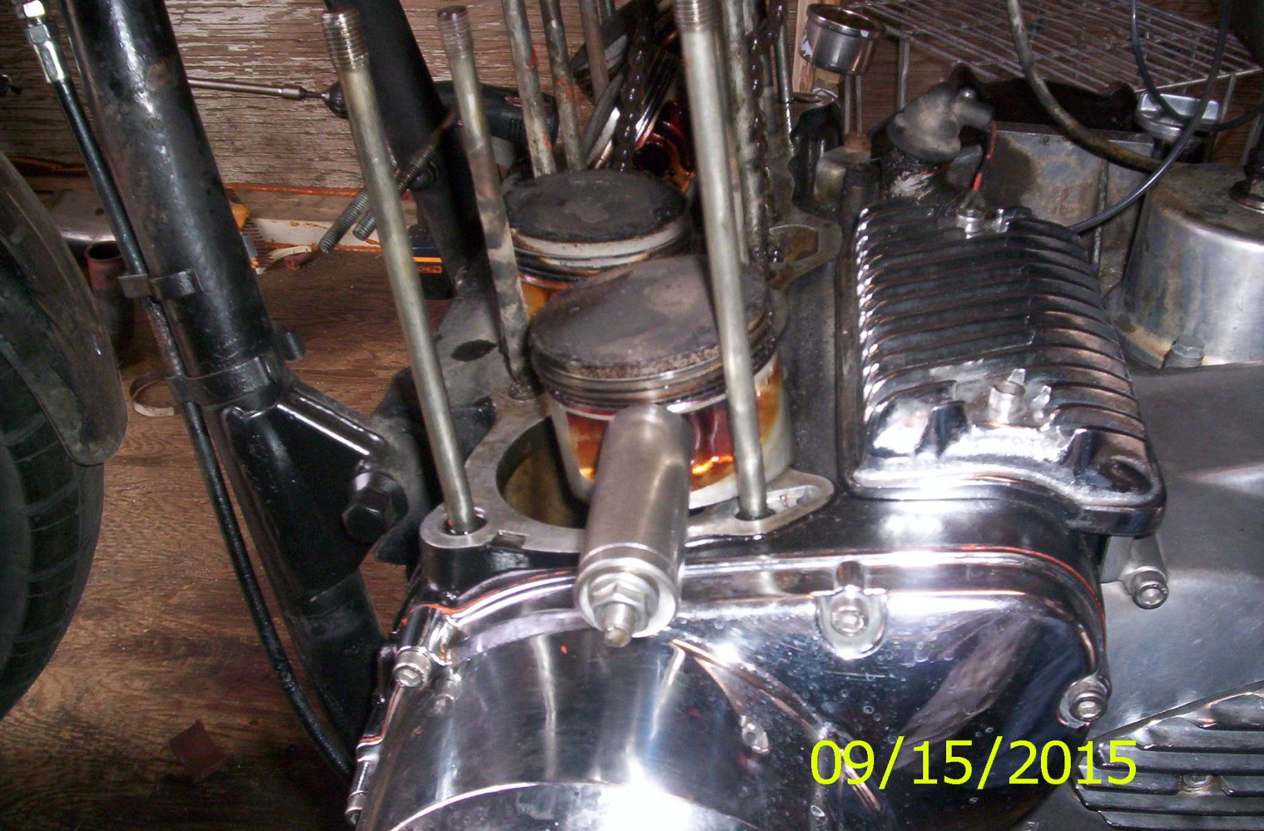

Home made tool for removing pistons.
Talking the head inside for cleaning and honeing the cylinders.
Had a broken ring on #4 piston. No damage.

Yikes!! Did you find any of the rubber and dampening material junk in the oil or stuck in the pickup screen. I did, many years ago, in my 77' KZ1000. It had crap in the oil that I found was material worn off the wheel and front slider guide!! I was forced to do the same as you and I've never used a manual chain tensioner.

- Posts: 23782
Re: Z2 750 crank (Bossie the Kaw)
15 Sep 2015 15:38 - 15 Sep 2015 15:39
I still have my spring loaded tensioner. I'm tempted to put it back on. If my chain had broken, it would have made for one FK'ED UP DAY. :ohmy: It's ironic I was warning about them and here is the perfect example.
You can see the number 45 stamped on the crank. Before I button it up I'll measure the rods. 2.5mm is a lot. No wonder I had low compression. If I lose cc's, so FKing what. That would mean it IS a 750 crank and should spin faster as planned. I'll take more pics tomorrow.

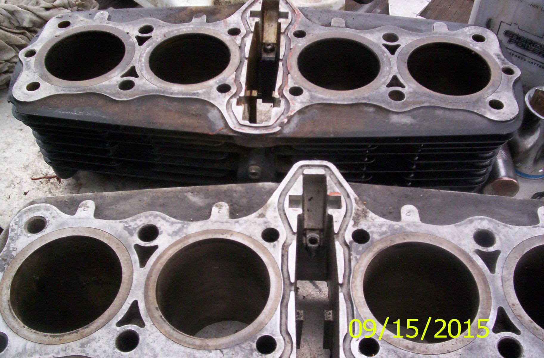

looks like you need a valve job i would send it out and have new viton seals put in .one of the cylinders looks pretty scored up time for a rebore.take some more pics so we can see how bad the cylinder is do you have a dial bore gauge to measure the tapper ? and take a valve out so we can see how bad the seats are.

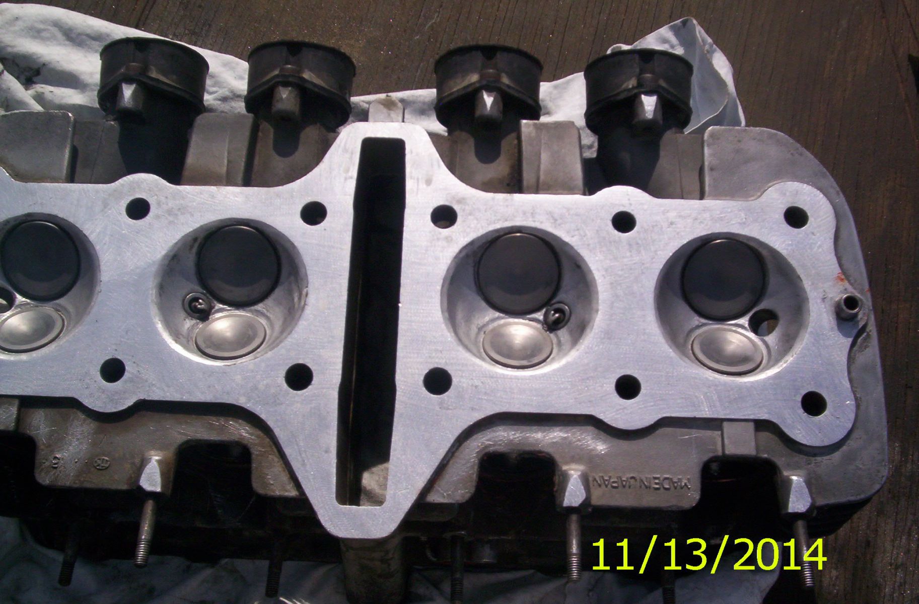

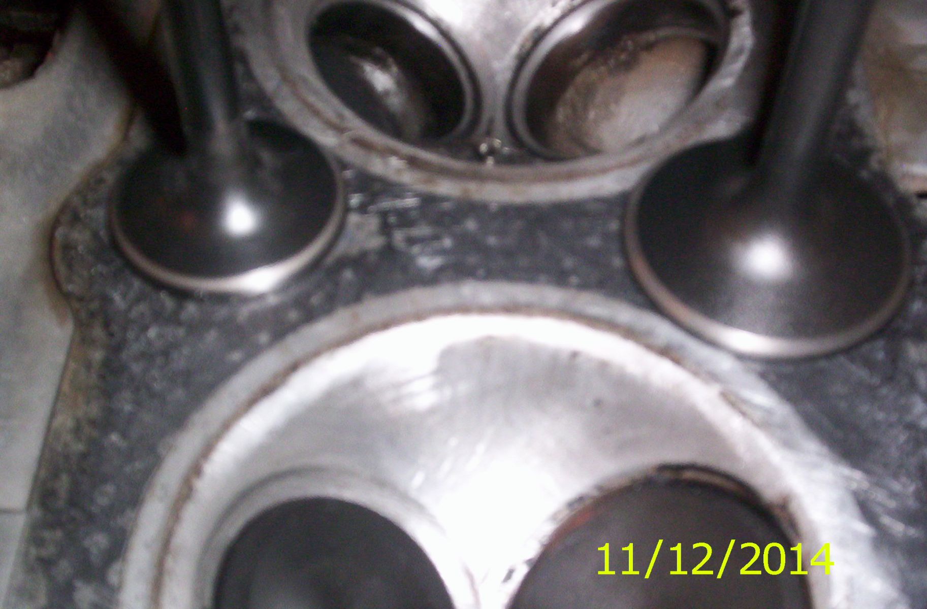

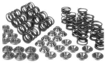

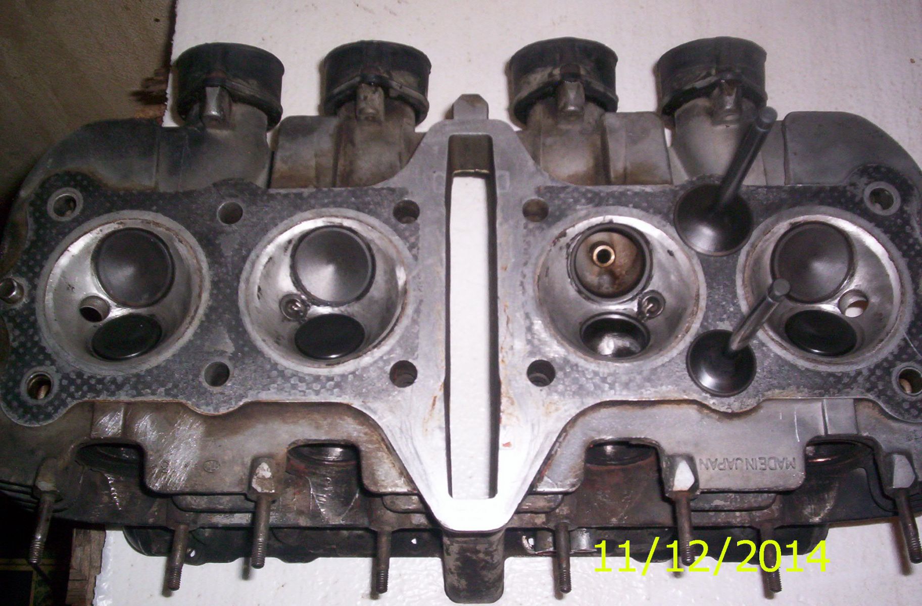

I have no interest in YOUR opinion or anything you can dig out of a book. :lol: Valves done last year. For everyone else.
Kibblewhite valve springs, new valve guide seals, new Dorimi valves. More pics to come.
kzrider.com/forum/2-engine/596420-valves#653678

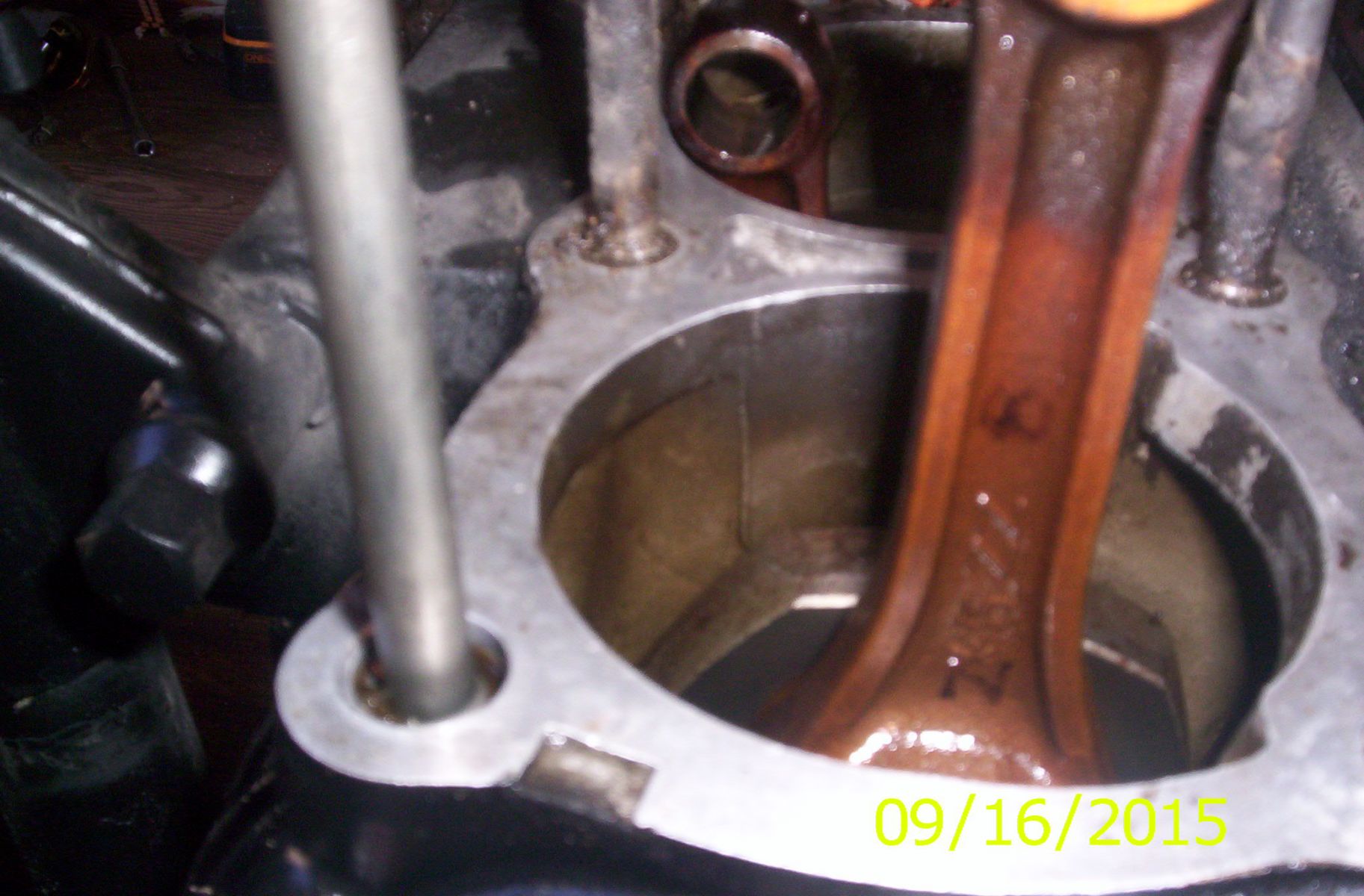

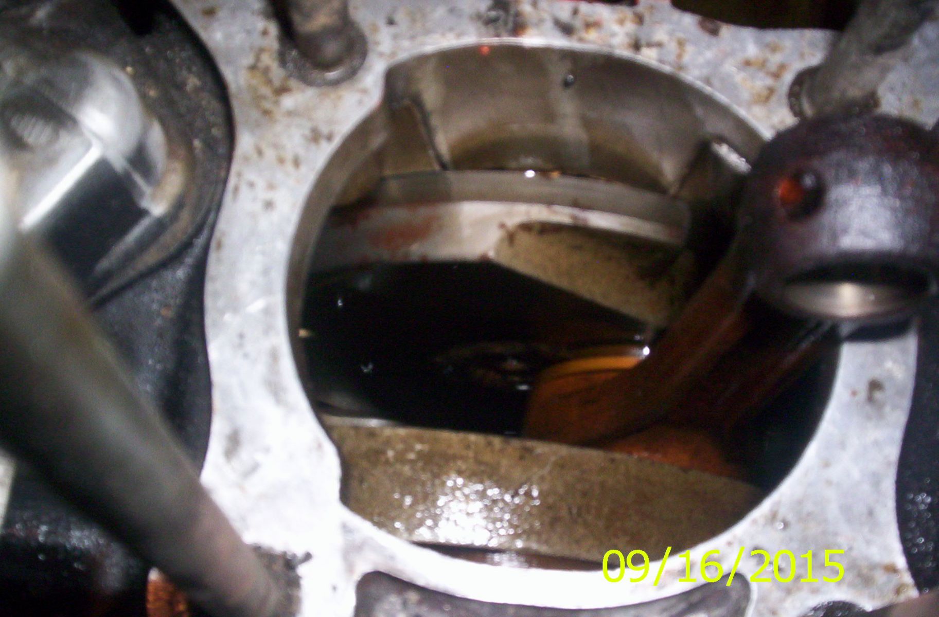

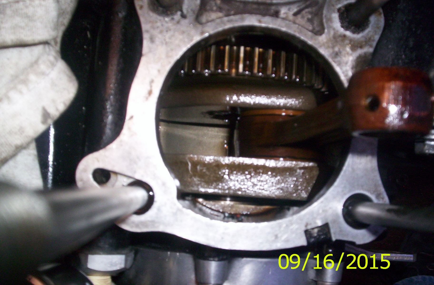

16 Sep 2015 09:07

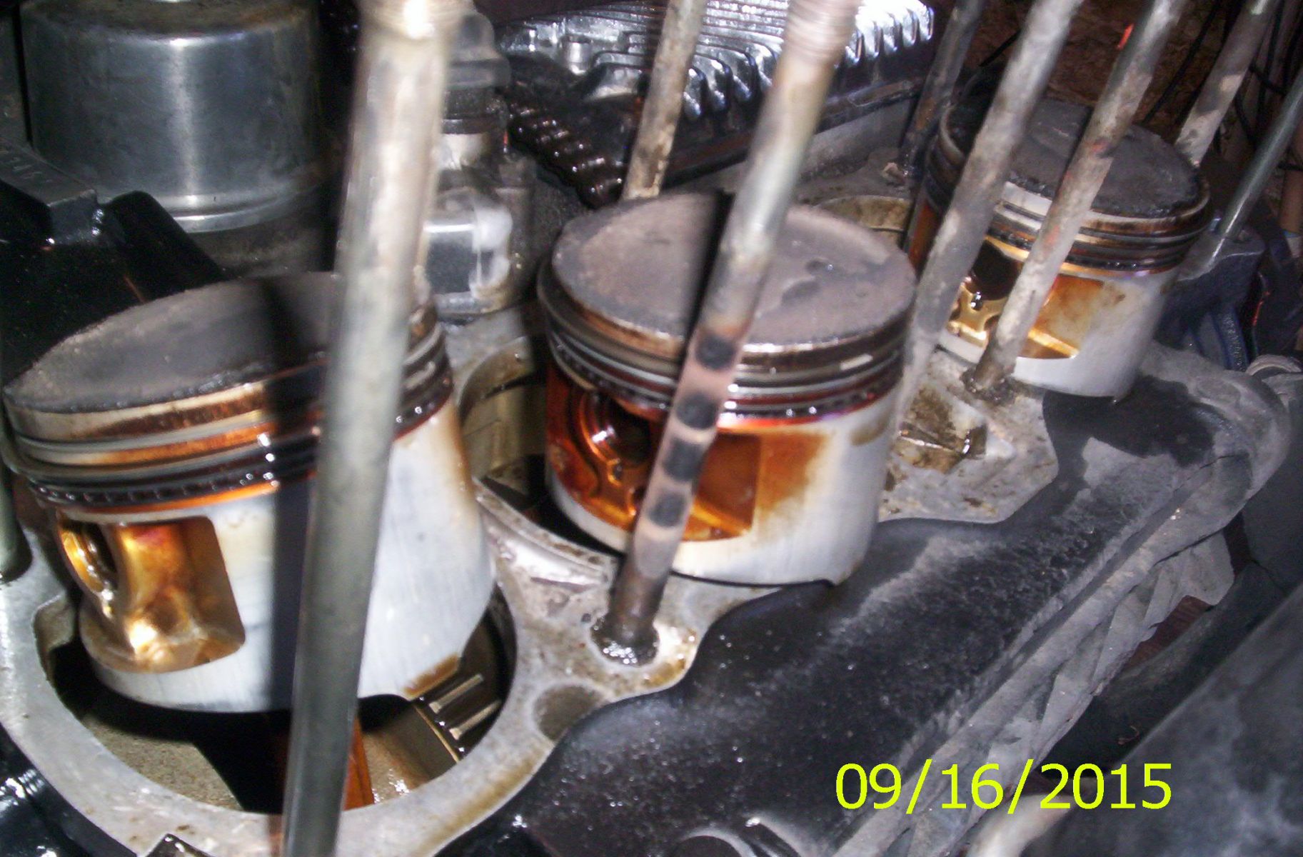

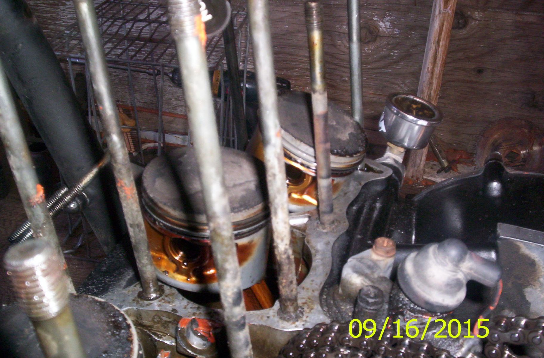

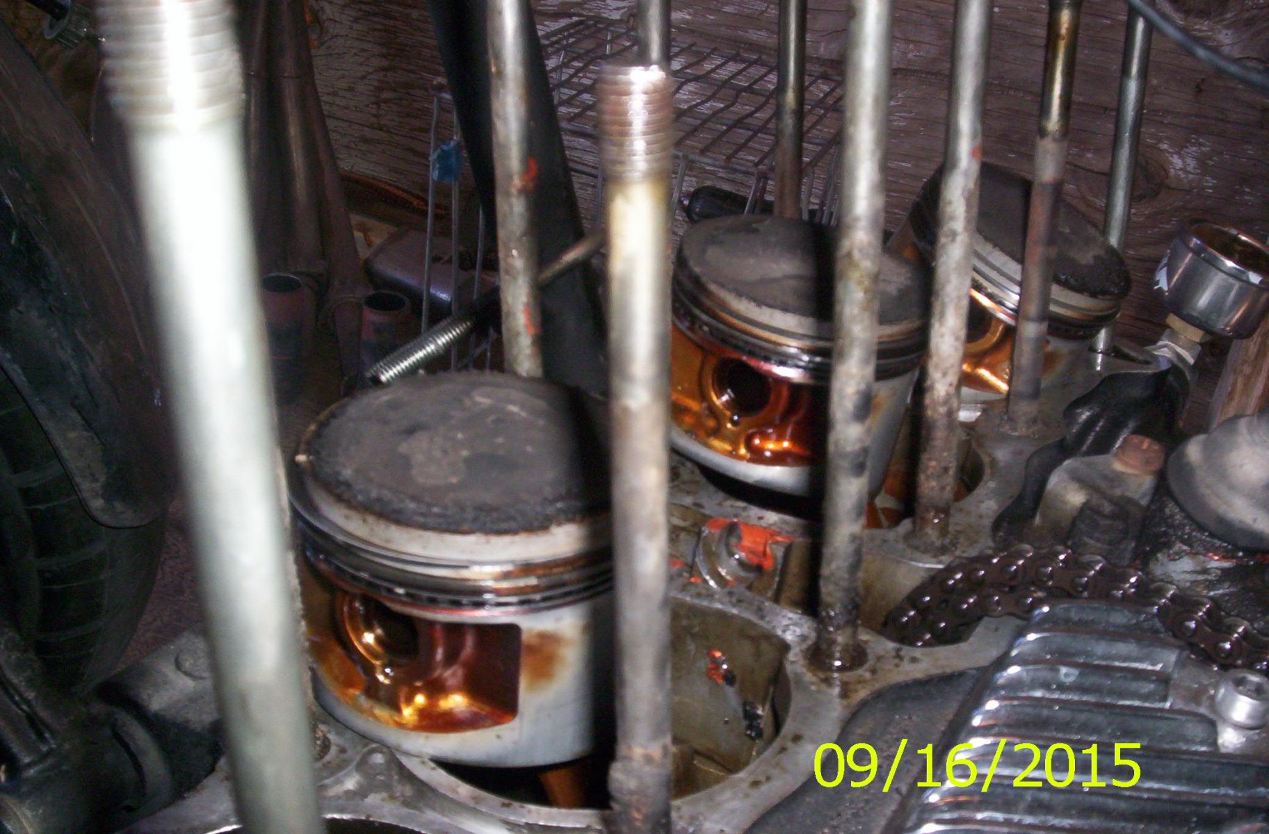

I took some pics of the rings. They migrated quite a bit. Not close to where they were set.

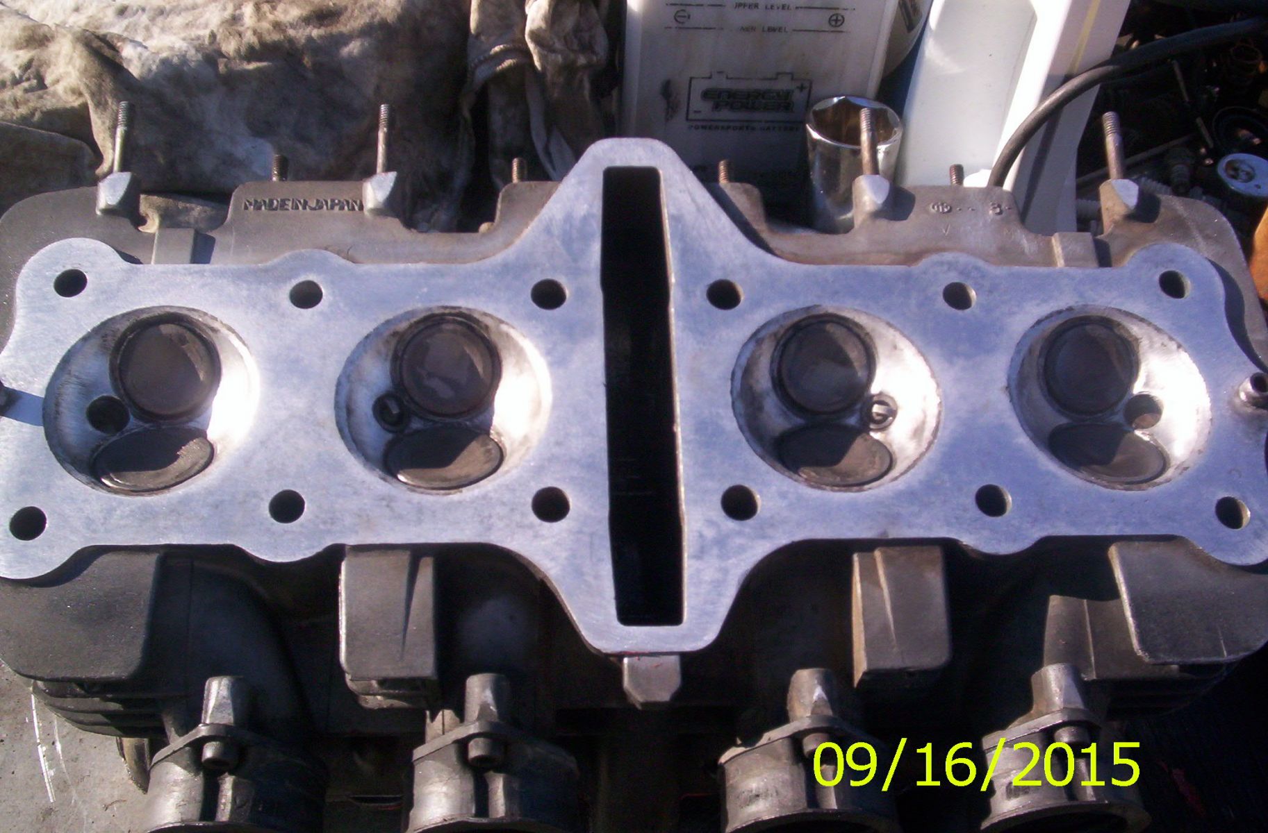

Head cleaned up, painted and ready to go.

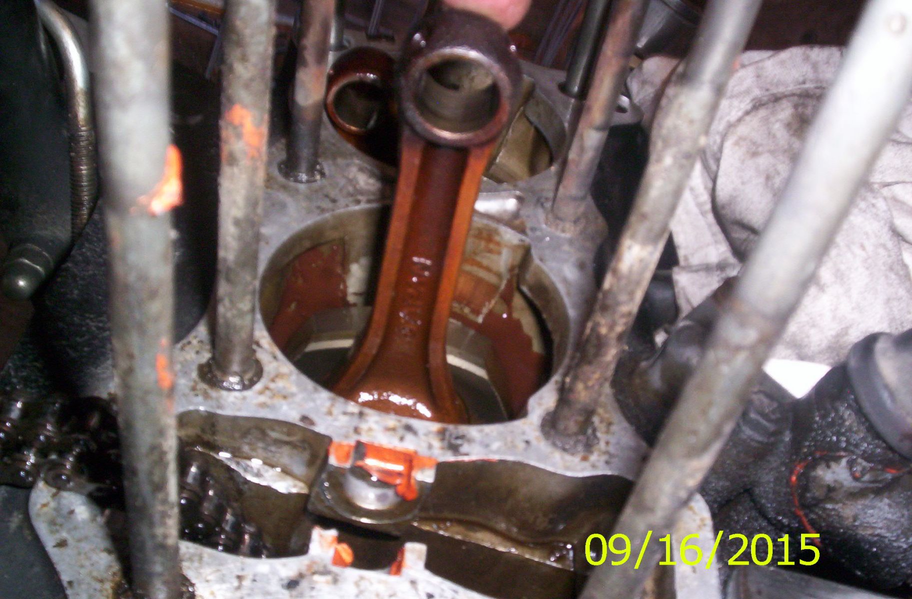

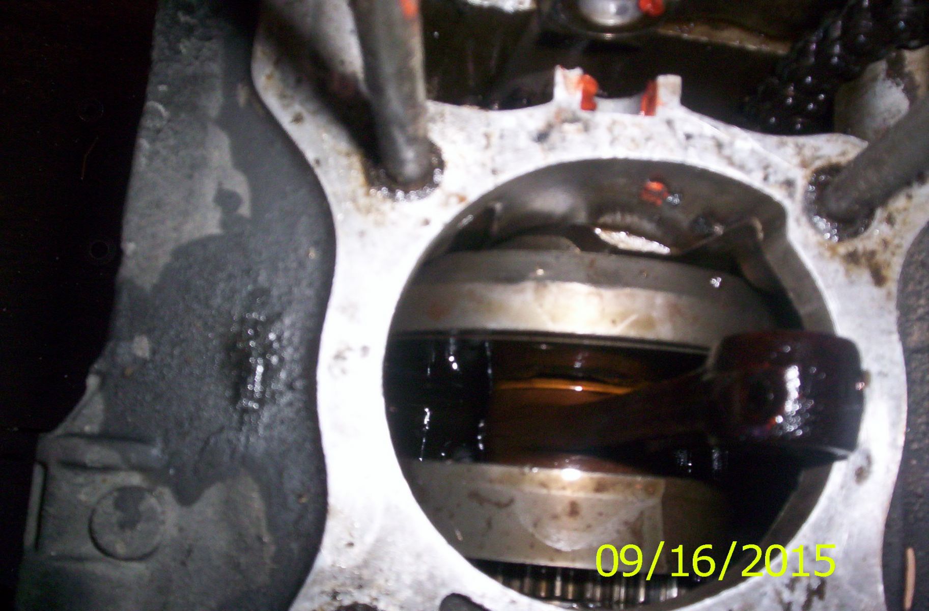

Some pics of the crank and rods. The only place you can see where it was welded is the center pin. I'll also jot down the markings on the rods. You can barely see them.

Interesting looking below the rings where the oil has been burning, and how it differs slightly between pistons. Looks to me like they were past their best.
I'm thinking now the most critical thing for good ring seating is the cross hatch hone, I have a honing tool taht I've used in the past but In future I'll leave it to a pro..
