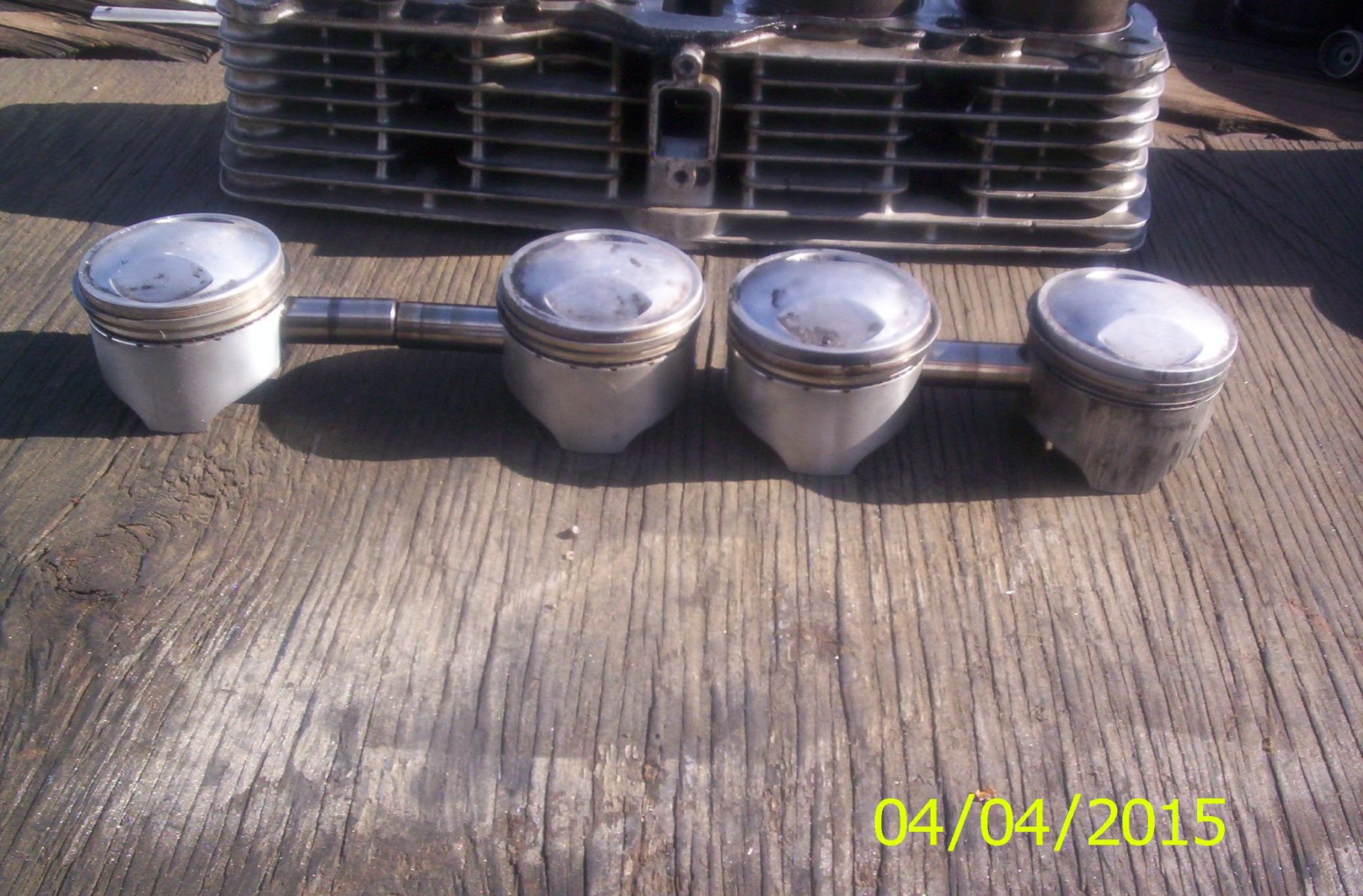

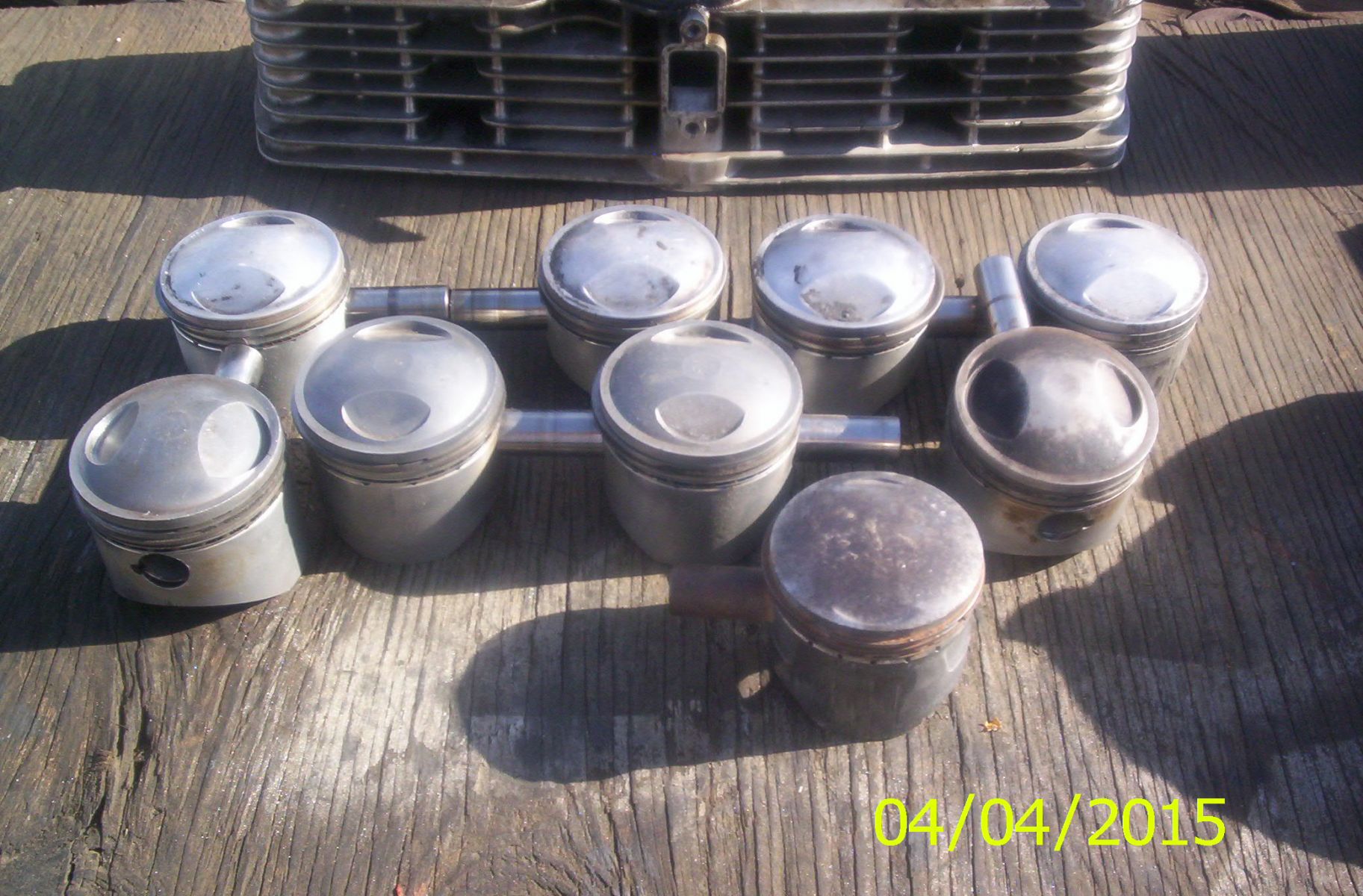

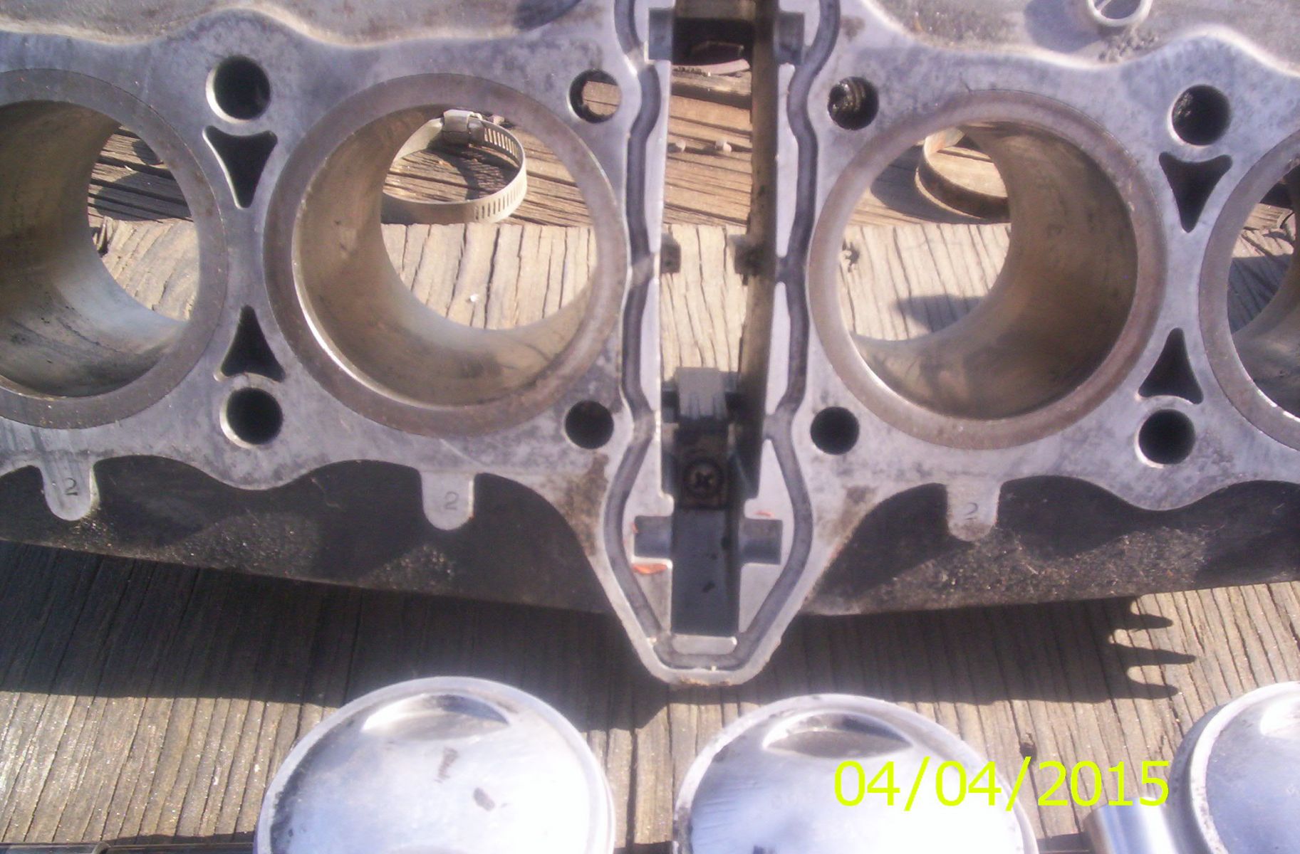

The sleeves were out of the 750 motor. The bore was still good when I replaced the cast pistons. They were damaged when I lunched the one piston. Notice there is no groove at the bottom of the sleeve as there would be if they were bored out 900 sleeves. Not much but it would still be there.

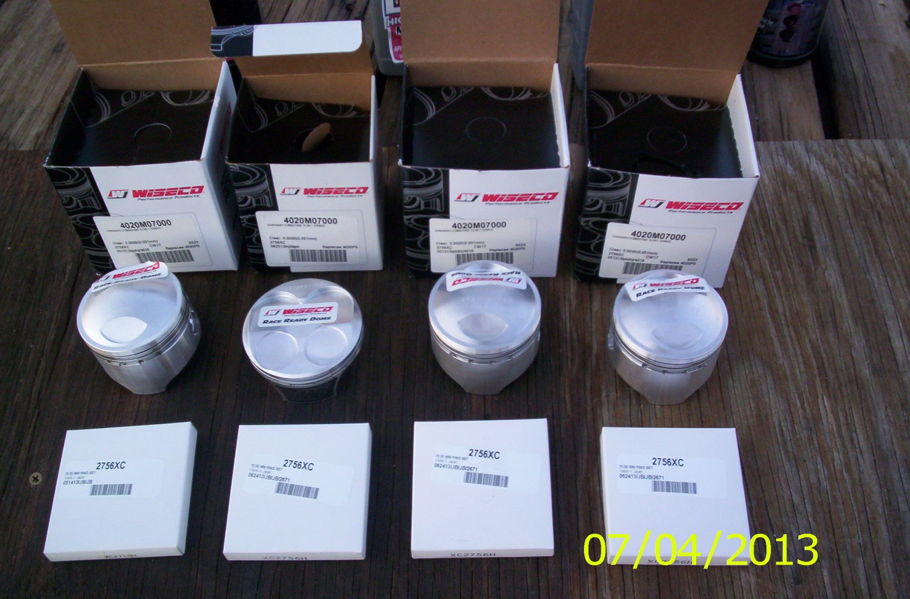

The billit pistons are shorter and lighter than the cast ones.
Here they are for compareson.
The one in the front is a 903 piston

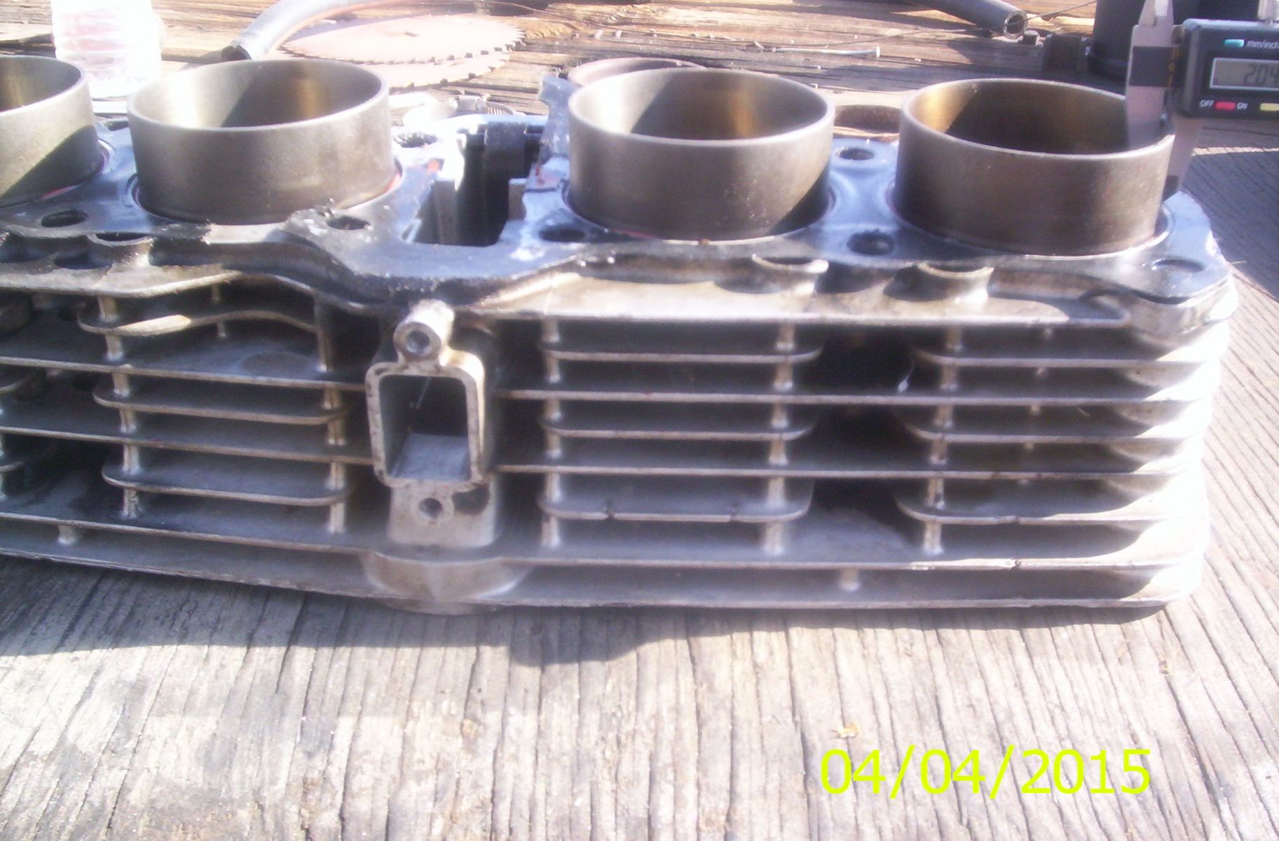

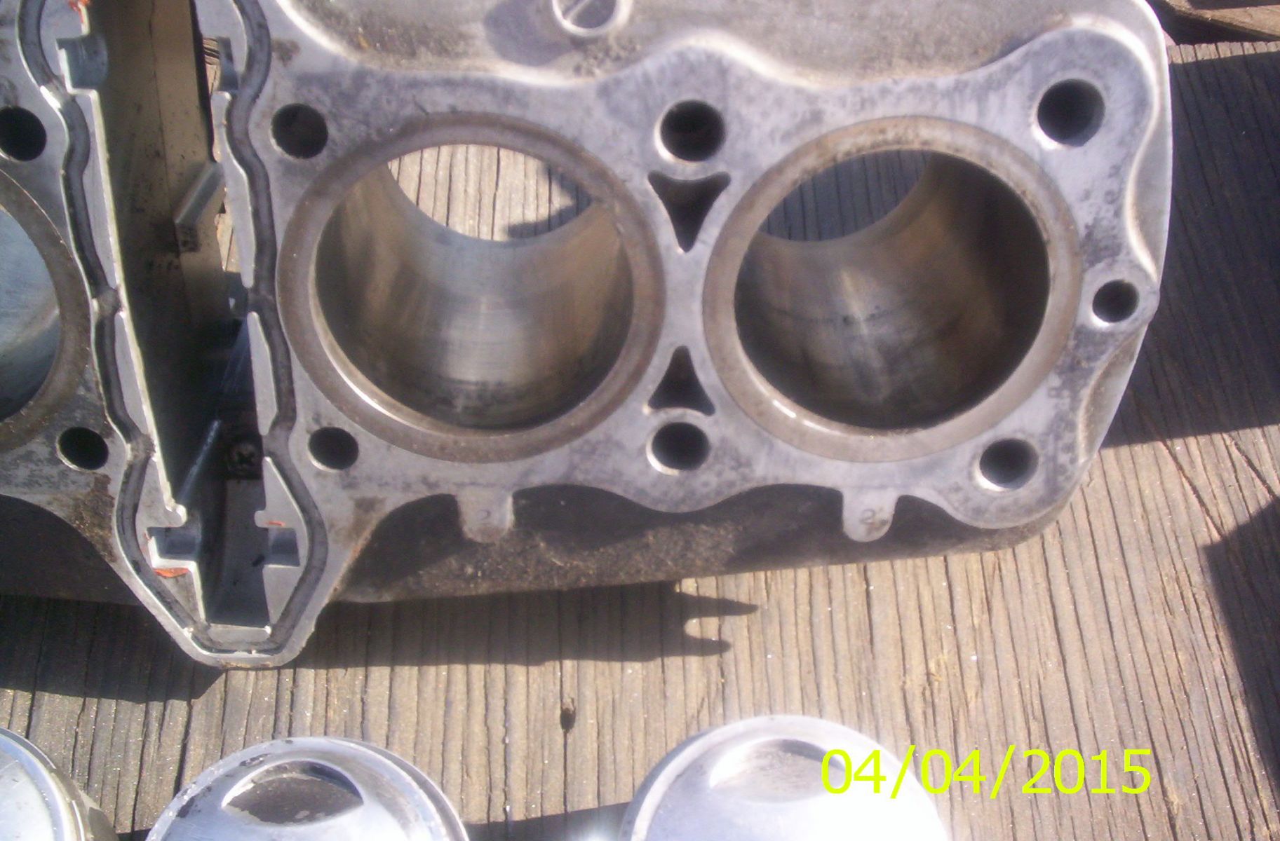

The jugs are just under 2 mm. The bores are scored but the problem was they are pitted as well.
That's why I bought the 1015 block and pistons. Good thing too, I'm running them now. Light hone and back on the road.

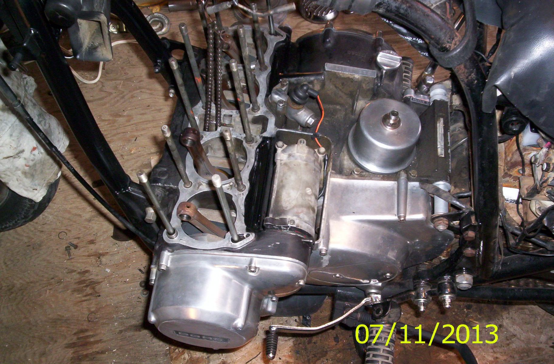

I'll be adding more pics of the items I've "claimed" to have on the bike. When I get the block off, I will show the infamous 750 crank shaft. What the deck hight is now and after the 10.25 are installed.

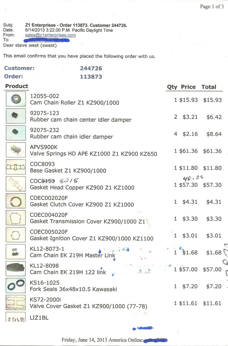

Here's another page to add to my poser file.
It was like Xmas. Polished everything I could, just waiting for parts.

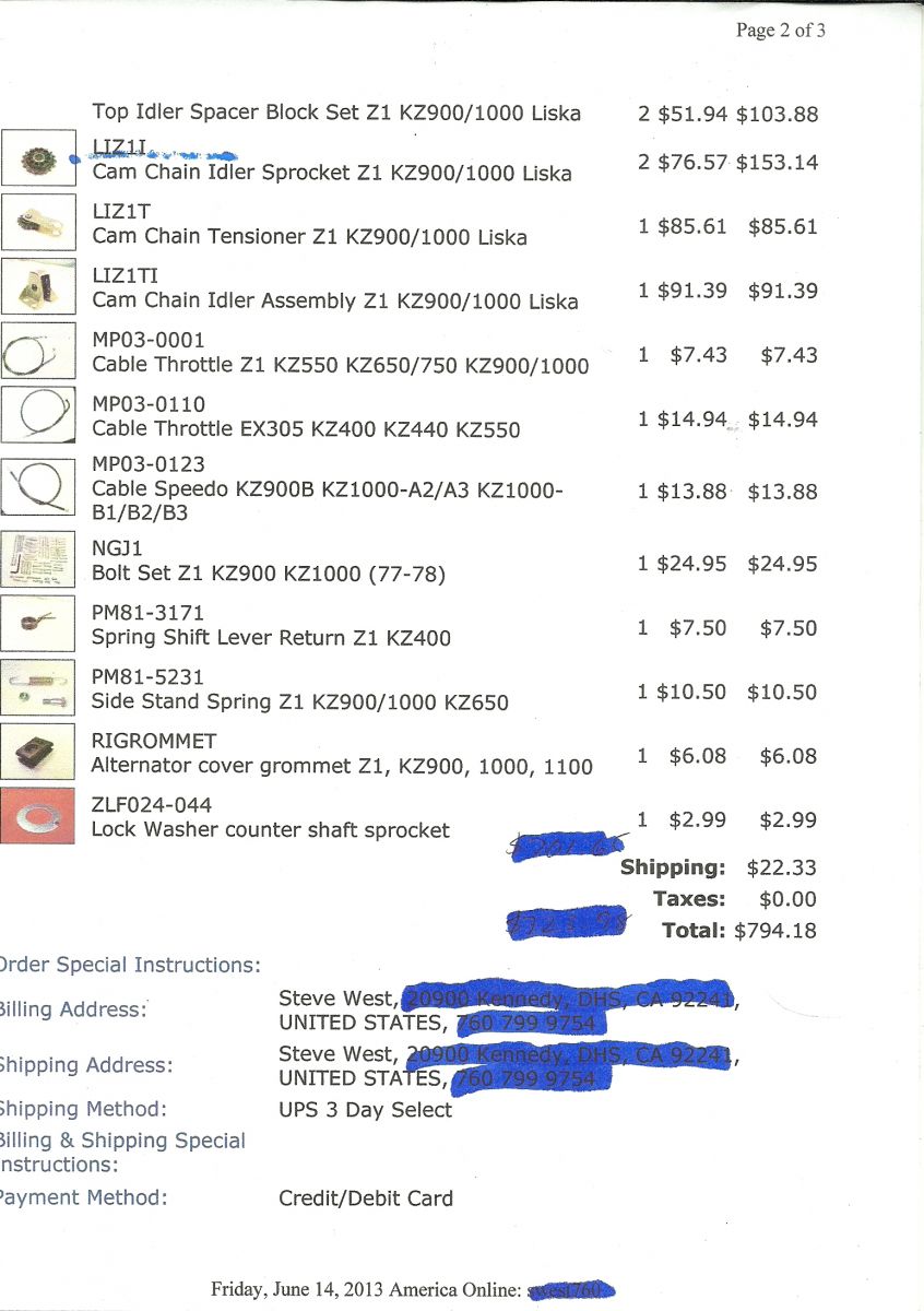

I didn't get the springs and was talked out of the copper head gasket. Then I found I had to buy pistons. Another $500.
