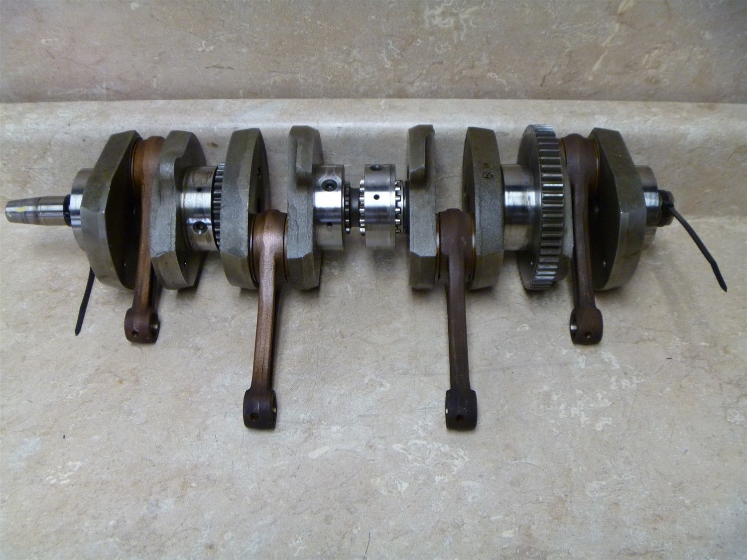

Well it looks like I won't get my crank welded. Jeff looked at it and without a straight tip for his Mig he won't be able to get into the center pin. He suggested I ask about how it's done and what's involved. He speculated it is taken apart and welded in parts. After Googling it it seems it will need to be trued and balanced as well. My 750 crank was welded by V/H but I wasn't told how it was done. I found this in our archives and a few members are still here. Some advice would be appreciated.

Never heard of any welders taking it apart to weld it. My 1000 crank was done by a local welding shop in 1979 and then when the turbo build was done Falicon took it apart and redid the whole thing as part of the Ultra Lite Super Crank process
Find a good welder or send it to APE, Pitstop, Pearson ,or Falicon

the general consensus is that unless you are going big/sticky tire and doing hard holes shot you won't need the crank welded even with the 1075 kit.
