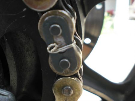

Lucky you noticed the master link could a made for a bad day ....... I ran one for years but this time I had my local repair shop peen the master link on for me just in case...... was a pain removing the swing arm but not really that bad......1105 that gets me excited just thinking about it.

These bikes have a cage around the counter-shaft sprocket. I put the little cover back on after all these years. I'll bet that's what kept it together at speed. I noticed a clunking and knew right off what it was as I was stopping :pinch: . I had a chain roll out the back years ago. If it wrapes up in the rear wheel, it could be deadly. Like the boy scouts say, "be prepared."

What's to keep it from wearing off?

the simple fact that it is wearing on "nothing".
google safety wire master link,it's been done to good effect for years on many different bikes.

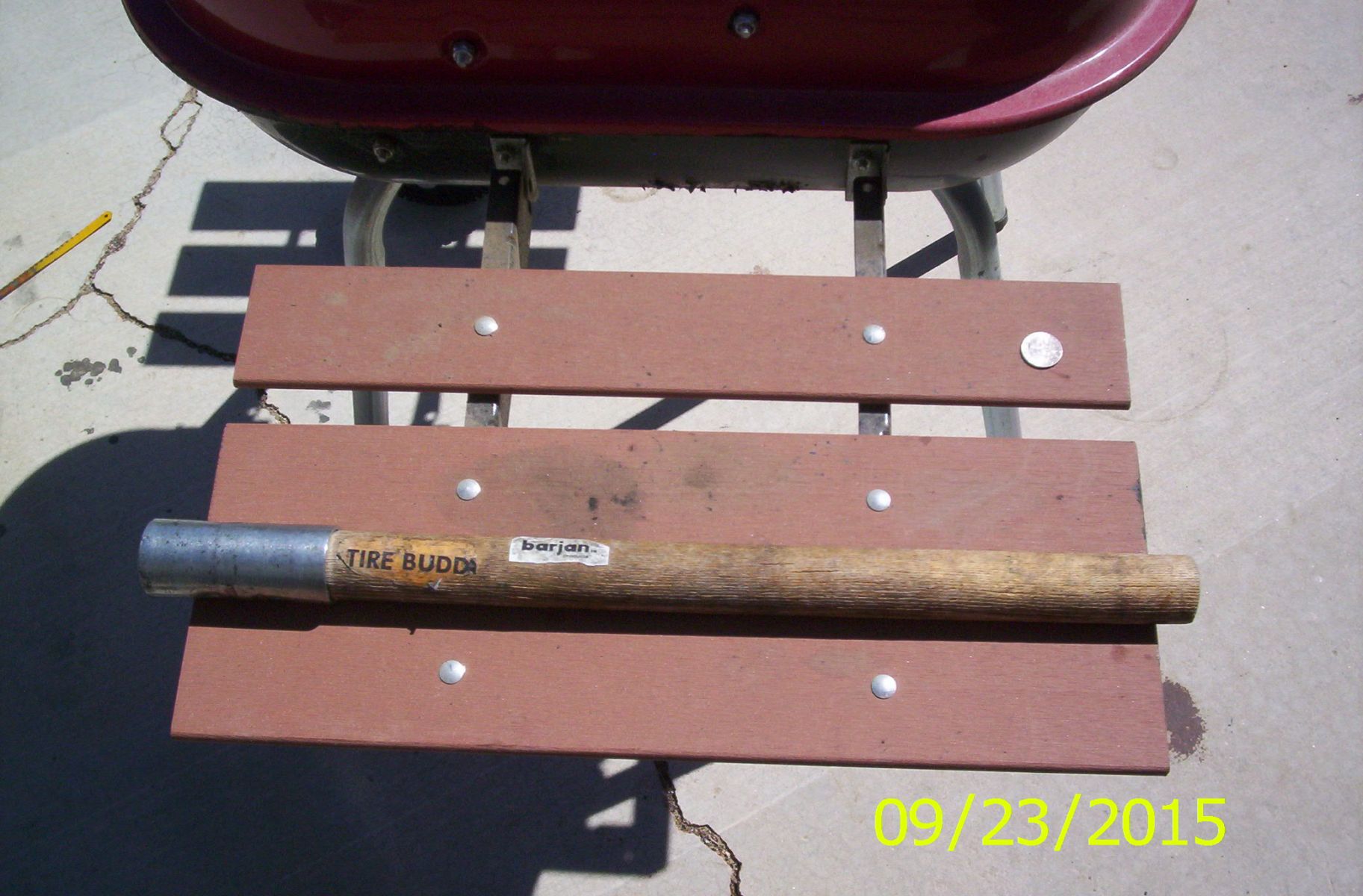

I have a tire buddy in my side box.
A few well placed shots will make for some flake's F'd up day. :evil:
Can we say broken wrists and a nasty gash over the eyes? :whistle:
