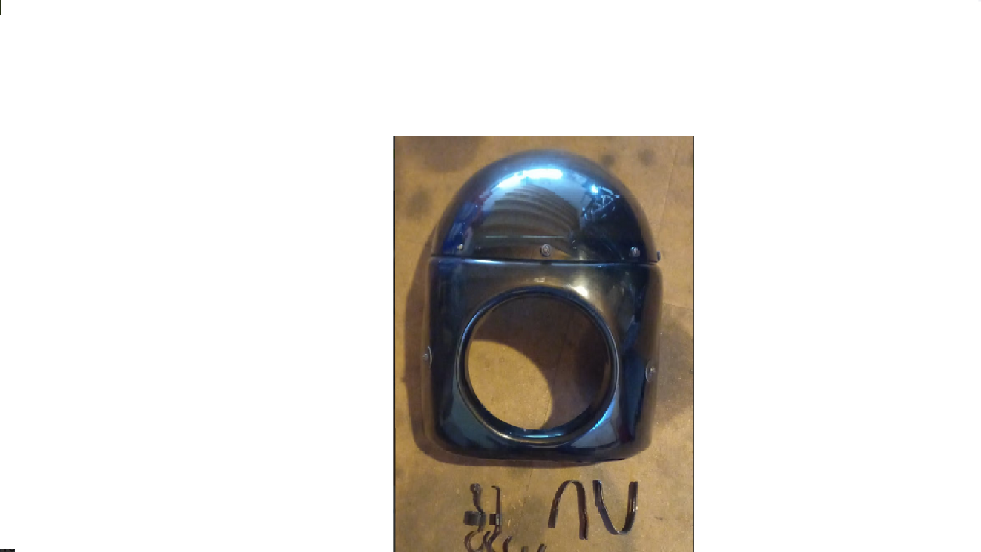

HA !!!....got this viper fairing today, bought it second hand + used from a fine guy who have send it to me, i will it mount on my A2 next weeks,...like this "Stone-Bike-Style" with bikini-fairings on a "Z"...
have had an little similar BMW R90S -Cockpit-fairing for about 10 years on my Z1B...
I will show the result here, when it´s ready mounted.
Greetings, Joe

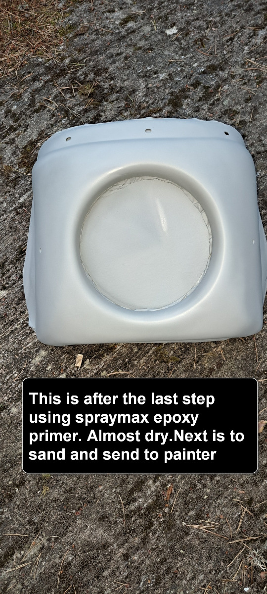

im also a fan i bought one from a dealer here in Norway after i found pictures of a bike for sale here i Norway that looks real nice.I post a pick of that bike here . i have also bough a gulliari seat ,but will have to replace the seatcover.
The viper cowling i recieved was not top quality it had lots of dents in the gelcoat/plastic so i had to do some work on it.Also the screen was hased on one side so i will try to polish that clear again.I first sanded the plastic with coarse paper and a sandingblock then used finer and finer grit paper. Then primed it with plastic primer and then grey primer for plastic. The plan was to paint it the kz900 diamond green myself ,but after a lot of testing mixing paints i can not match the paint so is going to send it to a painter that has painted many kawas kz900 in diamond green
The plan is to make the bike look like the one in the last picture ,but will have to buy a lower handlebar too i think.
This mod is easy and fast to restore back to original look too

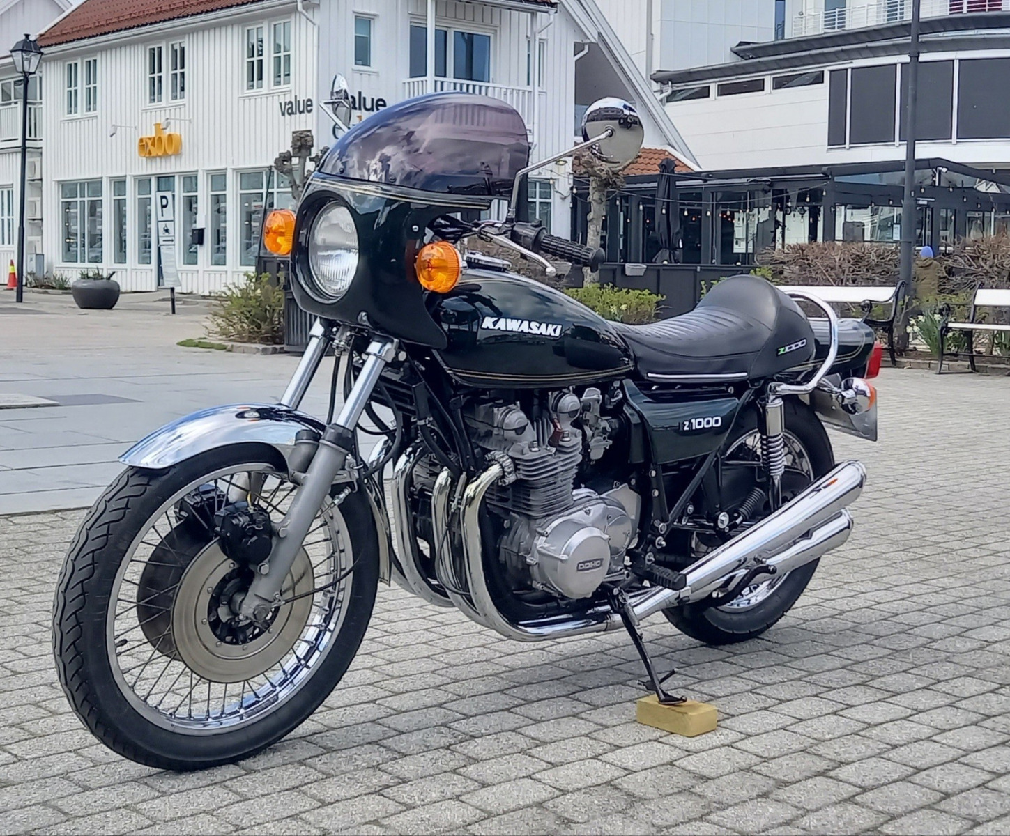

Joe I just read your introduction post and saw your bike It look great.Im 57 so my back starting to get tired leaning forward . This summer i almost forgot that
when i found a Very cool bike a laverda rgs1000 that was modified. Im glad it was sold before i bought it i think it vould make backpain worse haha.
When i look at your bike now im thinking.... just fast ..maybe you can just switch the side of the headlightears and mount them upside down to get the headlight lower?
my kawa is in a winter storage place now so i can not go and check.Here is a pick of the laverda that i was glad i did not ending up buying to expensive too anyway.
