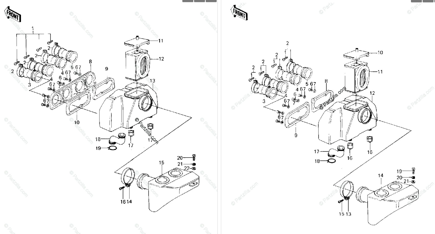

According to the application list at Partzilla, the main body was used on the 1977-80 KZ1000A, B(LTD), C (copcycle), and D (ZR-1).
www.partzilla.com/product/kawasaki/11011...4ac564f0f39b1592a35c
After a brief investigation, the only difference I can see in all those models is that the Z1R used a different bracket on the carburetor side, otherwise all the parts seem to be the same.

02 Dec 2023 10:04According to the application list at Partzilla, the main body was used on the 1977-80 KZ1000A, B(LTD), C (copcycle), and D (ZR-1).
The diagrams are very confusing, and mix the years together. As far as I can tell, there are three different versions.
1) Maybe 77, the airbox has a separate flat cover over the area where ducts fit into the airbox
2) Maybe 78, the airbox is a single piece, and the ducts just push in
3) 79 and 80, there is an extra port in the top center to feed the clean air system tube
Oddly, the Parzilla diagrams show the same part number (11011-1025) for the '77 A1 and '78 D1, but the diagrams look different.
I don't have any idea which version came with which model or year, other than it's a good bet that the one with extra port came with any bike with a MKII engine and the clean air system...
Here are examples of each....

Re: 78 kz1000a airbox
02 Dec 2023 10:18
I was going to say that I think any of the three will likely fit any 77-80 KZ1000.
Also, it seems to be the case that Kawasaki has in many cases deleted old part numbers from their diagrams and catalog if there was a new part number that superseded the old one, and was completely compatible.
I have several vintage NOS part, with the original part number sticker, where those part numbers do not exist in any parts diagram I can find. The old Kawasaki diagram system from 10-15 years ago used to show ALL the parts, and would show which parts were superseded by other parts. It was really great.
The point being that it could be that airbox 11011-1025 superseded an earlier part number, but is completely compatible with the old one, so Kawasaki just calls out the newer part for the older model. This may be why the '77 KZ1000 shows the old image, but lists the same part number as the '78 diagrams.
02 Dec 2023 11:08
I do not know if this will be of any help or not. From the Kawasaki web site it is indicated different part nuimbers for the air box between the A1 and A2 model years. 11011-065 for the A1 and 11011-1006 for the A2. and the B1 and B2 are shown as 11011-1025. A 1978 D1 parts list I pulled down from somewhere on line lists the part as 11011-1025.
Whatever differences or lack there of between the different part numbers I have no idea.
02 Dec 2023 11:40From the Kawasaki web site it is indicated different part numbers for the air box between the A1 and A2 model years. 11011-065 for the A1 and 11011-1006 for the A2. and the B1 and B2 are shown as 11011-1025. A 1978 D1 parts list I pulled down from somewhere on line lists the part as 11011-1025.
I pulled out the Z1R D1 fiche. It's dated November 1st, 1977. It shows 11011-1006 as the airbox part number, and the image does not show the extra plastic plate. I also looked on Kawaski.com and the D1 diagram matches Partzilla. Both show 11011-1025. I wish that old parts system was still available.
02 Dec 2023 11:57 - 02 Dec 2023 12:01
Here’s what I can add. ALL Kz900 are the same (11011-054). The Kz1000A1 is very similar and uses the inlet holder plate (11040-001), same as the Kz900’s but is part number (11011-065). See the two side by side. KN sticker on the 1000A1. Unfortunately there is no part numbers on either. Notice the flutes on the forward side, and the knotch center top on the 1000. Unfortunately I don’t have a 1978 A2 parts catalog to verify the ‘77 and ‘78 are the same. Also the silencer snout of the 1000 is shorter.
