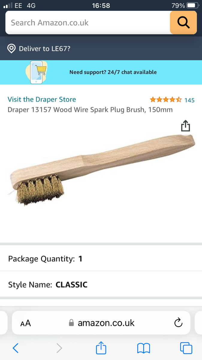

A regular wire brush can leave deposits that cause the plugs to short - there are brass wire brushes specifically for this
