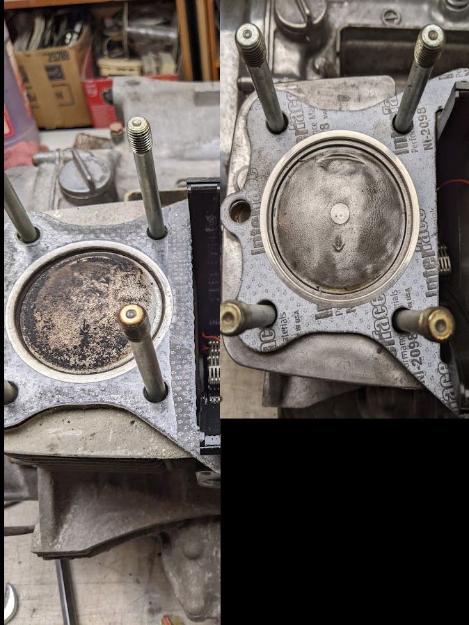

I ran a similarly oversized head gasket on my 750 and it was fine, although when I tore the engine down there was buildup in the gap left. That was after about 10,000 miles I think, so not sure about potential issues beyond that.

That looks like it would be quite an overbore. Won't that lower compression?

Theoretically it will lower the compression a bit but I took compression readings both before and after the rebuild. It didn't didn't seem to make any noticable difference, even tho the cylinders were lightly honed and the rings have not yet seated in.

20 Apr 2022 16:49The new head gasket diameter looks like made for an big bore piston set other than the old gasket!
Good catch, it was the only gasket my supplier could get. It won't affect the performance much as the bike is just a cruiser.
Are you sure you have a 440? What is the number cast in the block near the cam chain tensioner?

The engine pictured is a 440, casting says 443. I also have a 400 with a casting marking 398.
