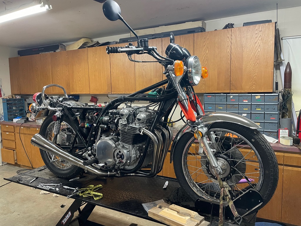

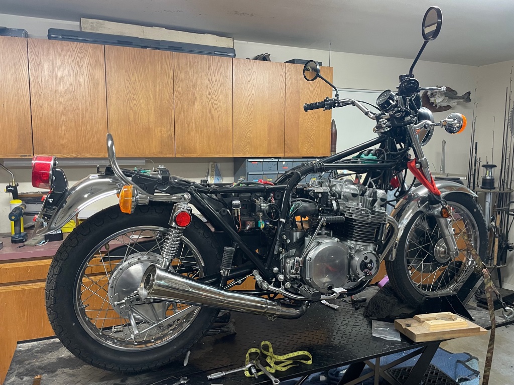

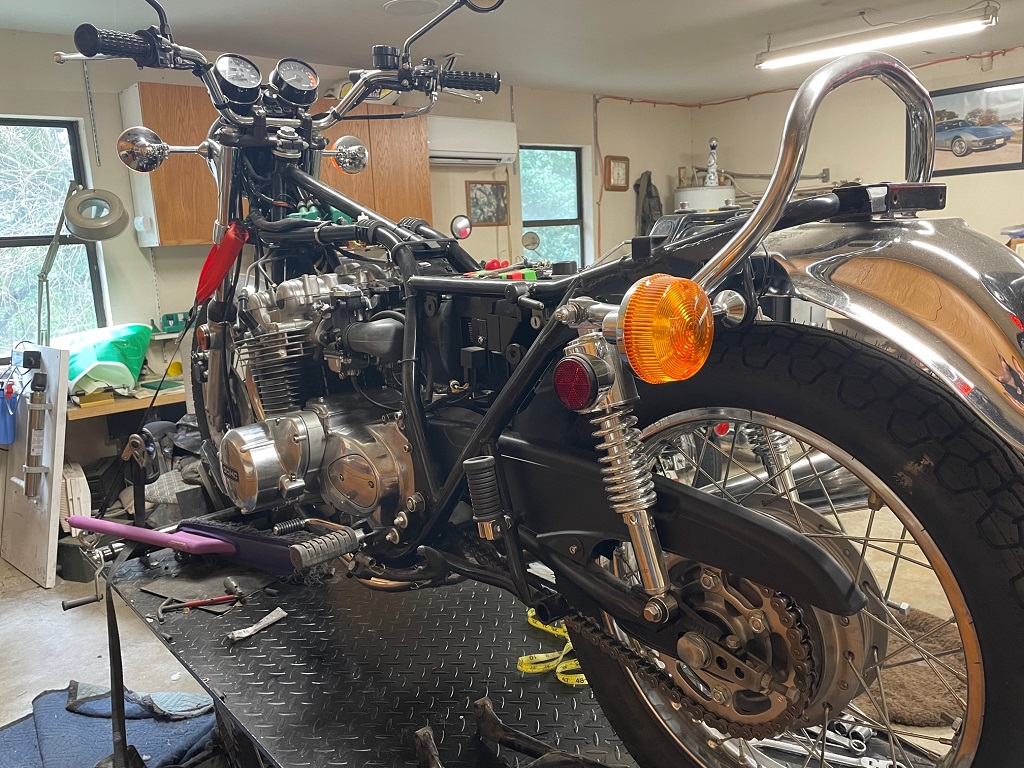

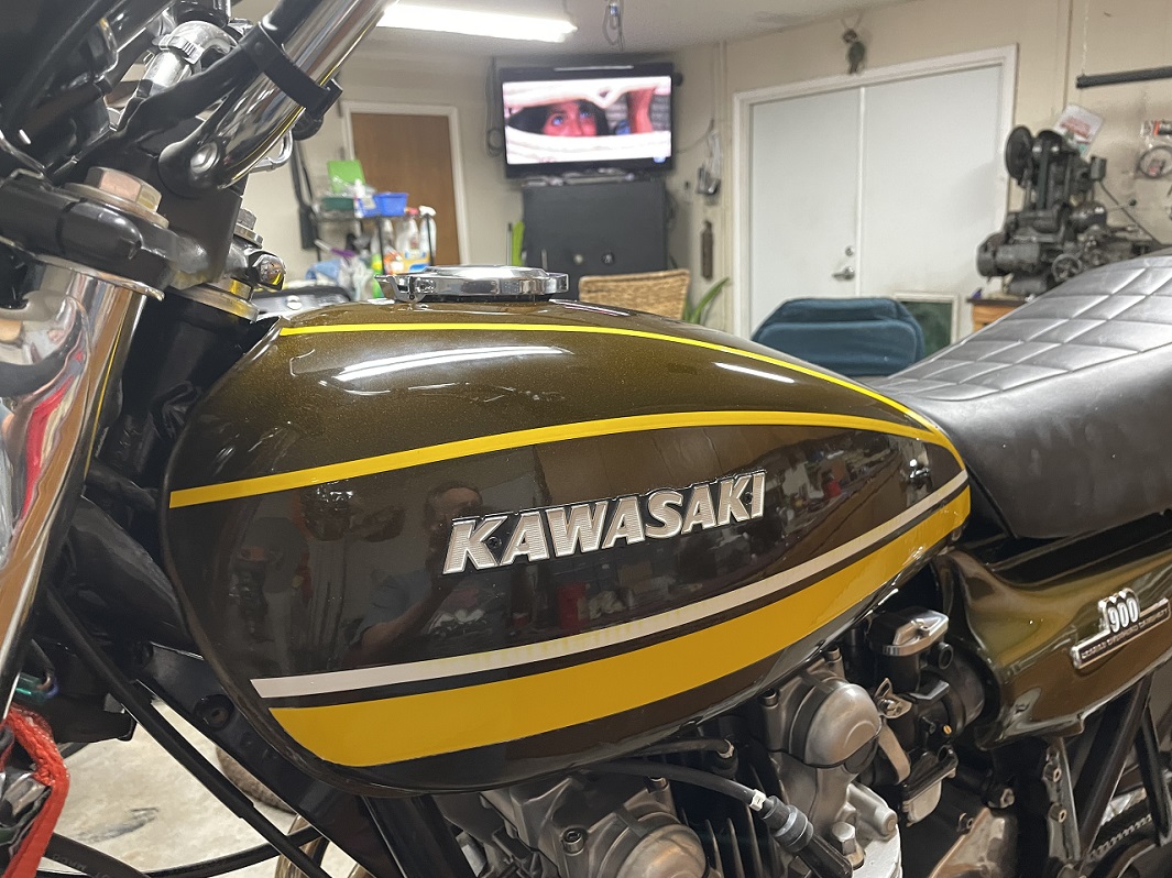

In the back of my garage I have had a Z1 engine sitting on a engine stand for about 25 years now. one day I got to looking at it to see what it would take to get it running. The top end needed to be completely reworked. Two new valves, valve guides, new pistons and rings. The bottom end gears and shifter forks was in good condition. I did replace oil seals and bearings while I was in it. I needed other tings like friction plates, Ignition system, carbs and a couple of side covers. After the engine was said and done with I thought it would be cool to find a frame! (Can you guys see where this is going?) One and a half  years later I'm thinking I should of had someone around to kick my BUTT for starting this project. I have had to buy every nut , bolt and components to build this thing, including spokes. I'm on the down hill side of this project now. the only thing is paint work.  Until the wife gives me some more money, I'm Kind of in a holding pattern. It will look good next to my 73 Z1 and my ELR

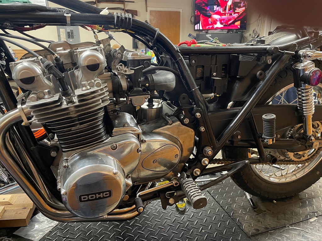

For starting with just an engine you're doing pretty good!  Are those carbs black?

The carb body's are black. It's a baked on coating that is impervious to petroleum based or chemicals.

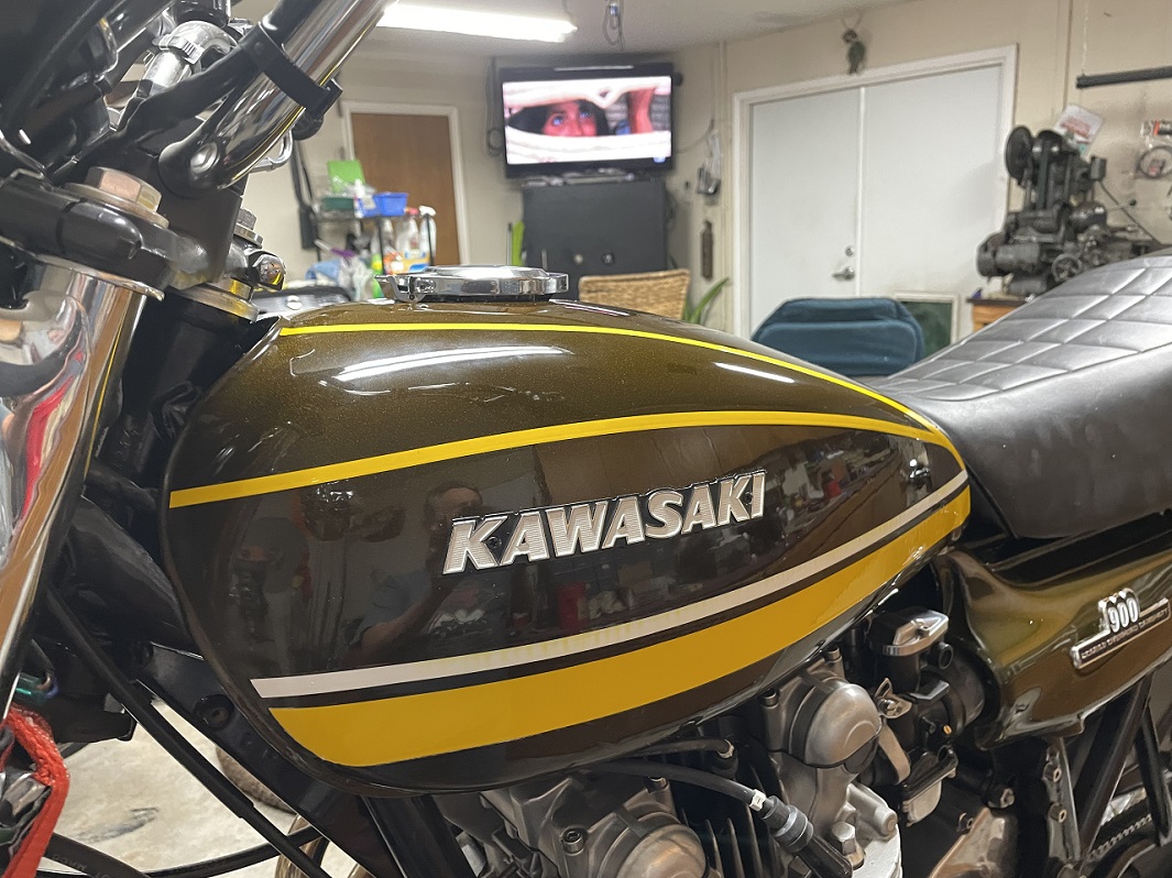

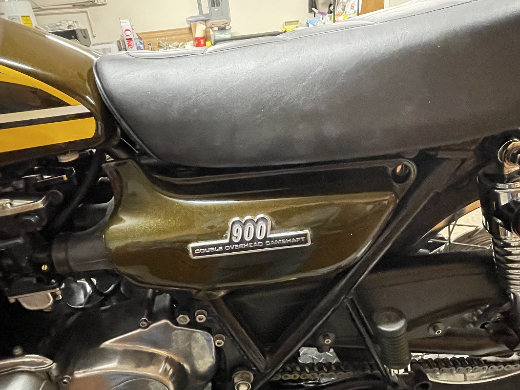

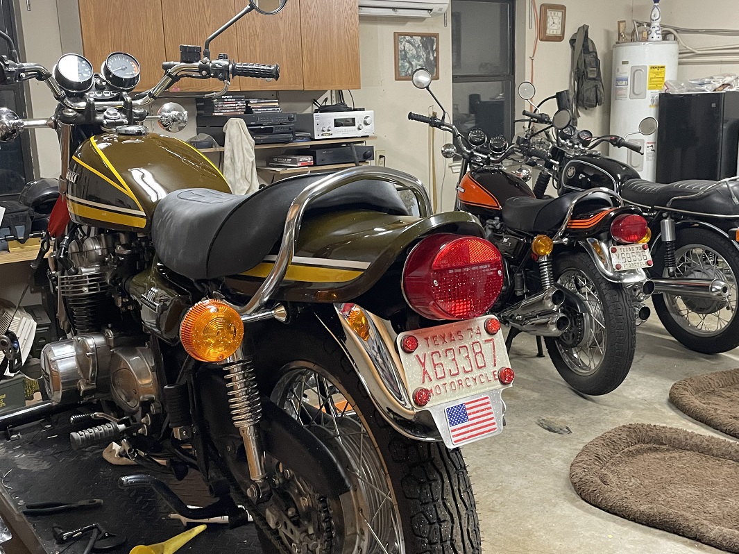

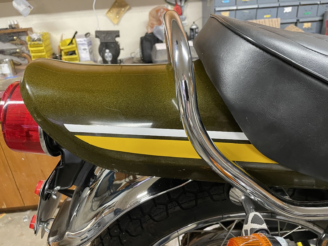

buff the paint and get rid of a gremlin or two then it's time to play!!

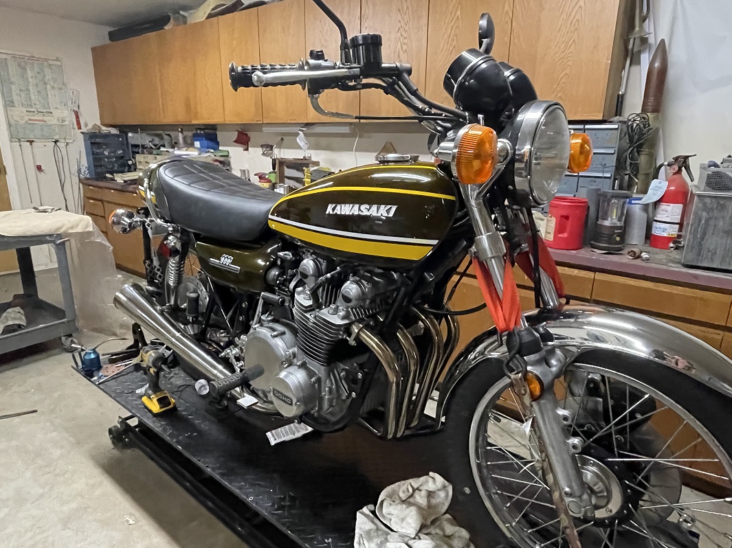

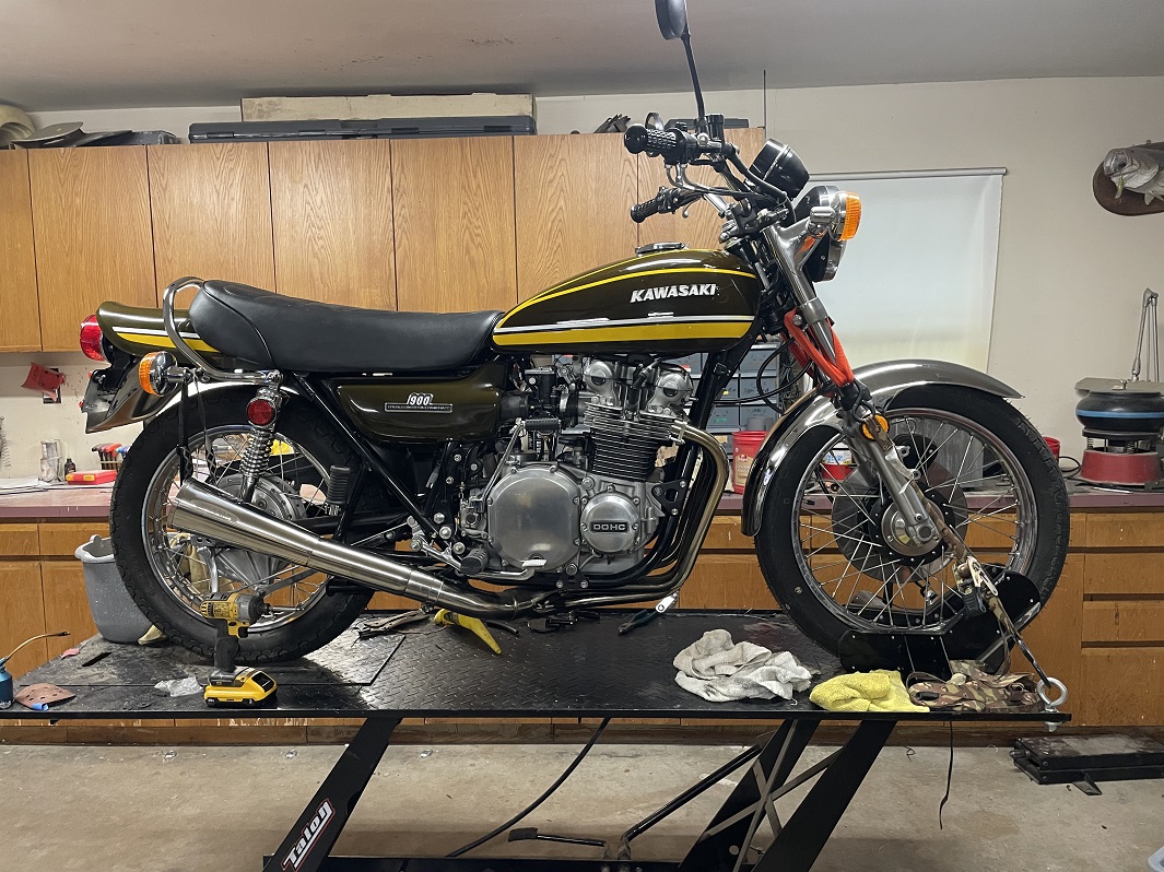

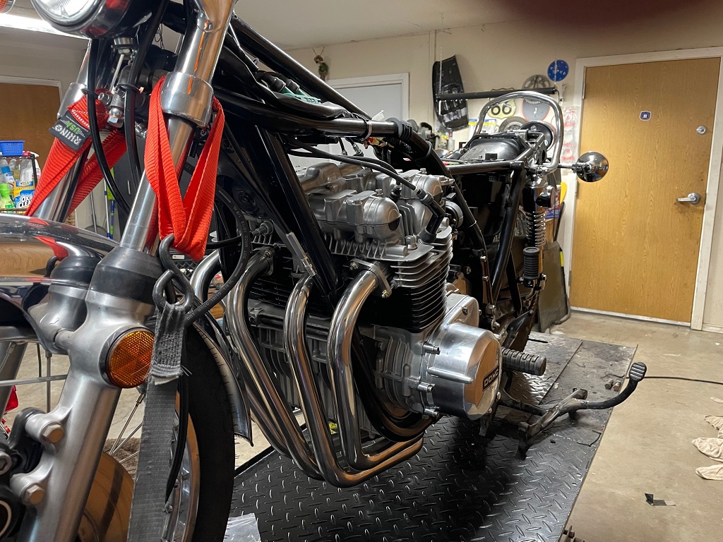

Nice work, she turned out great!  What type of exhaust / Header is that?
DELKEVIC
delkevic.com/complete-systems/kawasaki/1973-models/
  • hx35w
  • hx35w's Avatar Topic Author
  • Posts: 33
  • Thanks: 5
Re: 74 Z1A
15 Feb 2022 18:19
#862440
It is a Delkevic, polished stainless. great finish and center stand friendly. I will say when I initially installed it the bottom of the header was a lot closer to the ground than I liked. I fixed that problem by indexing the muffler about 10 degrees CCW and fabricating my own mount and center stand stop. There mounting hardware is worthless. By making the modifications I was able to get 1 1/2 to 2" more ground clearance.
