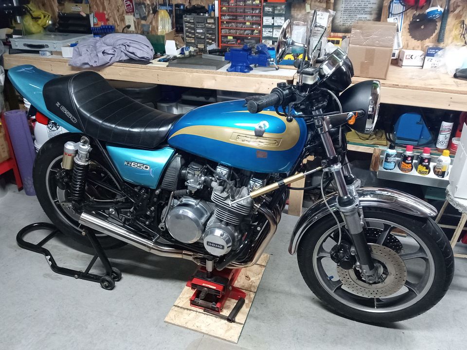

The steering damper is mounted to the frame using a Heim joint.
It's screwed in where the yellow reflector screws in.
Have taken a picture I will post shortly...

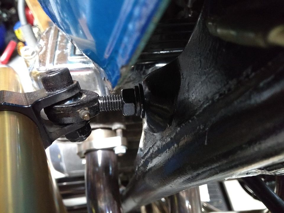

15 Apr 2021 08:04Hi Nick, would you have a pic of the steering damper mount you used on the frame, I'm just about to fit a damper to my sons 650 and are looking at mount solutions..

Thanks Nick, the damper I have has heim joints at both mounts, I'm interested in what you put between the frame and the mount on the damper, The hole in the frame puts the damper to close to the engine if not using something to bring the mount further out, does that make sense ?I was considering using a short piece of tube with a bolt welded in one end and a nut welded in the other....

Here's a picture of the Heim joint threaded directly into the frame where the reflector used to be.
There's a lock nut to keep the Heim joint in one spot.

Thanks for the pic Nick. The bracket that goes on my damper has the heim joint in it so i'll have to fashion up a small bracket between it and the frame...

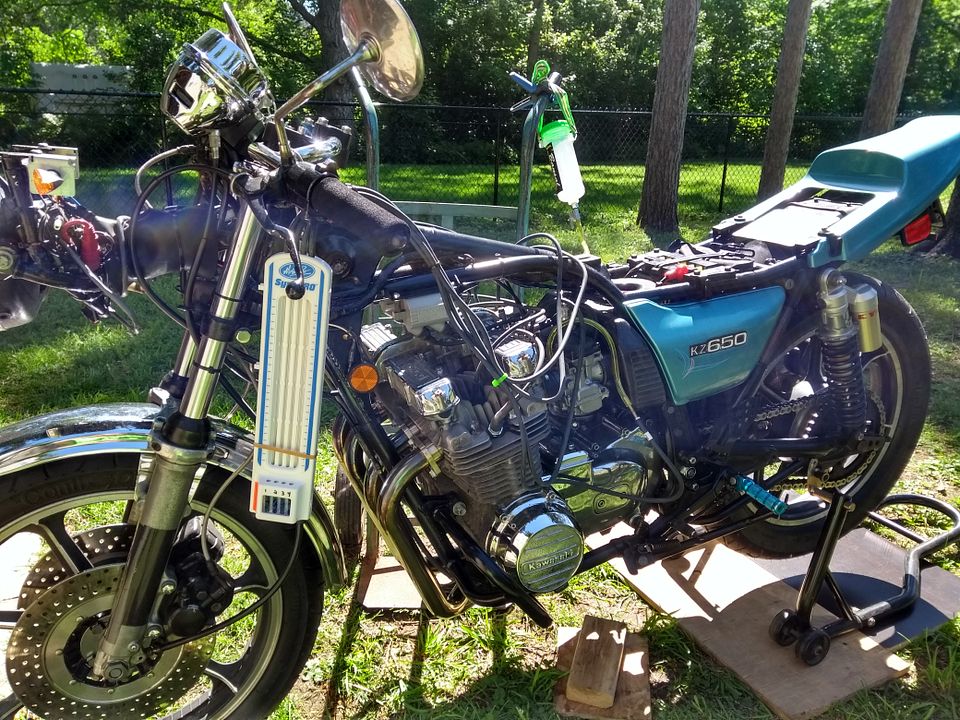

Yesterday I balanced the carbs, CVK32s.
They were all over the place on the synch tool to start, but some adjustments brought them all to the same level, balanced.
Took a test ride and she is running even better.

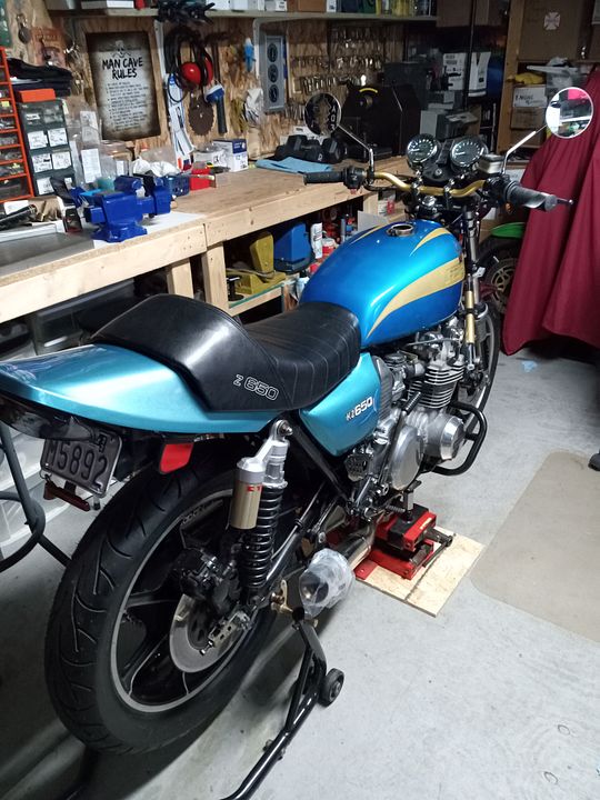

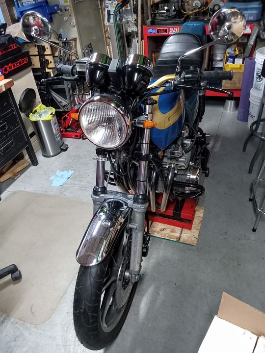

Does look like Pinocchio with the headlight way out front.
My painter buddy is not going to have the fairing and bodywork done come this Spring, so have decided to put regular handle bars on and move the headlight back to the original position.
I did find riding her last season was uncomfortable with the low Clubman style handle bars.
I will get this gas tank repaired and painted to match these side covers and tail.
