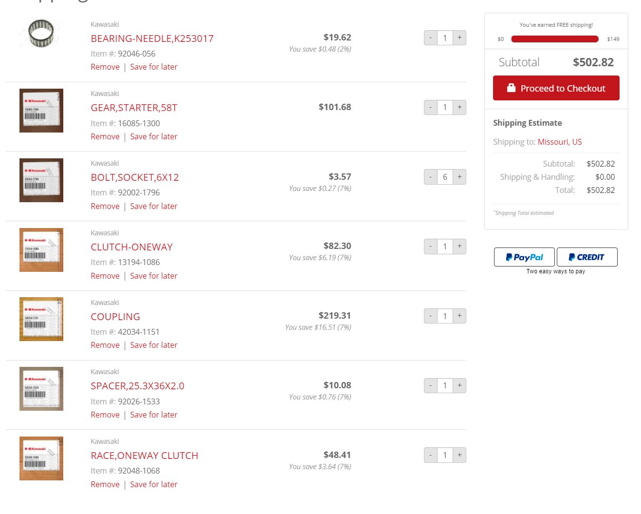

Decisions again. Once I decided NOT to touch starter clutch because it worked. And if replacing - whole thing needed. But doing it with motor on a bike will be PITA.
Decisions.. Should I just do it now and don't worry about it ever..
kzrider.com/forum/2-engine/607684-kz650-...n-zr7s-part?start=12
EDIT. Actually, seeing price I think it's OK as is

I think that’s where I got my list. I am just saying for $500 I am willing to deal with problem if it becomes a problem later. If it was like $200 I probably just do it now so I don’t have to do it later on a bike..

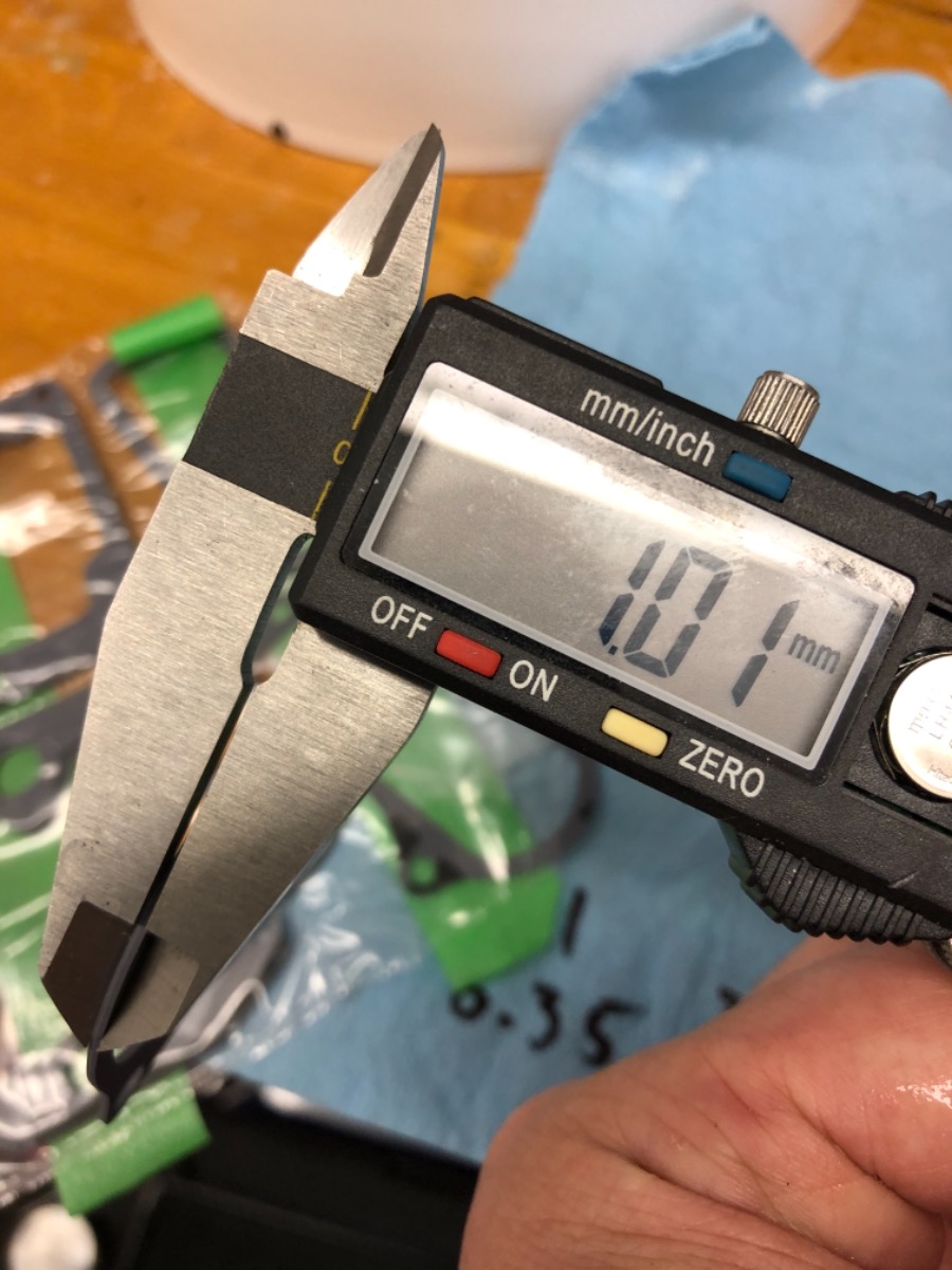

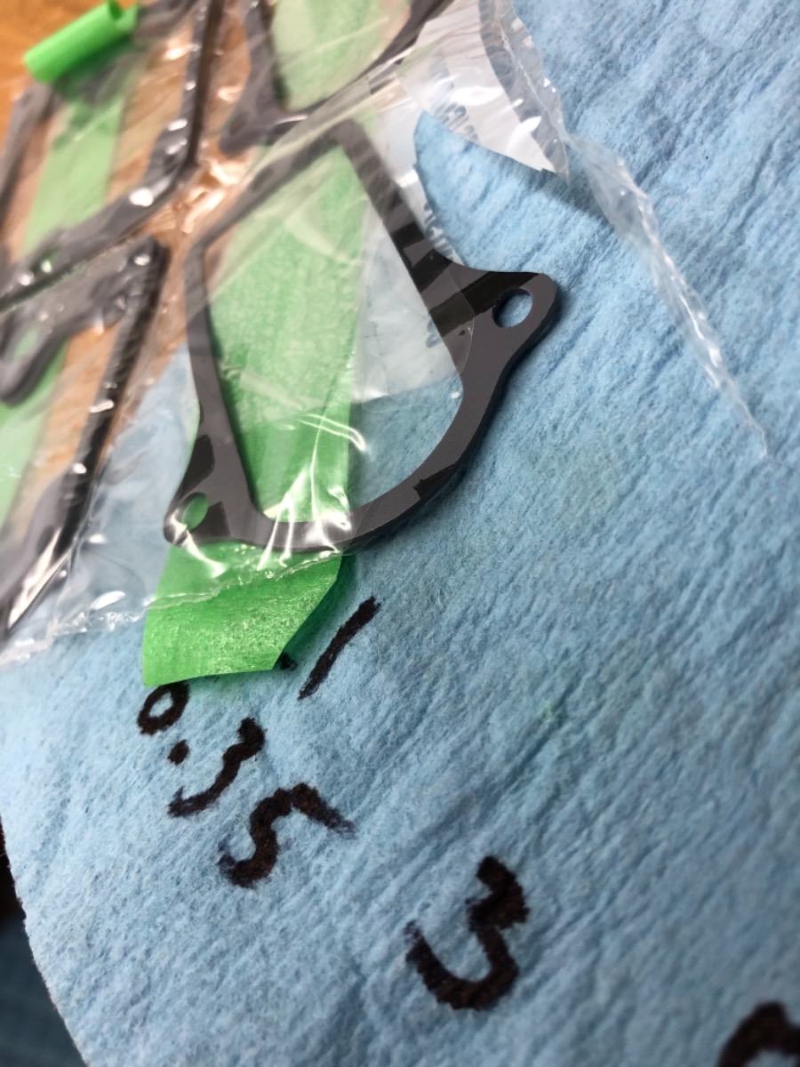

08 May 2021 10:51small update. Got those gaskets. Maybe they improved? 1mm thick, rubbery material. Feels good, looks like they will work
Regarding the carb gaskets, I recommend staying away from the hildebrandtgasketcompany gasket guy on ebay. Their gaskets are made from really thin material.

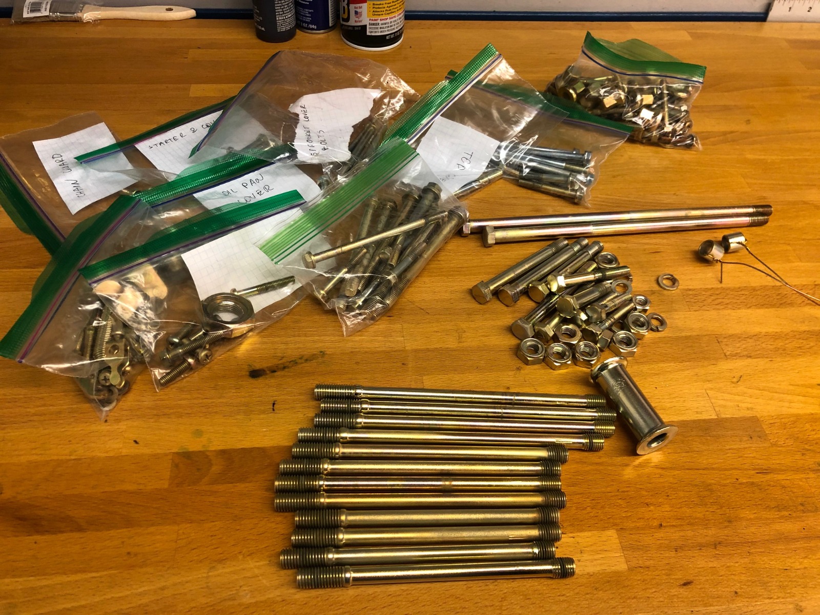

All hardware plated and ready (for engine). Just waiting for order from partzilla and engine can be assembled

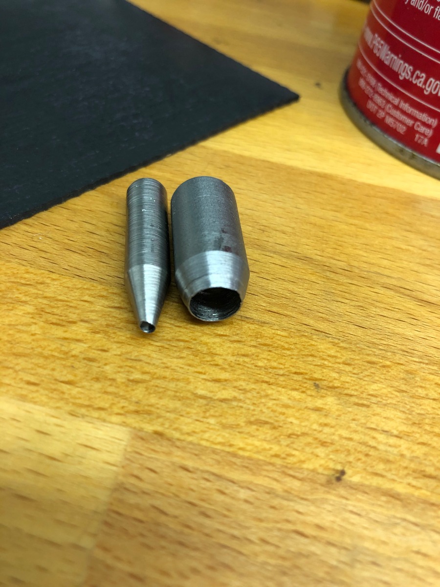

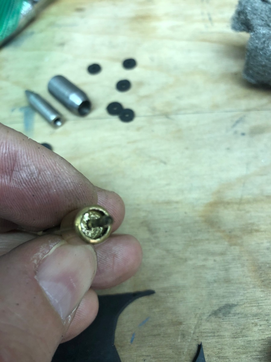

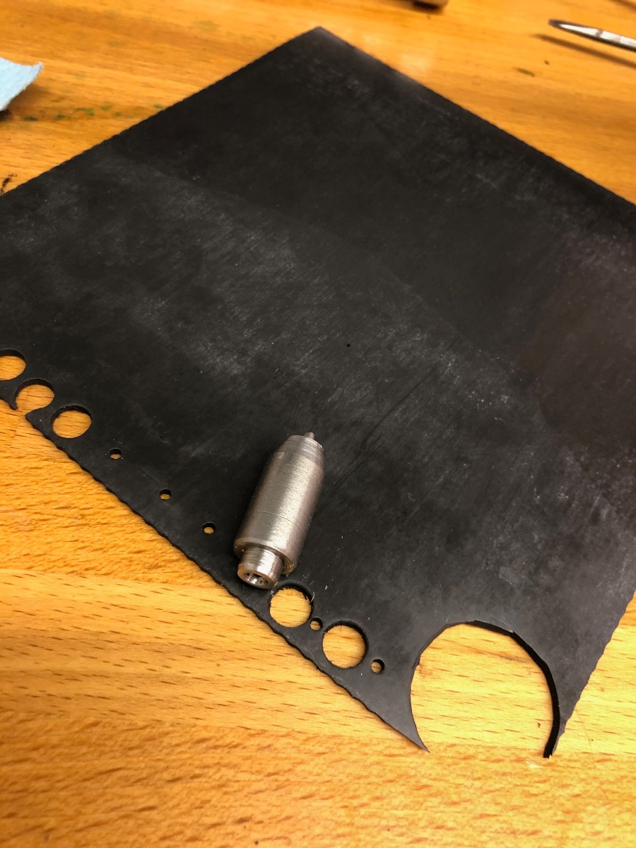

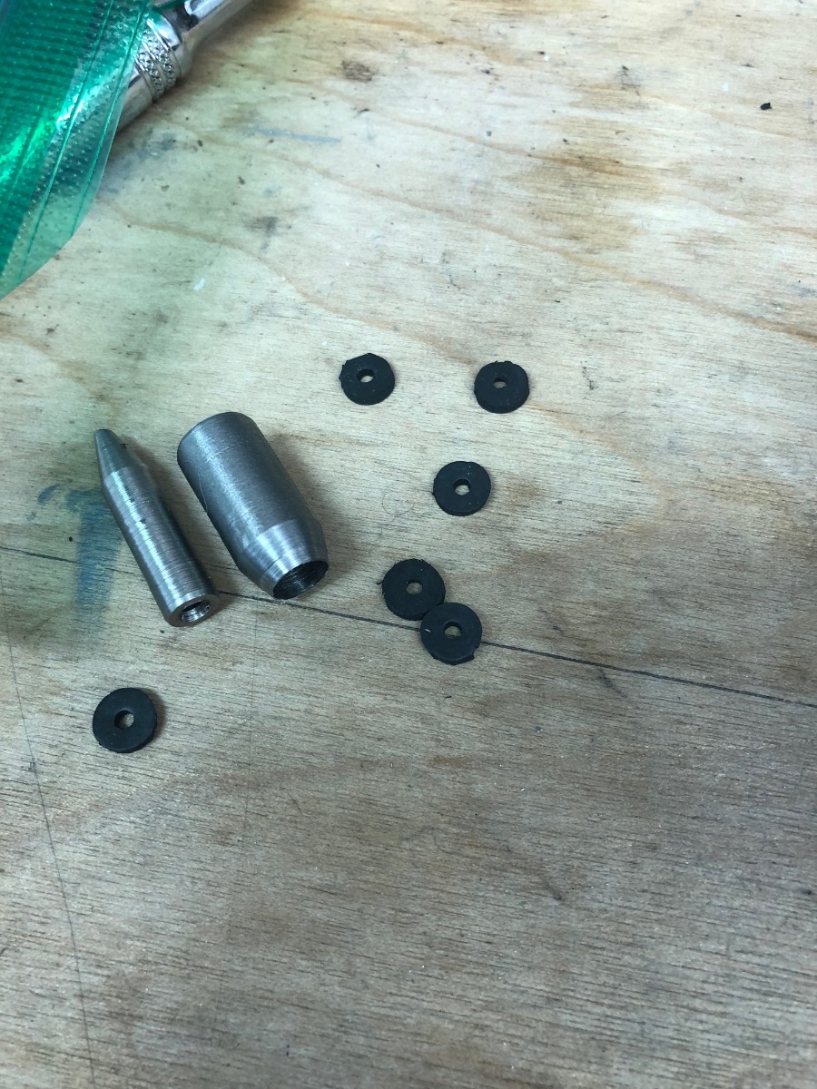

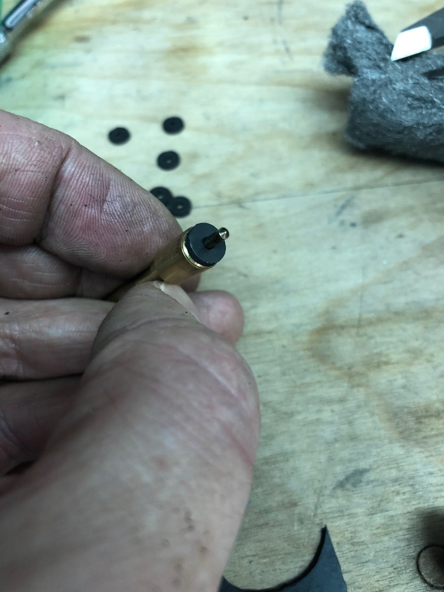

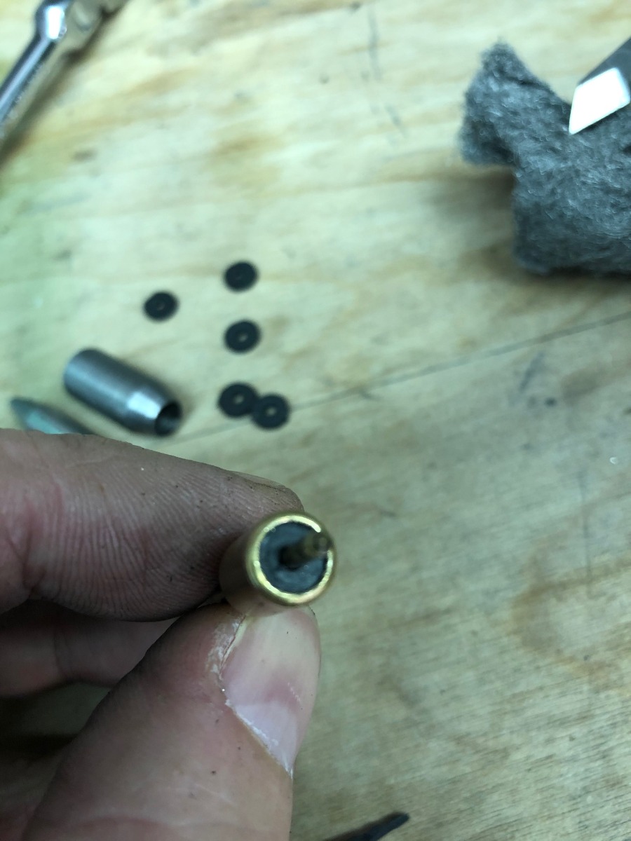

While waiting on order (takes forever) and shop (takes forever - probably going to take it elsewhere) - working or carbs.
Since I like to DIY as much as I can I figured why not try fix those choke plungers myself.
Took old rubber washer out, measured and ordered 6x6 piece of 75 viton from McMaster:
Viton Fluoroelastomer Rubber Sheet Chemical-Resistant, 6" x 6", 1/16" Thick 86075K22
Machined 2 piece tool to cut ID and OD. Making those washers is piece of cake.
Then I thought it will be PITA to insert washers back but no, just used small screwdriver and they went in easy. So, looks like it worked.

Sweet! What thickness is the rubber? And please explain your process. I see what looks like a punch tool but what about the smaller diameter tool?
PS: I've got a lathe in waiting your response.
Last edit: 13 May 2021 19:15 by Nessism.
- katit
- Posts: 460
- Thanks: 47
Re: Katit's 1978 KZ650 project
13 May 2021 19:53Link to McMaster piece I got in my post above. It's 1/16 but I think it's just tad thinner like 0.1mm than original I measured. This is what they had. Next size will be too big.
According to MY measurements it's 1.8mm thick, 6.8 outer diameter, 1.95mm hole.
For tools - I made 2 punch tools where inner goes into outer so I can punch outer first, rubber goes in and then I punch with inner making it perfectly centered.
I used drill bits I had on hand so size was slightly off but it went in tight, should work good IMO.
HINT: To remove old ones - I used torch and they just come out burning. First one (scratched on picture) was because I was trying to use pick. To put new ones in - just start with one side, put it under lip and work your way around.
