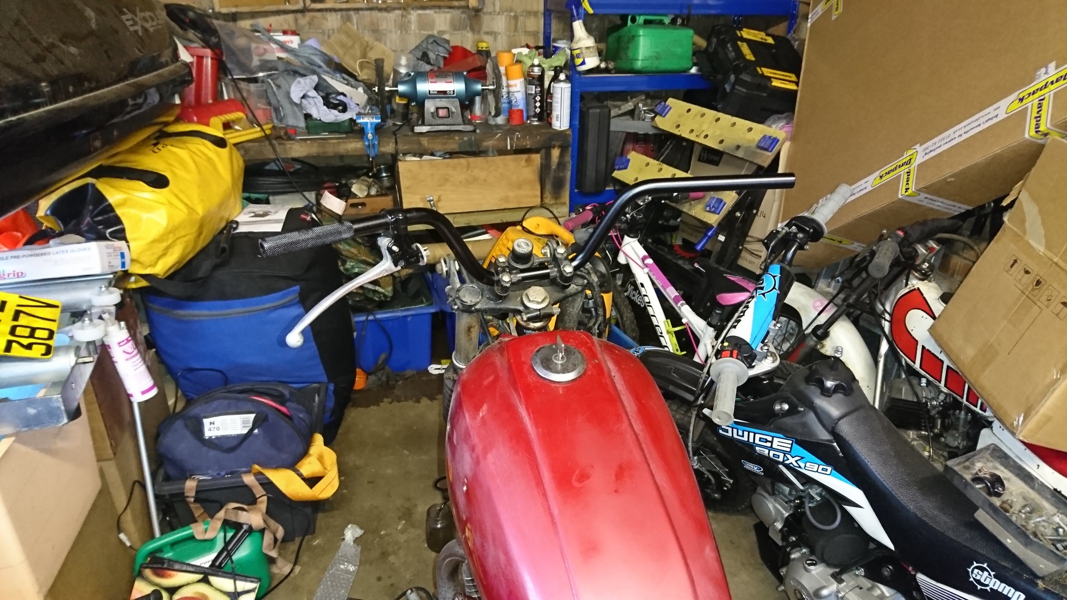

Found this cowering in the corner of my garage, so thought it was time to get it going after 21 years. I'm thinking of restyling it, maybe a flat tracker? I know some folk will see how original it looks and say keep it standard but I fancy "something different"

It looks like someone already made quite a few changes to it (paint, exhaust, forks, turn signals, shocks, etc.) so it's not really original any more. Given that, I would restyle it into something I liked better. Step 1 might be to make sure the engine runs ok. Ed

I'm working on step 1, The inlet rubbers and diaphragms were toast so have new ones, I will try and get it running tonight.

Well I got running, so that's a start!
Only had to charge the battery, fit new inlet rubbers, carb diaphragms, spark plugs and fresh fuel. Started straight away.

650ed wrote: It looks like someone already made quite a few changes to it (paint, exhaust, forks, turn signals, shocks, etc.) so it's not really original any more.
To me those look like stock forks with aftermarket rubber gaiters fitted.
And the purple ground wire under the seat is definitely not original. :)

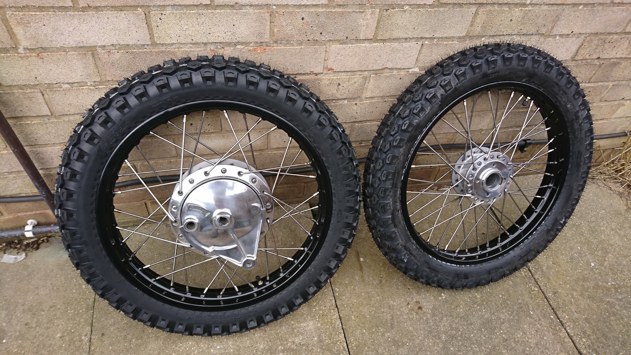

I've just dropped the wheel off to be rebuilt with stainless steel spokes, vapour-blasted hubs and rims power-coated in black. Should get them back in about three weeks.

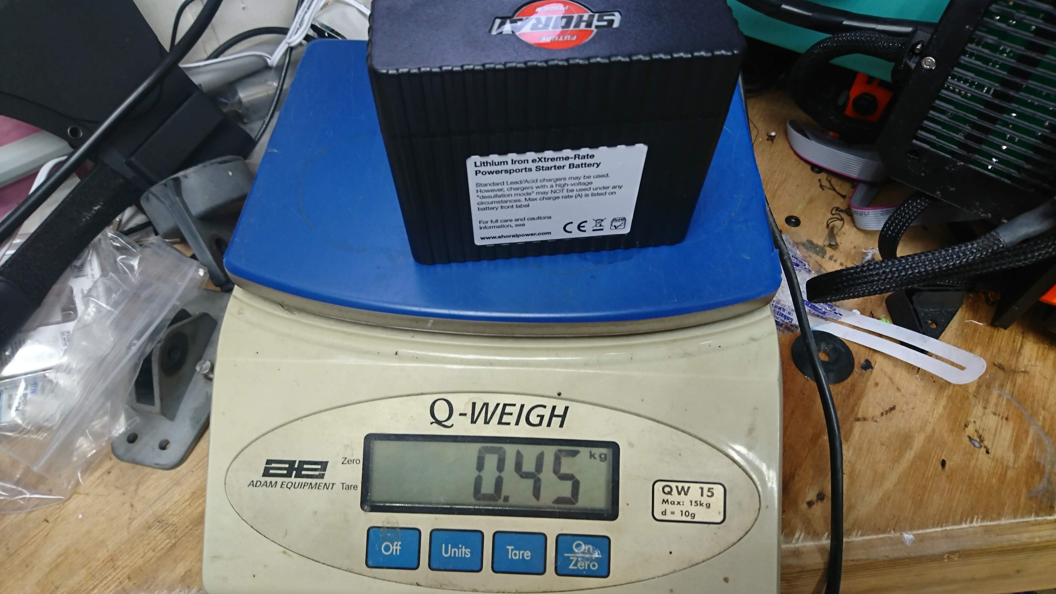

I want to do away with the air-box and battery mount, so looked for the smallest battery I could find. As the bike has a kick-start thought I don't need the battery to be able to turn the engine over, so I bought the smallest lithium-iron that Shorai do. It is tiny and weighs nothing!
I installed it on the bike and started it using the kick-starter to check it charged okay using a volt meter, all was good, then I tried the starter motor thinking the tiny battery would struggle to turn the engine over but cranked it over faster than the lead-acid battery did! [attachment=125796]

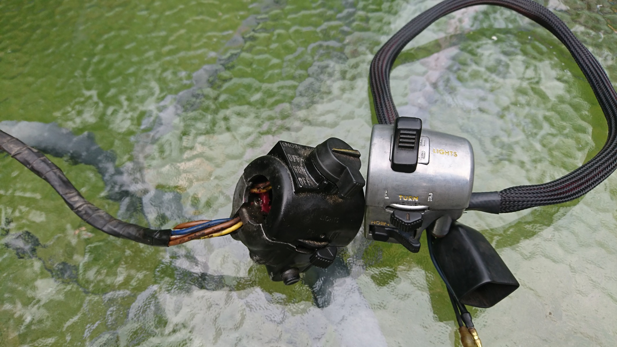

Still waiting on the wheels so I thought I would do a few little jobs on the bike. Wanted to make the switches look more "retro" so took them apart, cleaned the contacts, polished the housings and fitted braid instead of the plain black sleeve.

I have got the wheels back after having them refurbished, I think they look great.
