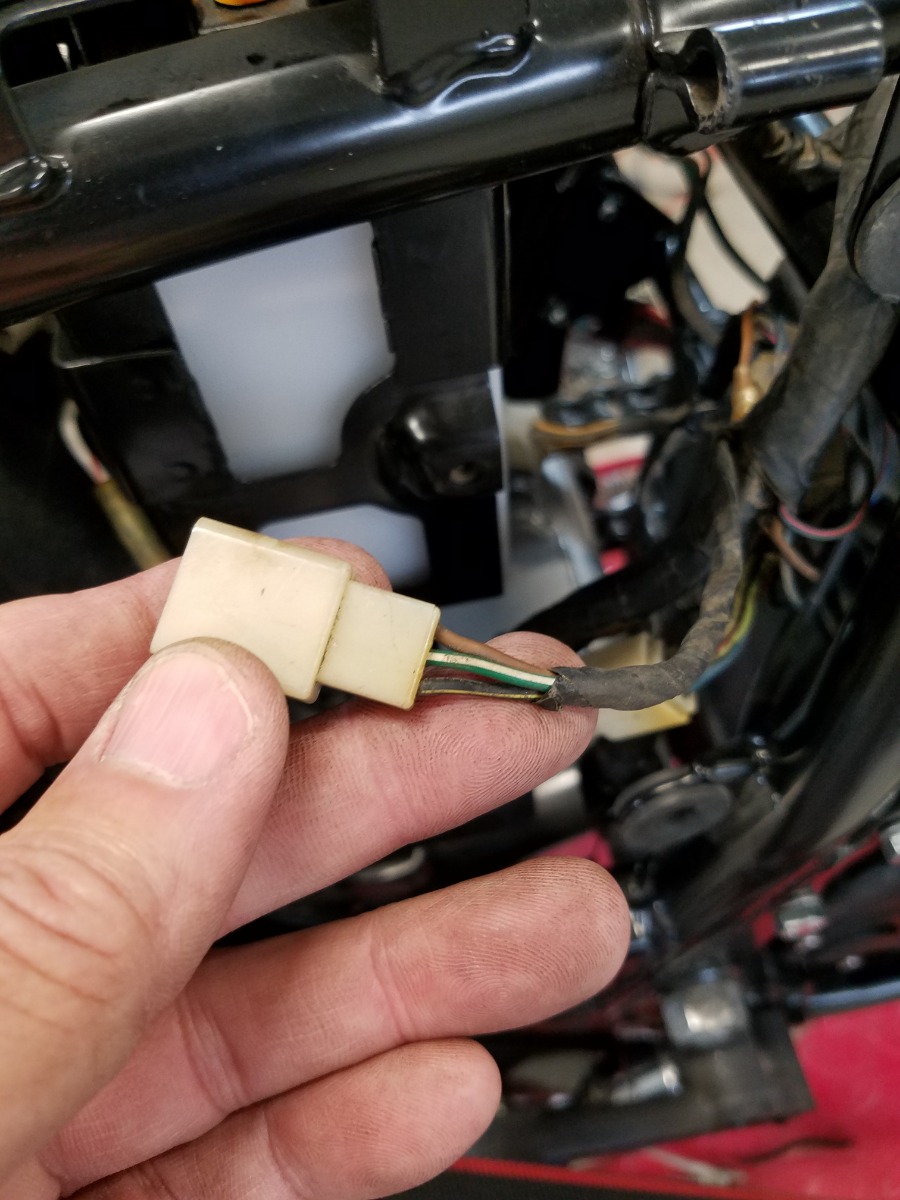

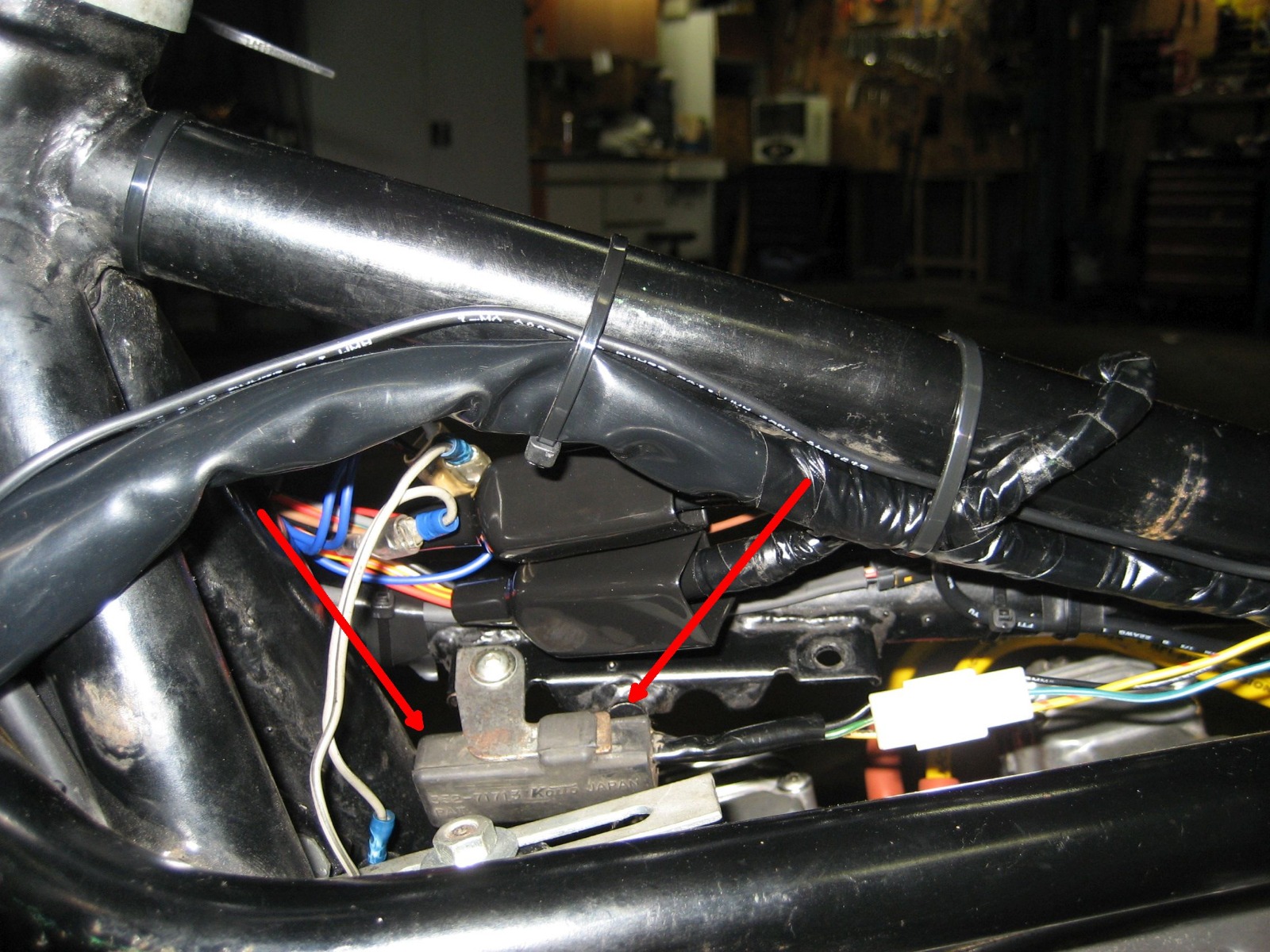

I found this connector, and the diagram lists it for a "warning light self checker". It is coming out of the rear loom on the right side near the battery. Is this for a factory diagnostic tool to plug into? I can't find anything that has the same shape connector on the bike.
Retired gearhead
'81 KZ-750 E2
Less
More
- Thank you received: 2260
30 Jul 2021 17:22 - 30 Jul 2021 17:27 #852878
by Scirocco
Replied by Scirocco on topic Saving a '81 KZ750-E
The warning light self checker connector need the same electronic divice like the rear break failure "idiot light"

I ended up finding my warning light self checker. I seem to spend the majority of my time looking for parts or fasteners to put this bike together. I was "okay" at bagging and tagging everything, or so I thought. Turns out I am only so-so at that task. Note taken for the next project!

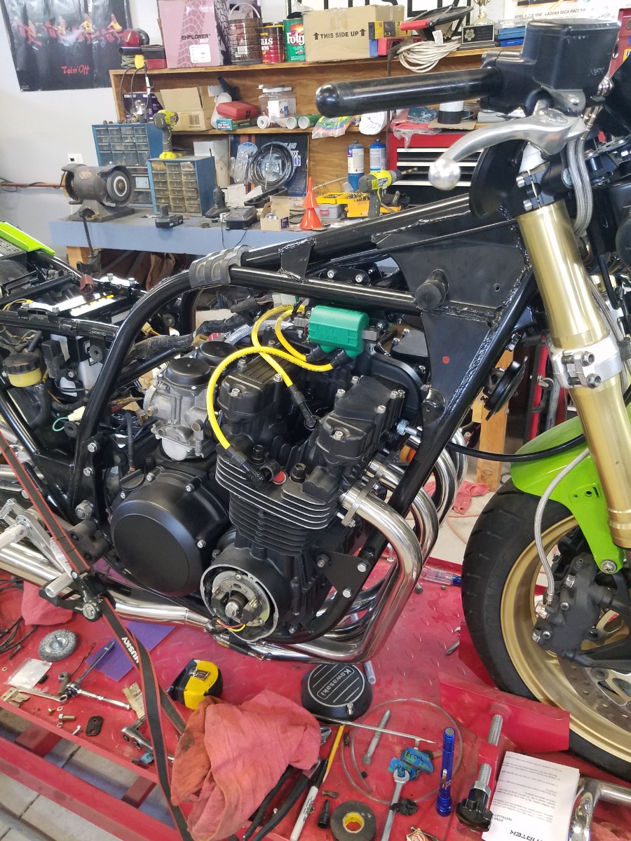

I received some of my spark plug wire parts. I am building my own wires. I got NGK resistor spark plug caps, and the coil ends. Hopefully my bulk wire will be here in a few days. I still need oil to put in the crankcase. Hopefully this thing wire fire up for the first time in the next week. Not drivable, but will be able to hear the motor for the first time. It' going to be a milestone moment on this project!

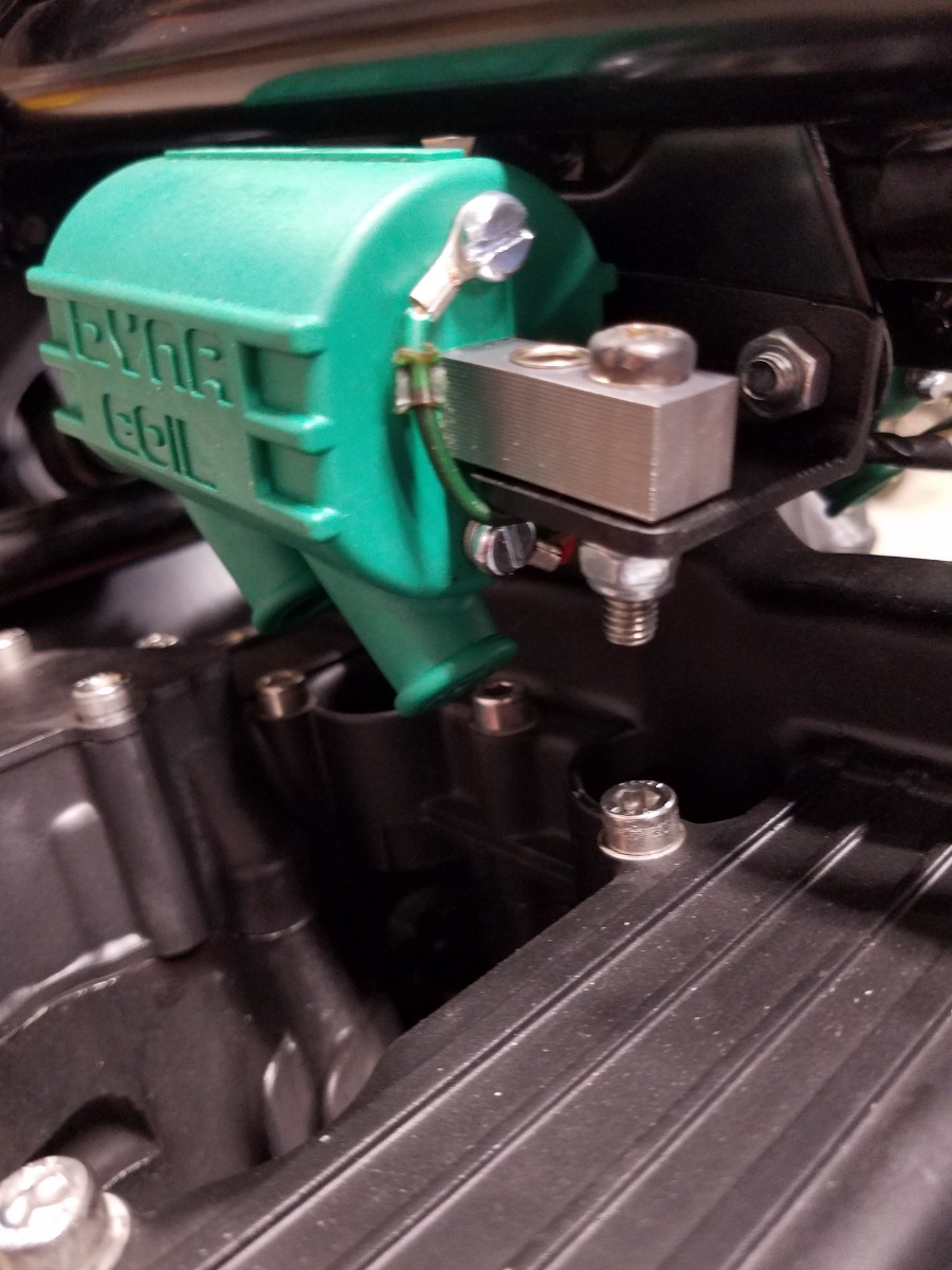

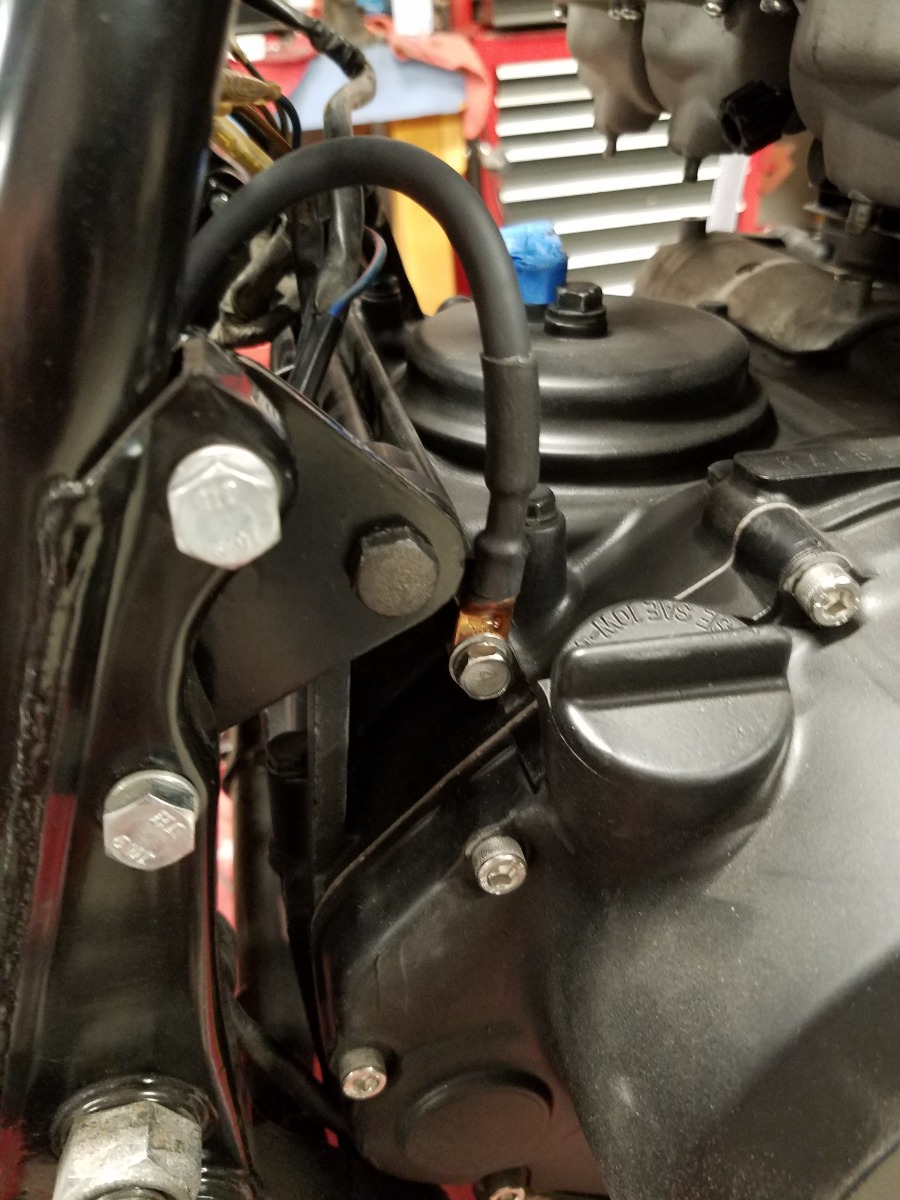

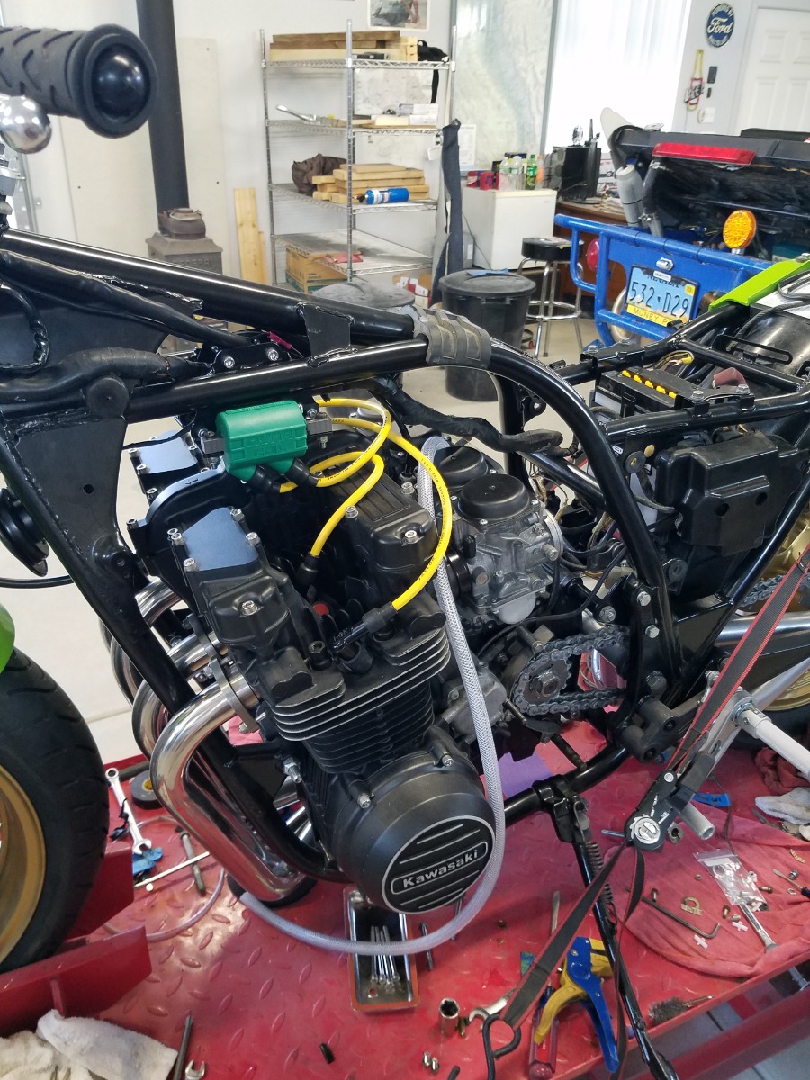

I made a new ground strap from the battery to the engine. One part I spent a lot of time searching for before I threw in the towel and made my own.

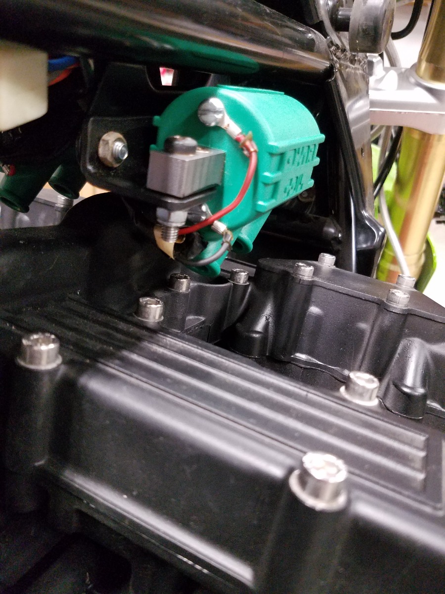

I also finished wiring up the ignition coils. Dynatek coils require a different connector than the stock.
The heat keeps me out of the shop in the afternoons. Doesn't seem like much progress, but got to keep pushing forward.

04 Aug 2021 13:20 #853155
by Skidmark
Retired gearhead
'81 KZ-750 E2
Replied by Skidmark on topic Saving a '81 KZ750-E
Retired gearhead
'81 KZ-750 E2
- gordone
Less
More
- Posts: 1533
- Thank you received: 93
04 Aug 2021 13:55 #853156
by gordone
Project:
Replied by gordone on topic Saving a '81 KZ750-E
nice work!
What wires and caps are you using?
