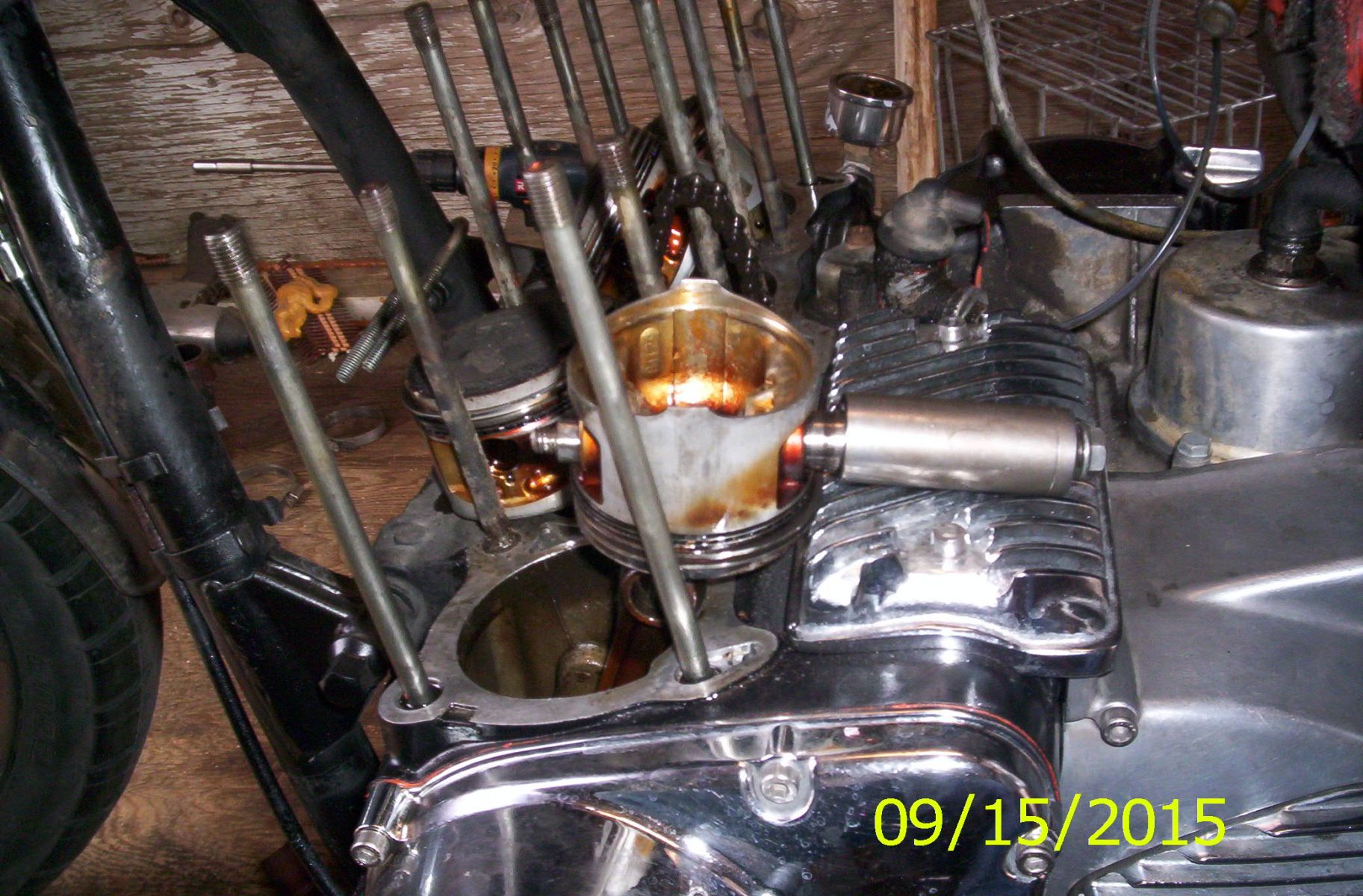

Hi all, so I have been fighting a noise in my engine that I have determined is my cam chain and guides being at the limit. So I puulled the head and cylinders for inspection and found the chain was indeed at the upper limit per the manual. This caused the noise because the tensioner was not able to take up the slack fully anymore. I considered replacing the guides and getting a manual tensioner but knew I would be merely putting off the inevitable. So,I figured I was so far in why not? Pull the engine, split the cases, inspect everything and reassemble. Last night I prepped the engine and tonight I removed it. Currently it is sitting on my cart with two of the side covers off. I willl now try to post some pictures. I will try to update as I go. Later, Keith

Steve, I am already happy that I am taking this step. I have done a lot of work to the bike but internals haven't been inspected prior to this. So, I have completed the disassembly down to the cases being split. Went very well. Better than I thought at least so far. The KZP is a different setup than the earlier models with the rollers. I was able to remove the side covers and leave everything intact as I took it apart. I mean it was like voodoo to me until today. So I took pictures with my 4 year old tablet yesterday and I couldn't send them anywhere due to the old operating system so I took some more tonight so here goes:

That was a test run. Here is the rest. Later, Keith
