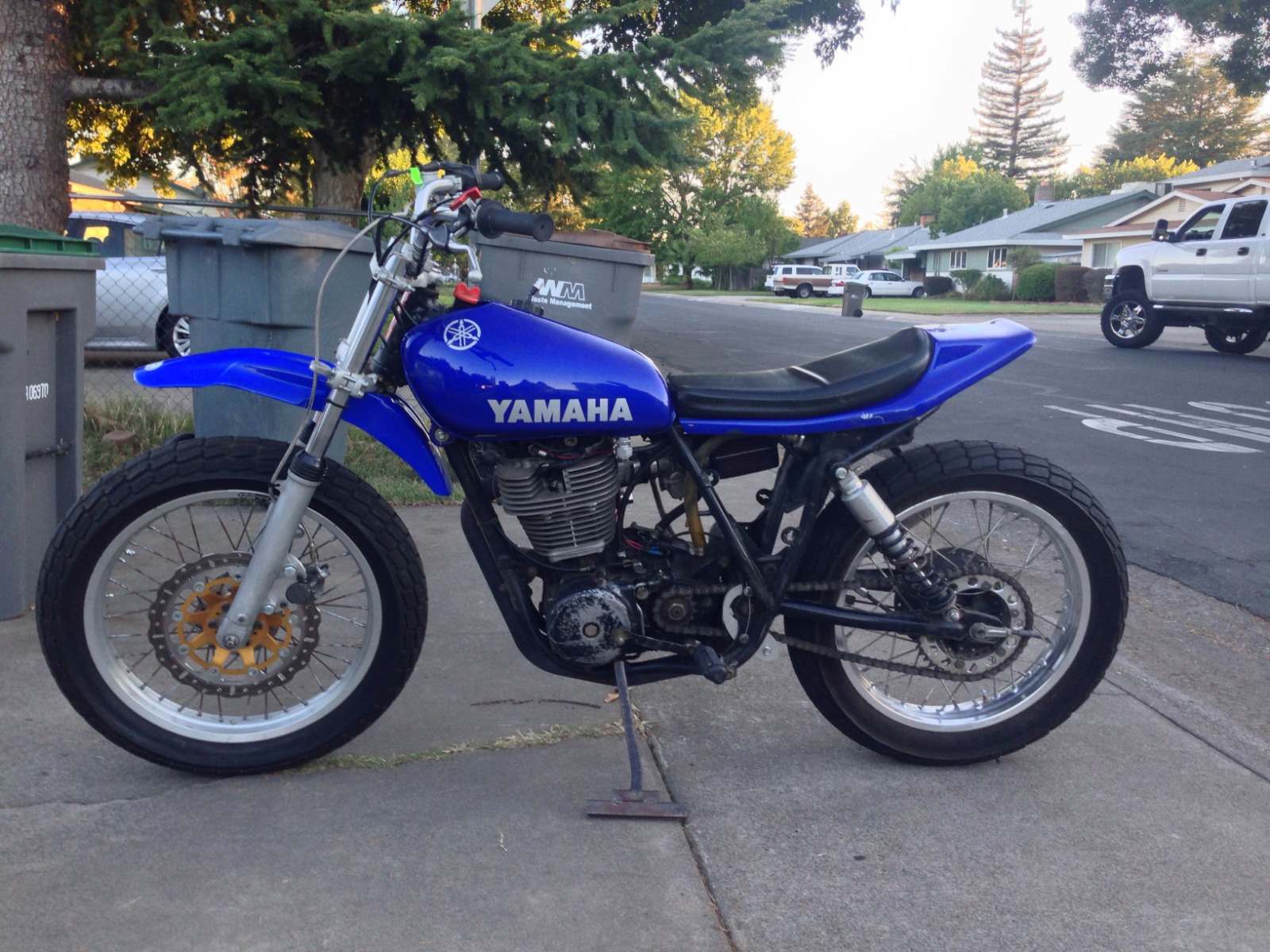

07 Jun 2022 07:47Fellas, there is more than 1 way to skin a cat! One of my mentors designed and built stationary chain tensioners.... when needed the tensioner would take up the slack. When not needed the chain came up off the tensioner. See below pic right behind countershaft sprocket.Larriken something you may want to bear in mind when setting your chain tension - a friend had a GSXR /Bandit motor in a Harris Magnum that was made for a KZ motor, because of the increased distance from the gearbox sprocket to the swinging arm pivot he had to run the chain a little looser than normal to avoid breaking it !

That is a cool tracker! I happen to be building a tracker out of a Suzuki LS650 Savage at the moment. I am going with a similar blue, but the frame and components will be metallic silver.

07 Jun 2022 14:03Not sure I follow your meaning TKZ? Sure... anybody can buy a spring loaded chain tensioner from china or amazon. My point was you have options for keeping slack out of your chain. It doesn't have to be loose and or floppy.There be many ways to skin that cat. Type chain tensioner roller on swingarm into your favorite search engine.

I do appreciate the creativity and skill it took to create the device pictured above. I was just pointing out that there are options for folks who cannot or would rather not go that way.
