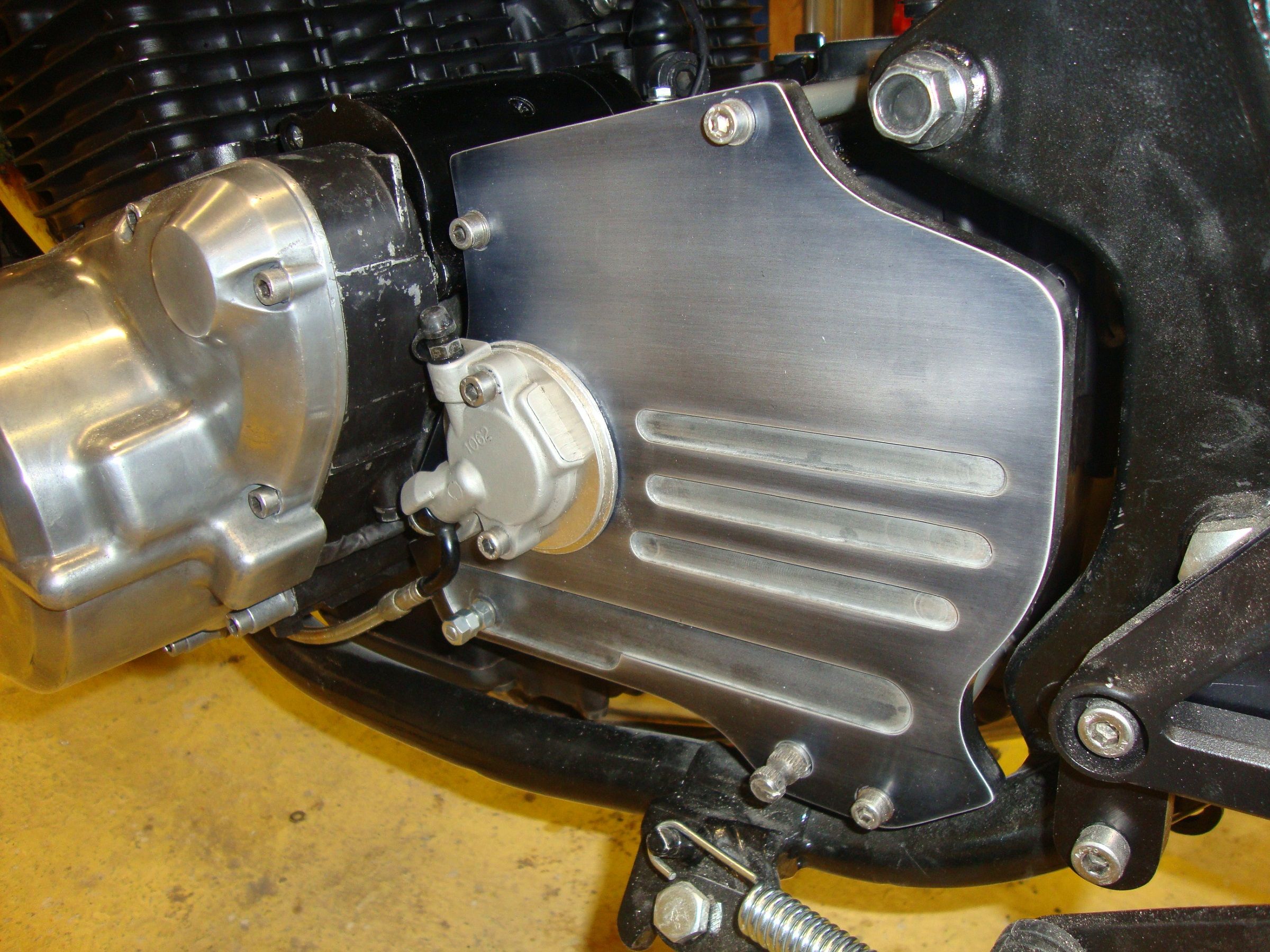

Today,I farted around with the clutch.I ended up making a couple of alu spacers to move the MC out a bit.
Everything is fitted and bled now but I cant know how itll work until Ive got the bike moving. So thats it for now as far as the clutch goes.

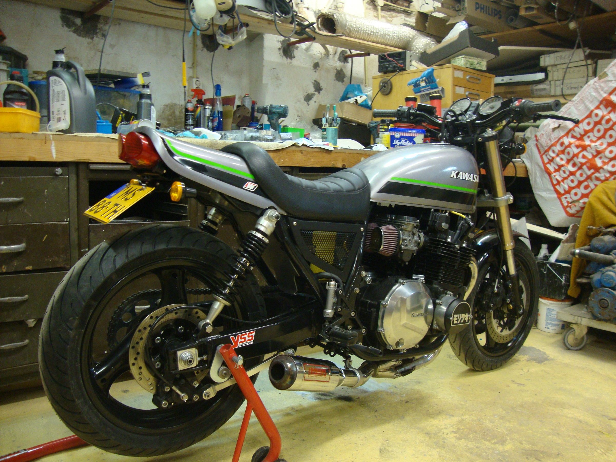

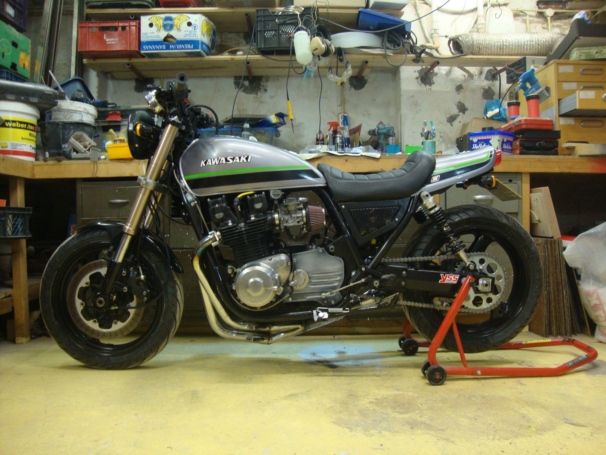

Some other bits and bobs done as well and Im pretty much there.I gave it a clean and took some pictures.
So,thats that. Theres still work to do.The clutch and the swingarm but the main thing is to tune the carbs and get it running. Thatll be happening....eventually. For now,Im done. Ive started clearing out the workshop and bringing my tools home. Now Ive got to find somewhere to store the bike until springtime.
