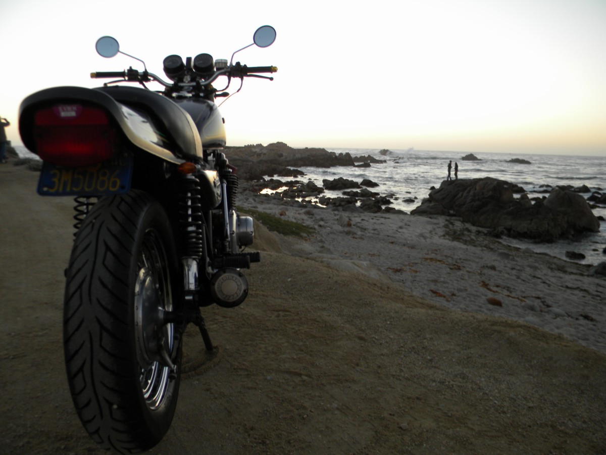

The taillight lense on my KZ650 was completely broken when I bought my bike, so I installed this one, which came from a Kawasaki ZX6R, or a ZZR600. I used some rubber material to adapt to the stock mounting plate.
