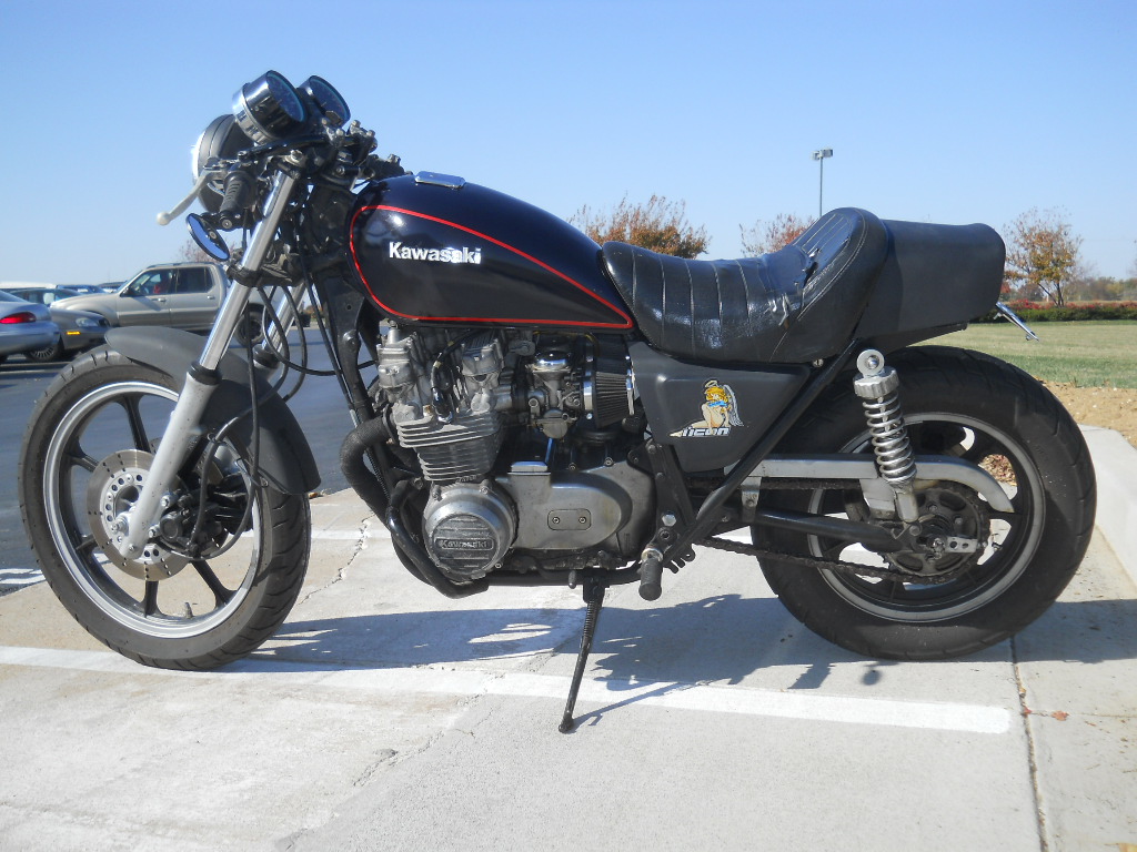

10 Apr 2012 00:22ColoPirate wrote: So after all that this is where I am at, did some more bondo, mounted a new headlight bracket, made a license plate holder, and primed the tank and seat so I can find all my imperfections. It still needs some bondo work but it's closer
ColoPirate, where did you order your tank from? Is it metal? Looks fantastic!

    Sorry, been a while, moved, been working on some stuff...
the tank is from a GPZ750, i think it was even the same year, or close to. its an 81-84 i believe. and yes it is metal. I found it on ebay.

05 Jul 2012 17:52small update, i made the leather seat. I went to a local (littleton, co) fabric place and got some black leather. then for closed cell foam i went to big5 sporting goods and bought a camping sleeping pad for like 5 bucks, cut a few layers out of it and glued them together. so far it works good, but i might have to add to it.

    So, finally got down to messing with the carbs, since I went with the pod filters I will have to replace the jets. Stock jetting was at 90 65, and I have been told to start with the main, so I am going to start around 130 and tweak from there. Right now the pods are the only change, still have the stock 4 into 2 exhaust, but I am in the mile high city, so elevation is a factor. Wish me luck, I will keep everyone posted best I can.

    So tonight i changed the main jets to 130 and gave it a spin. it seems to run good, i didnt notice any gas smell, but i am going to give it a little ride tomorrow and see if the spark plugs are dark and its running rich.
My friend came by and helped me out with a vinyl wrap for the bike, it wasnt easy but we got it on there. lots of heat from a heat gun, or hair dryer, and some stretching got it smooth for the most part. we had to make a couple cuts, i just have to figure out how i am going to cover them. here are some pics
