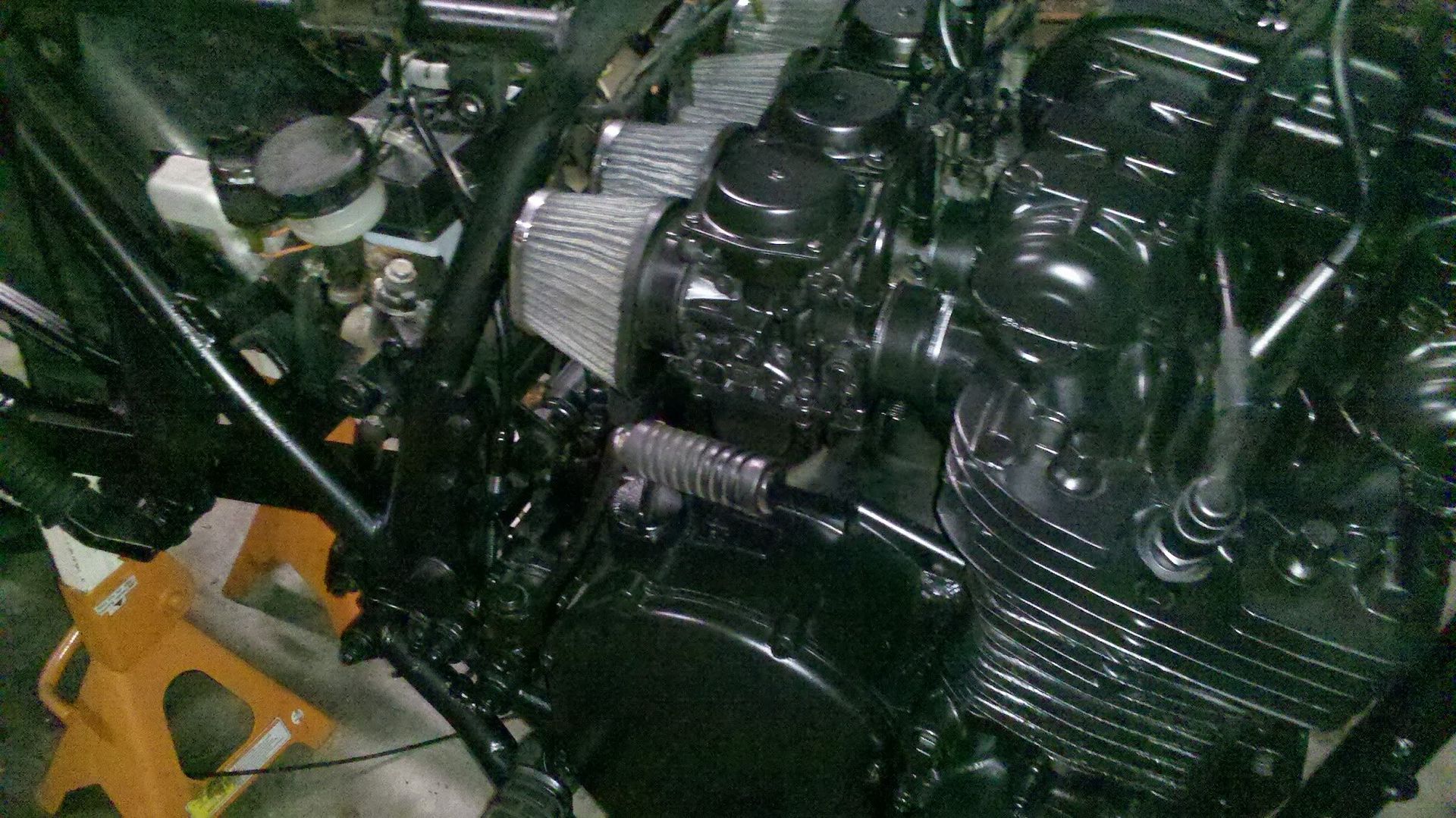

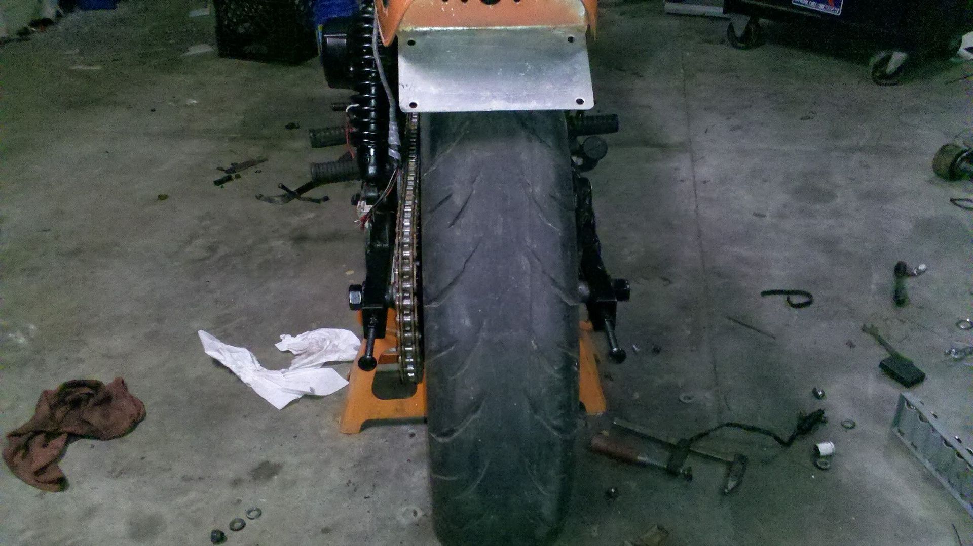

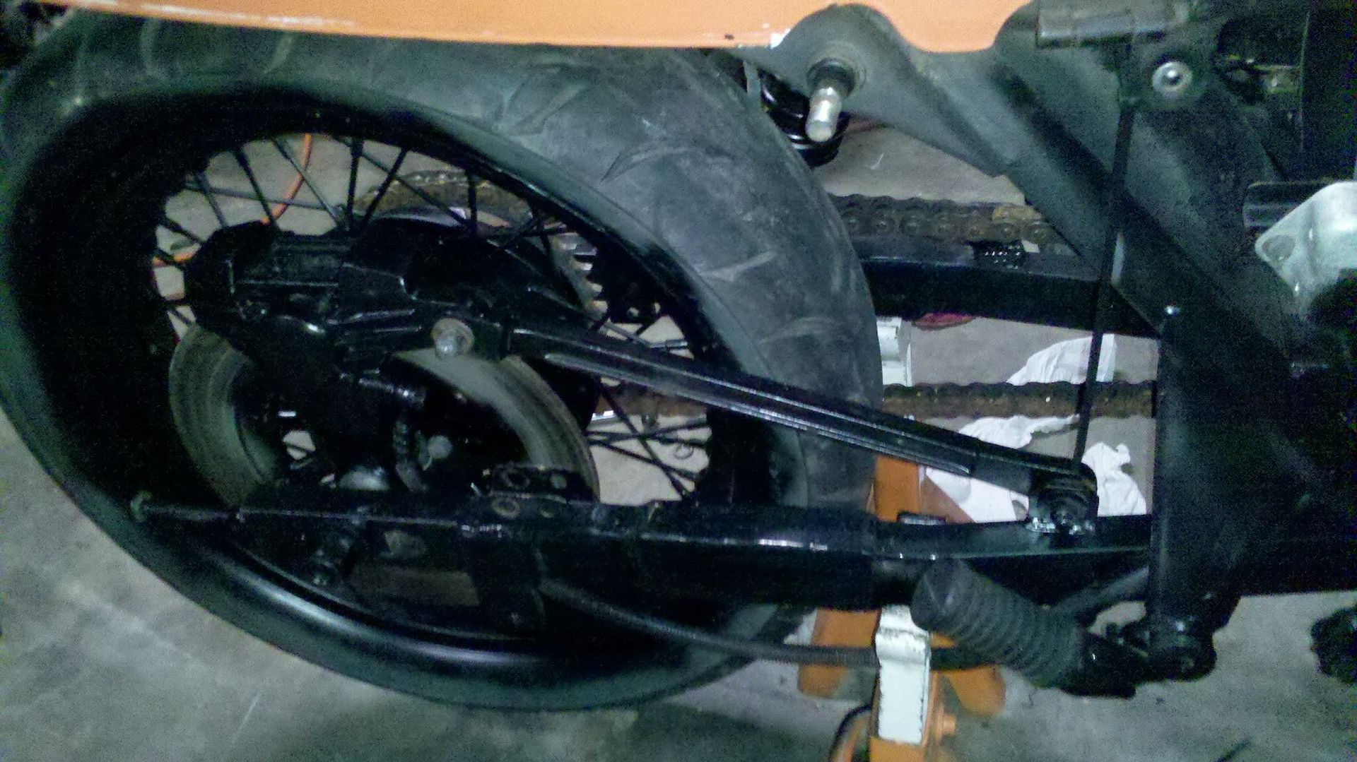

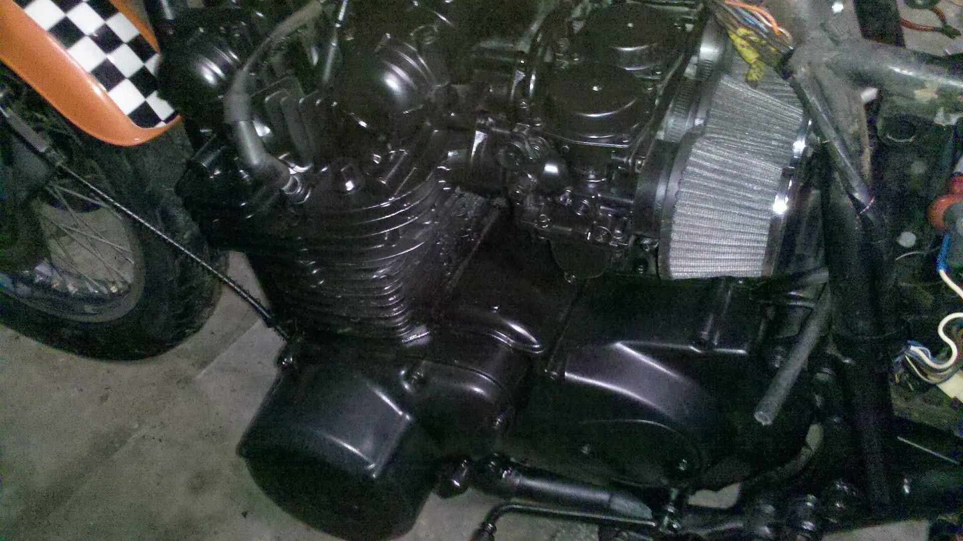

Hey, Ram. Just sat here and read the entire thread! 3 hours and a pot of coffee. It is quite a transformation your ride has taken and it gives me great hope for mine.
What is the advantage of the front end swap? I'm guessing better handling and ride? Will the rake be different?
I'm making progress on my '78 A2A. Mostly repairing bad wiring jobs, finding minor leaks,replacing old fluids, etc. I'm ready to buy a new rear tire and would love a big fat one like you have but I'm going to stick with the same size 140/70 that's on it now.
Here's few pics. I'm going with black everything except 'tupperware' which I haven't decided on a color yet. I am not a fan of chrome in general.
