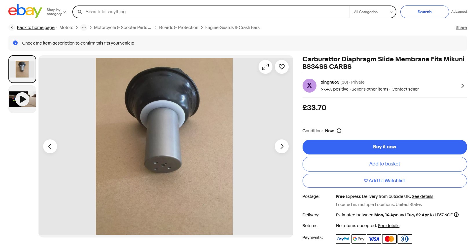

Re: Carb problems; where to get new diaphragms
07 Apr 2025 06:27
These might also be worth considering, a little more expensive but pre-assembled ready to install needles and fit ? (I assume these are Mikuni carbs ?)
- Posts: 8206
- Thanks: 3577
07 Apr 2025 06:42
It's very unusual for all four carb diaphragms to go bad at the same time. Maybe if someone dunked the carbs, with the slides attached, in some harsh chemicals?
JBM K-71 might work. Your bike has Keinin CV34 carburetors. The Spectre carbs, and slides, are different from the more common CV34's as used on the 750E/H bikes.
I've got a bunch of spare CV34 slides, but I think they are the earlier type. Have to check.
