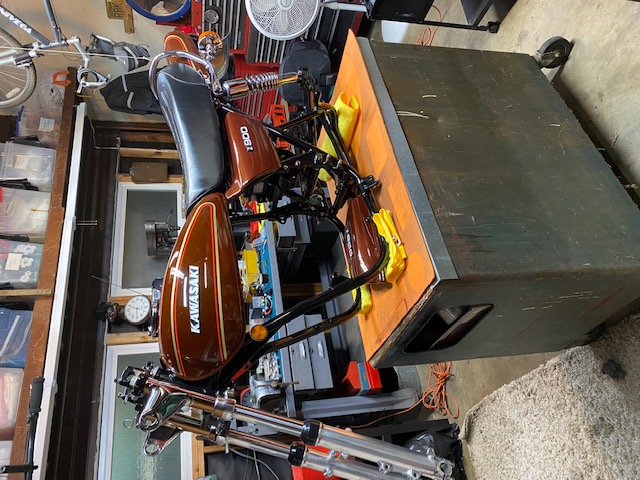

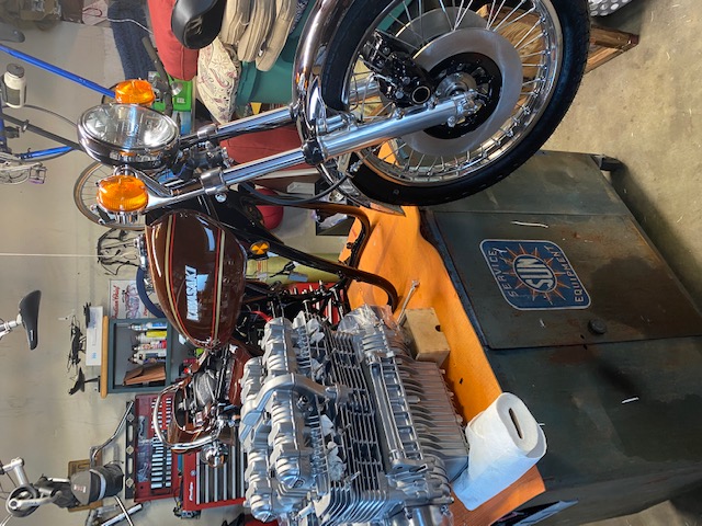

Recently one of my clients gave me a 1976 KZ900 that was completely worn out , but completely original. My goal was to do a complete frame up restoration but improve on anything I could to make the bike better. The motor was completely rebuilt with all the good stuff, crank welded and all the items related to the cam control updated,, better clutch actuator and such. I upgrad ed to Dyna ignition and coils.
The front forks were rebuilt with all new parts and Racetech emulators, tapered steering head bearings, swing arm needle bearings and stock looking ICON adjustable shocks.
Wheels were redone and new bearing installed, upgraded new style period type tires. Z900 dual disc conversion. I used the shorter turn signal stems and slightly lower period type handle bars.
I have to complete 4 pipe system, stock airbox and restored stock carburetors.
Its a work in process and keeping me sane through this covid mess. Here are a few pictures. If any one finds this interesting,

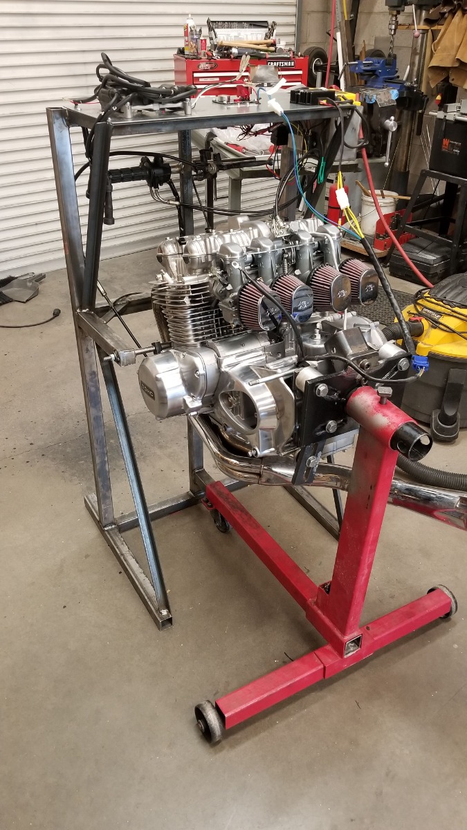

I like the run-up stand ! (and the bike)

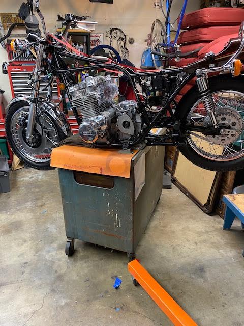

Excuse the Hillbilly garage, but I was able to get the motor in. It was a bit of a challenge with one person., but I did it without buggering up
the powdercoat on the frame.

Nice bike! You should see MY garage, the wife doesn’t want to go in it. Which could be a good thing, right!
I have a 750 LTD which is not a very attractive bike original, but yours, it’s beautiful.
By the way, how the heck are you gonna get that bike back on its 2 wheels?

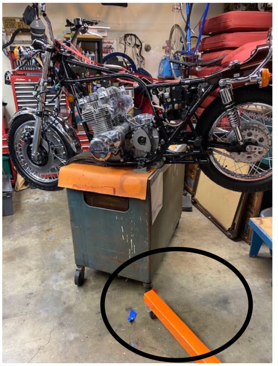

Uuuuuhhhh..... Now what?

28 Jan 2021 09:09Kaylinator wrote: Uuuuuhhhh..... Now what?
I’d assume that this is one leg of an engine hoist. Should be strong enough to lift the bike up. Slide out the bench and lower it.
