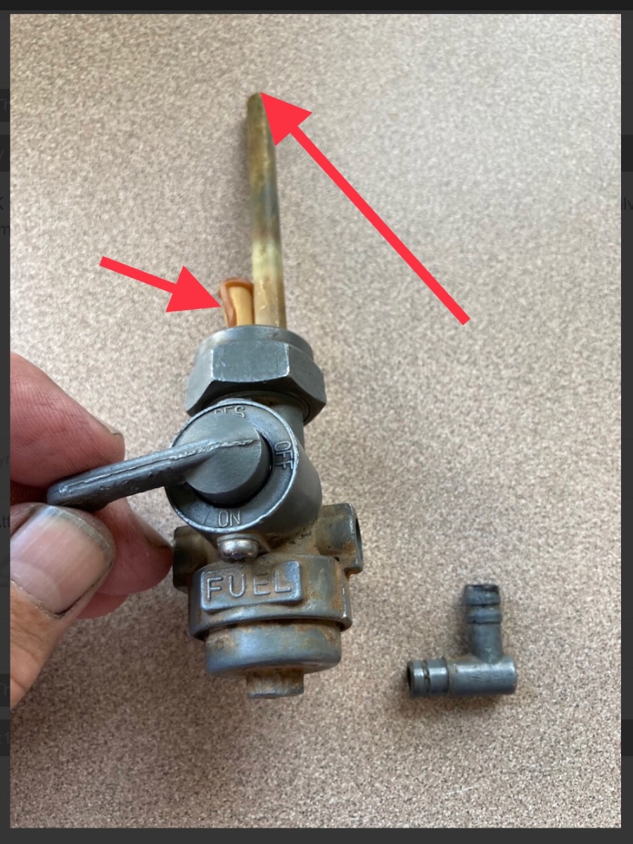

OK thanks I will. Anyone ever fix by JB welding one of the nipples on a petcock valve. The L shaped nipped came out of the petcock valve

Use LOCTITE 620 / 638 / 641 / 648 to secure the nipple.

Thanks one final question about that nipple. It looks like there might have been an o ring on the end ? Also that little screen filter is damaged ya thing it should be replaced because all the rebuild kits don’t have the screen. Thanks.

There should be a screen filter on the primary also. I haven’t found a good source for them. Hopefully another member might know

Thanks I was thinking the same thing. Only replacement that don’t require grinding a bigger hold in the tank are Chinese junk

Pingle is a good option. Pretty much install it and forget it. I have them on my bikes. Get the single outlet feed. Less chance of a leak. You can get 5/16 stainless elbow and tees from beverage wholesale to route the fuel lines nice.

Mikaw wrote: There should be a screen filter on the primary also. I haven’t found a good source for them. Hopefully another member might know
You may want to call this place. They sell petcock filters for Yamaha bikes and I suspect they will also fit Kawasaki petcocks. Ed
