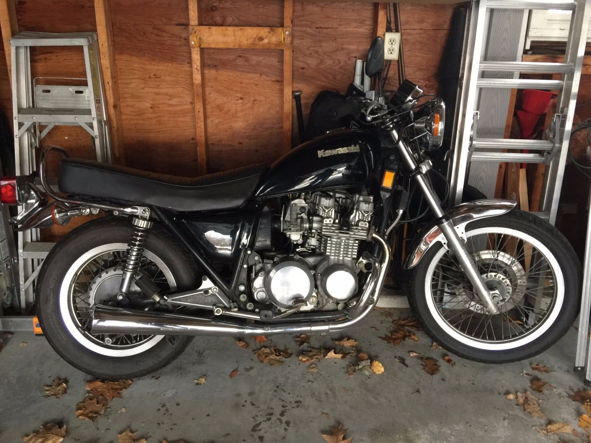

Hi all, and greetings from the northeast.
I think I got a pretty amazing deal on this bike. I happened to see it on craigslist for $600 right when it was listed so I got there with cash as soon as I could. I think you can see from the photo that it's in pretty nice shape.
The bad news:
I will definitely have some questions for all you experts here but I think I've probably gone on long enough. I Just can't wait to ride this thing.
-Barry
The bad news:
- It does have a carb problem because the guy I bought it from replaced them. He said it was running good but the carbs were leaking (probably a stuck float?) so he bought another set and put them on. He was under the impression that the carbs he removed weren't the correct model for the bike, which was why he decided to replace them. Anyway, since he went ahead and tried to fix something that wasn't really broken, it hasn't run right since. It fires right up with starting fluid and sounds good for the 2 seconds that it runs, so I'm not too worried.
- The odometer is broken so the title has a milage discrepancy. It's showing 31k right now so I know the bike been ridden a fair amount.
- The worst part is that it's now winter here so I have some waiting to do before I can really even work on it. My garage is pretty freakin' cold.
The good news:
- He gave me the carbs that he removed so the first thing I did was bring them to a guy I know who can go through them and make them right. My plan is to put those back on and see what happens.
- I absolutely love what he did to the seat, which was recently reupholstered.
- It has new tires, new battery, new coils, and new brakes.
- All of the chrome is in amazingly good shape.
-Barry

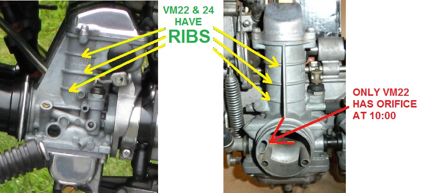

Welcome aboard! The carbs for your bike should be Mikuni VM24SS type. The photo at the end of this reply shows the difference between the VM24SS and VM22SS carbs. The set shown in your photo appear to be correct for the bike since the bodies are ribbed.
