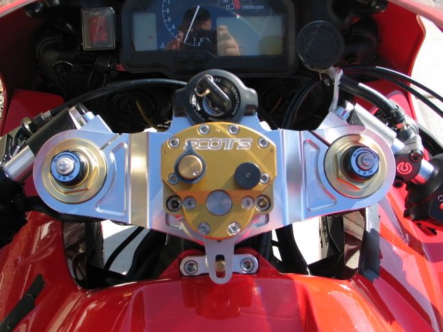

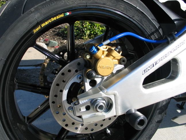

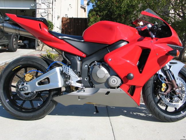

My name is Victor and I am a proud owner of a 78-79? Kawasaki KZ650... The site looks great and looks like there are a lot of nice and knowledgeable folks here! I'm new in this whole "old" bike thing and have some questions... I want to make the bike into a track/race bike and i would like to simplify the wiring as much as possible. I've searched the forum and didn't find much about it... Basically I want to run the bike off the kick start, no key, no lights whatsoever, no battery, no kill switch (just gonna stall the thing to stop the engine)... So if anyone can help me, it would be greatly appreciated! I'm going for the cafe racer look so I will post some pictures of my progress! For now you can see my current bike that I have recently converted for the track.

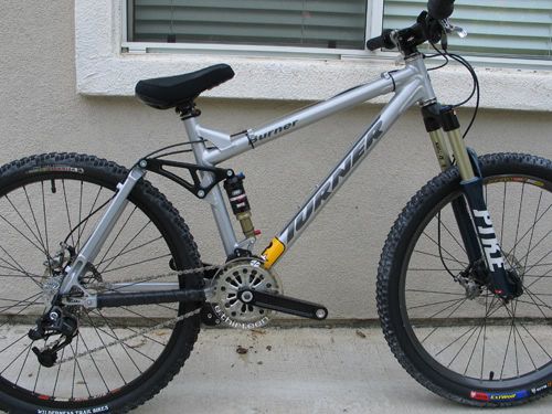

Nice to see there are still some manual propulsion folks out there! The bike is actually a Turner Burner, setup for mountain cross, dual slalom... I like it! Originally the frame is for XC but factory guys use it to race in, so it works for me... How do you like the Heckler? I am about to pick one of those up for my girlfriend... Here's a picture of the my bike.
