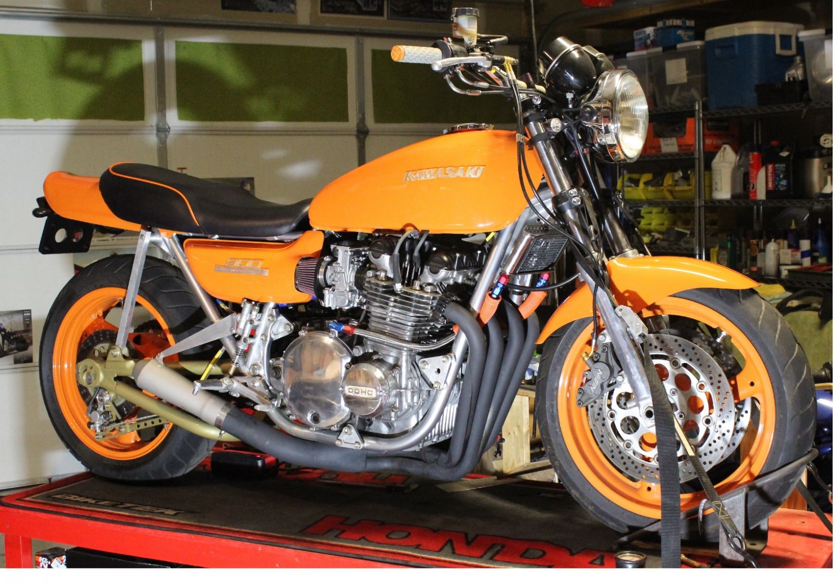

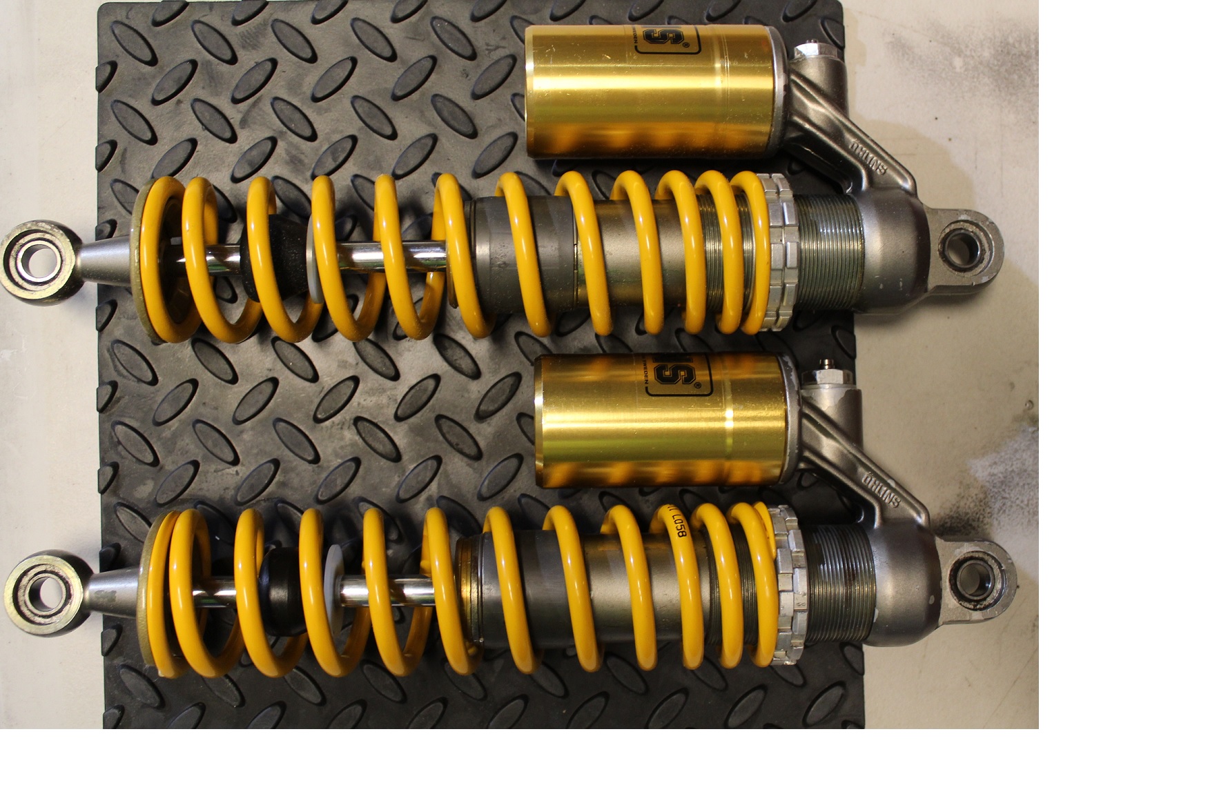

Replied by tk11b40 on topic 1975 KZ 900 , ZRX Swingarm, 89 GSXR front end
09 Mar 2015 21:56
tk11b40's Avatar tk11b40
Leon,
O-ring 3.1x1.6
O-ring 33 X5
Seal Head Assy.
Piston ring
Teflon Hex band 44/5
Oil
2 springs.
The guy that did the work is also taking care of some AMA bikes. From what he told me the shocks "hard parts" hardly wear, as you can see there are piston rings and such that do wear.
Any good suspension shop can tear them down and rebuild them for you. I was going to use KFG racing in Seattle, they tuned and rebuilt the suspension on my Ducati. They would be the number one choice if you are on the west coast. I was unaware that there was a guy in the Reno, NV area that could do it, When I found out I sent them to him for a faster local turn around.
www.kfgracing.com/
07 Mar 2015 23:18 - 07 Mar 2015 23:19
As far as wringing it out goes, there is a track day at Thunder Hill in Willows, CA.
Hmmmmmmmmmm.
For now look at the new jewelry.
Ohlins shocks purchased on Ebay then rebuilt, with the proper spring rate now.
05 Mar 2015 20:31
The Ohlins shocks Are back from the shop rebuilt and with the proper spring rate. Time to get a license plate!

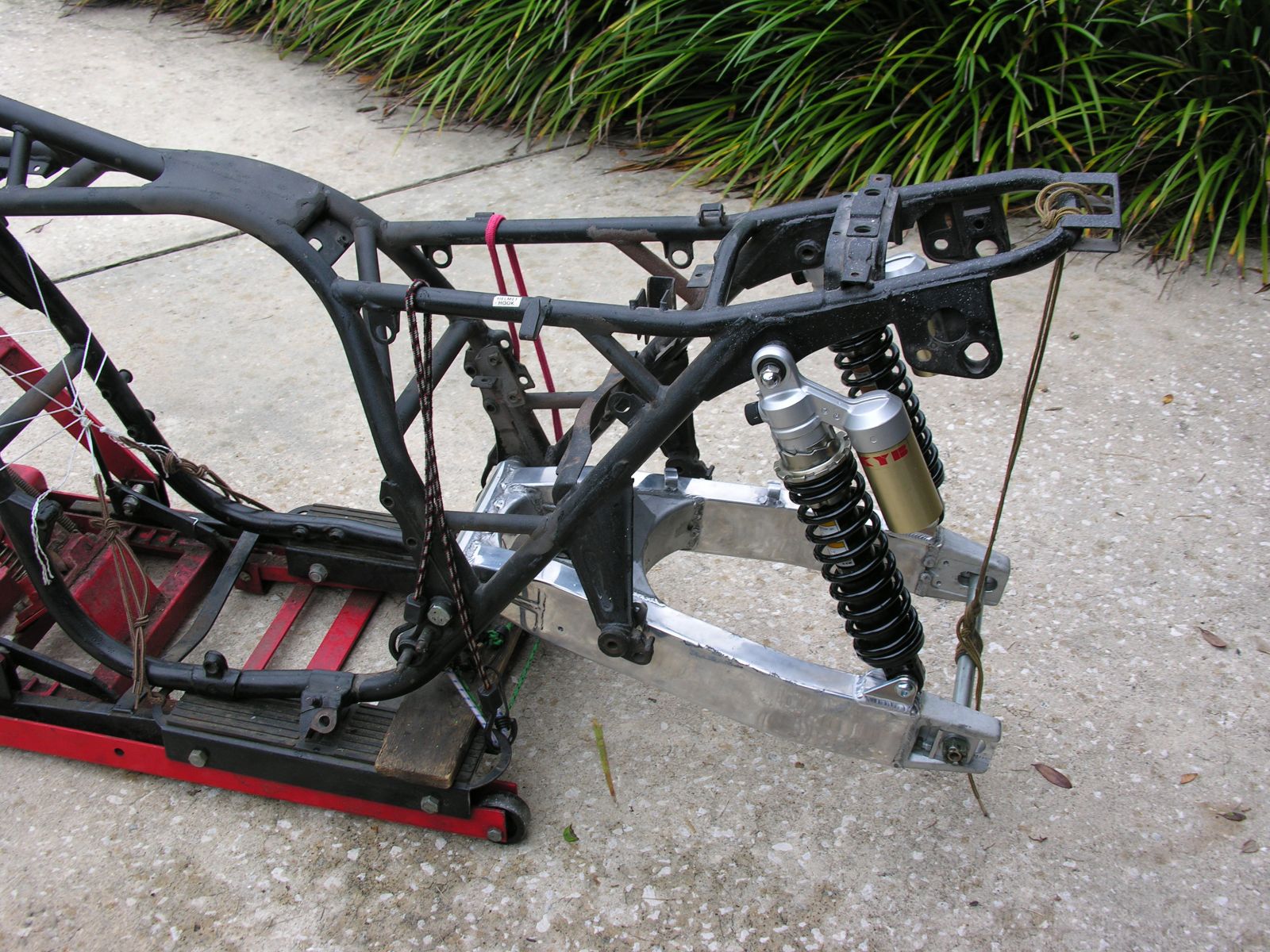

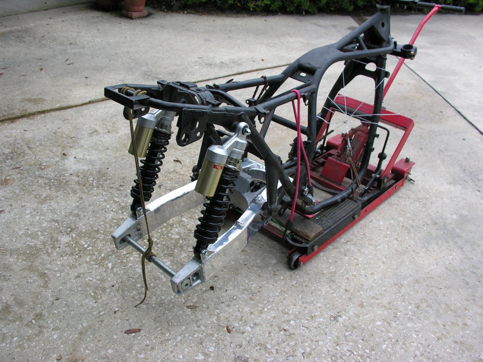

Replied by baldy110 on topic ZR1100 shocks for a KZ1000?
03 Mar 2015 11:09
baldy110's Avatar baldy110
They work great, a HUGE upgrade from the originals. I even used the ZRX1100 swingarm.
