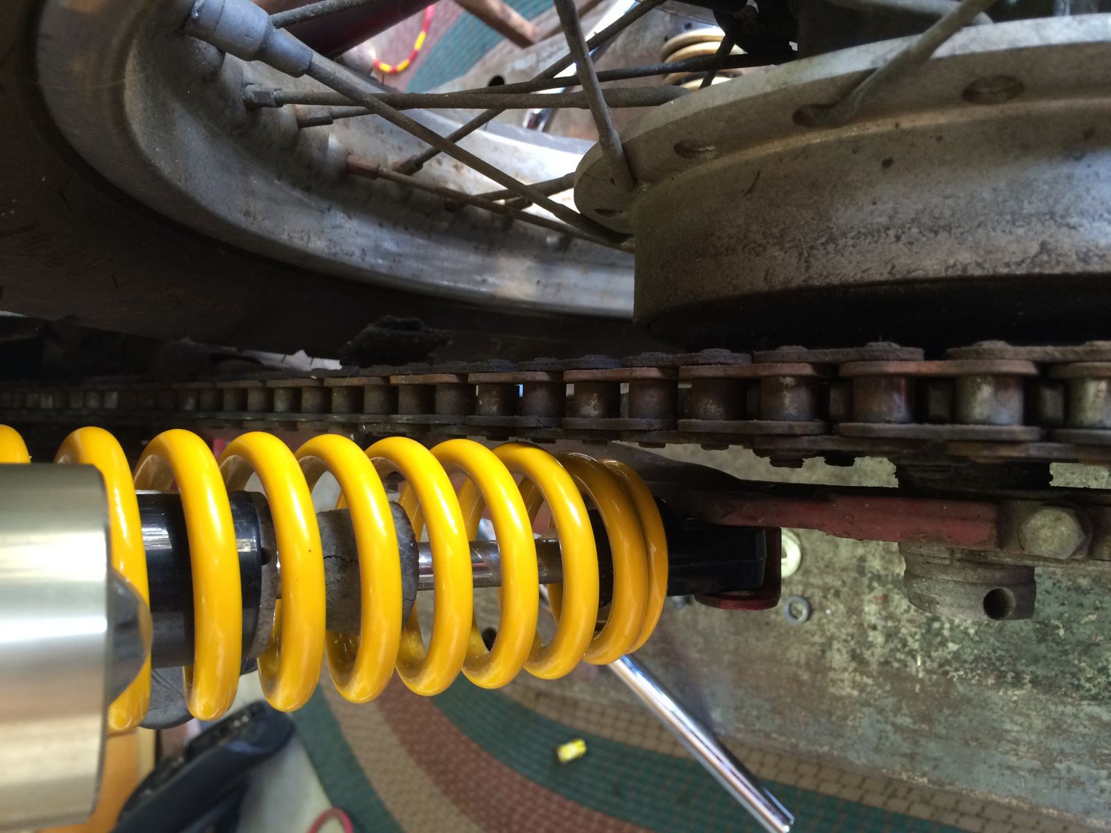

Replied by SWest on topic question for fitting new ZRX shocks to the KZ
05 Apr 2015 18:58
SWest's Avatar SWest
I was thinking about it. Off setting isn't a good idea. The chain would ride on an angle wiping out the chain or sprockets. Maybe damaging the bearing. Spreading the swing arm could cause cracks at the welds unless it is heated and bent. Two slight bends. I welded frames and was a finish welder for three years until I was 21. Wheel chars and medical equipment but the principals are the same. Just let it cool off on it's own. That way the swing arm will be wider on one side with a spacer to make up the difference. We're only talking 1/4-1/2" here.
Comments?
Replied by NakedFun on topic question for fitting new ZRX shocks to the KZ
05 Apr 2015 18:35 - 05 Apr 2015 18:39
NakedFun's Avatar NakedFun
Tyrell Corp wrote:
swest wrote: I've read here that to off set the wheel doesn't cause problems on the radical builds. How about off setting it 1/4"?
The zrx have an offset rear wheel as standard!
The ZRX 1200 is, the 1100 isn't. The offsetting of the rear wheel isn't a big deal. As I stated earlier, have you tried just flipping the shocks upside down as the coil spring is larger in diameter compared to the shock body above the preload ring. So you could probable gain at least a 1/4" of clearance..... Just a thought...
Cory

Replied by richrand on topic question for fitting new ZRX shocks to the KZ
05 Apr 2015 17:07
richrand's Avatar richrand
Sorry I couldn't get a pick, but this is pretty much exactly where I am, except that the rivets on the chain actually touch the spring.
etbike3135 wrote: I think its the wheel and sprocket carrier. If it was a ltd wheel or z1 I think it would fit.

What about flipping the shocks upside down? I believe the upper mount/body is considerable narrower than the spring section. Might give you enough.

530 chain is the same inside width as a 630, but they can be a tiny bit thinner depending on the brand. The other option might be to go up a tooth or two on your front sprocket to use a smaller rear sprocket which might give you some more clearance.
