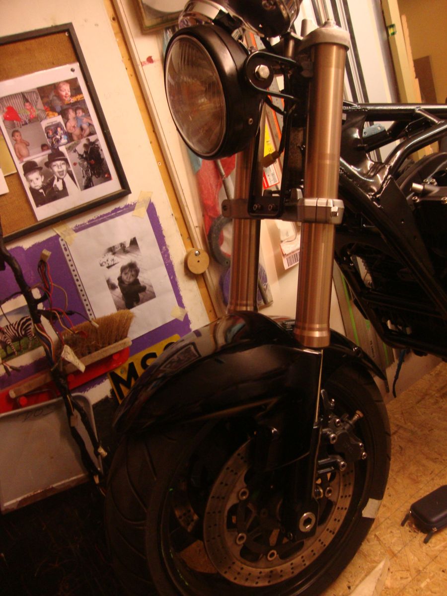

Replied by davido on topic CSR1000 Project Build
22 Jul 2015 11:26
Putting some bits together today;
The 'lighty up' bit. With the original KZ bracket,(cut extended and powder coated by my own fair hand!)
The rear 'lighty up bit with all the bits
YSS shocks looking great (I need to find the top mount nuts though .As with a lot of the bits,theyre in a box somewhere!!
I was looking at the front mudguard and Im not feeling very excited about this ZXR thing. Does anyone have any suggestions for an alternative? ( I like the look of the ZRX ones but they arent cheap) Something cheap and cheerful.
