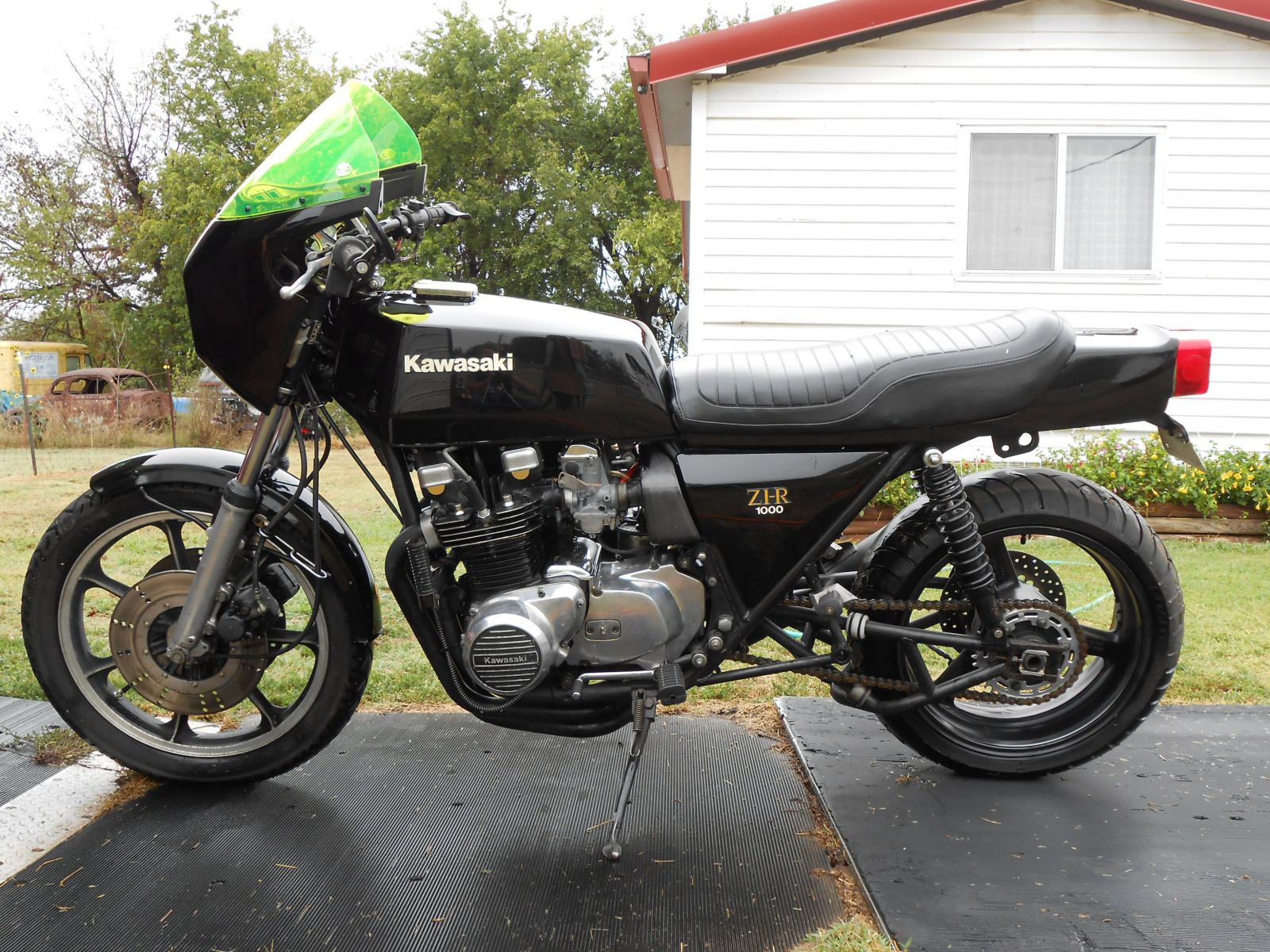

30 Apr 2015 07:40tappat wrote: BlackBeard said the same thing about modifying it, What I'm trying to accomplish is to have the back end of the bike sit up higher and have the ability to place a wider back tire on the bike. is this possible with stock parts?
hard to go much over a 140/150 in the stock arm.
zrx shocks like on the black and gold bike will raise the ass end.
the front forks can be dropped through the tree's to lower it.
but the right way would be to shorten the fork tubes.

You could drop it about a inch or get some risers with lower bars to drop it more.

an aluminum gs1100 swingarm( like 83 model) can hold a 160 but uses a shock with a clevis instead of the eye like a kz.

there is always the custom swingarm option. :evil:
here is the custom chromo underbaced arm i built to stick a 6 inch rim with a 200mm wide rear tire under my stock not modified 1980z1r.
it is also getting an 05 gsxr frontend mated to the matching r1 wheel hung on it also
this bike will be returned to stock one day.
Attachment aftergaragewreckpaintjob4.jpg not found

Will these raise the rear of the bike?

those shocks wont raise the rear any.
at least 342mm or longer to raise the rear.

30 Apr 2015 08:59tappat wrote: What price range does a custom swing arm typically casot?
$400-600
You should PM Leon. Due to forum regulations he is not allowed to offer his services.

Nice bike you have there..........I used gsxr1100 swingarm, forks, brakes, etc for my build............swingarm needed a couple spacers on each side and a sleeve for swingarm pivot........weld on shock mounts.......head bearing swap for new forks but can easily be returned to stock if need be in the future.
