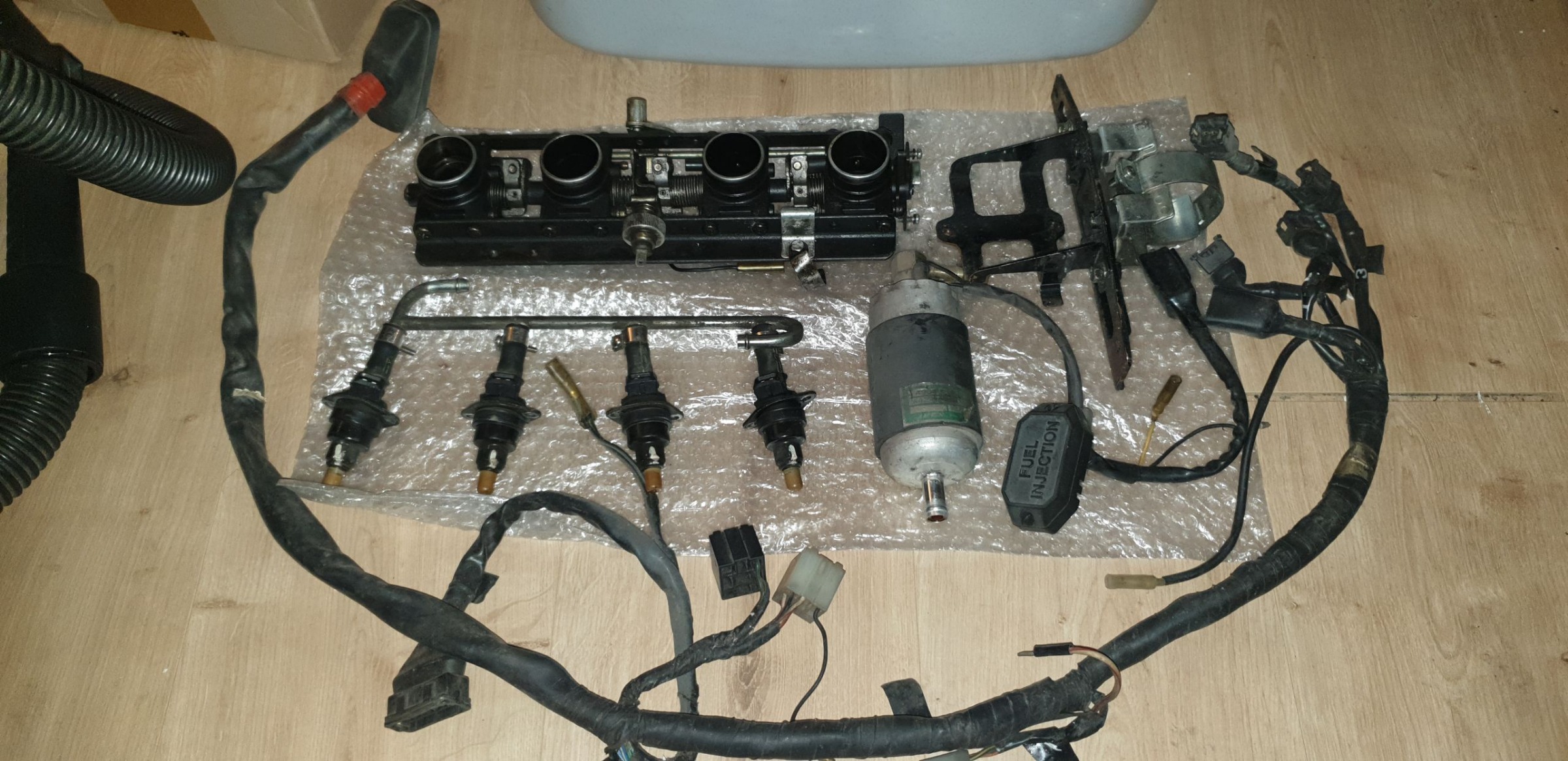

You have to pay some extra money for the cleanig of my living room, tiny little paper chips everywhere, arrrrgh
All parts will get some light cleaning, lubrication and the throtte body a static sync before shipping to make some things easier for you ......

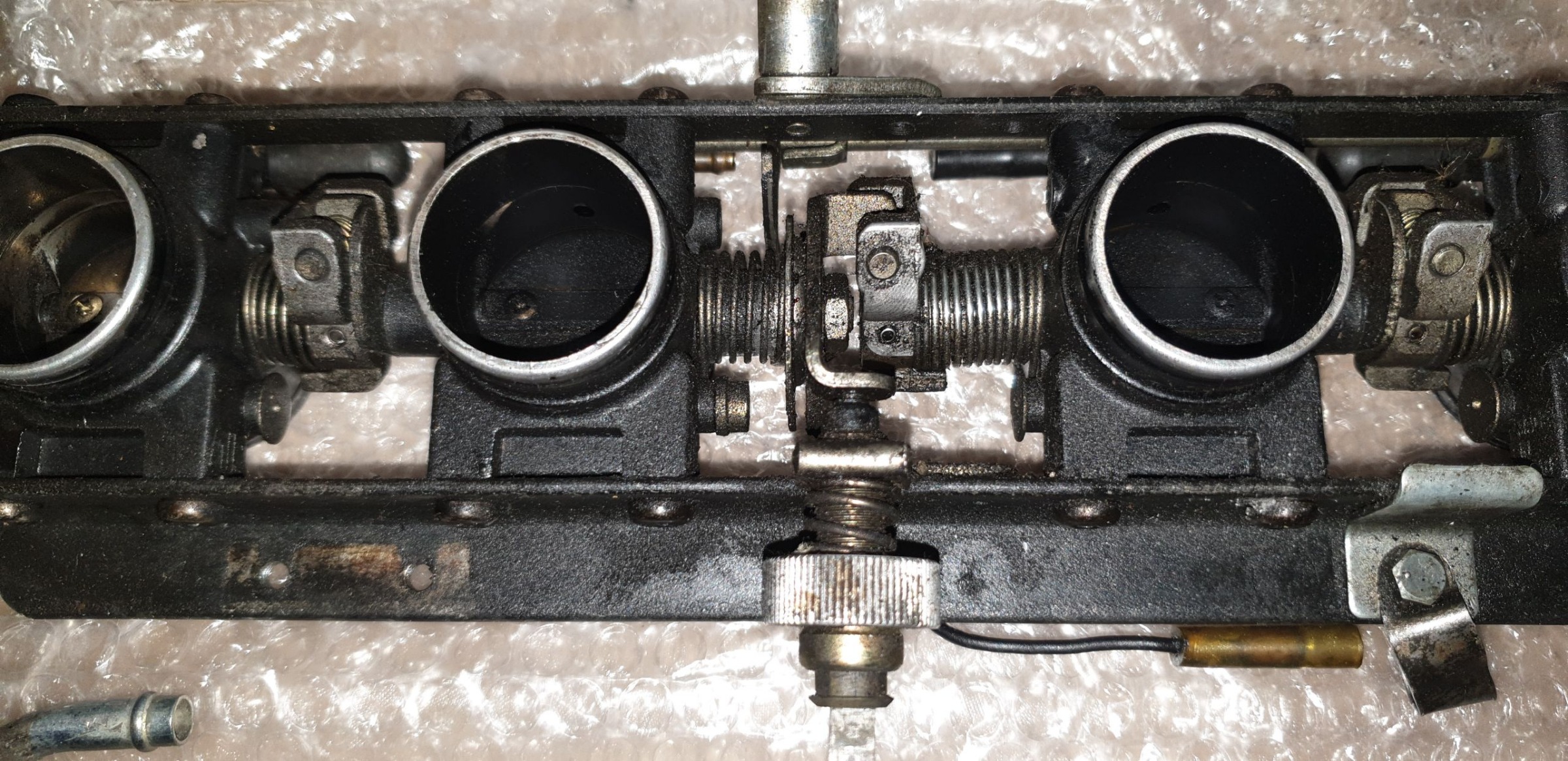

I had cleand the throttle body as good as possible, lubed the shafts and static sync the butterflys.
Will shipping package tomorrow, paper chips are dumped in the paper recycle bin.
You will get bubble wrap instead....

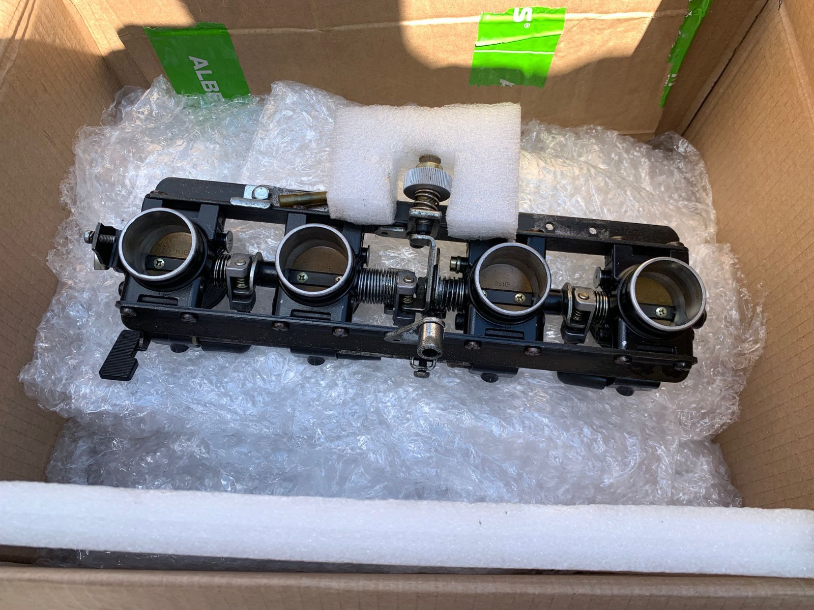

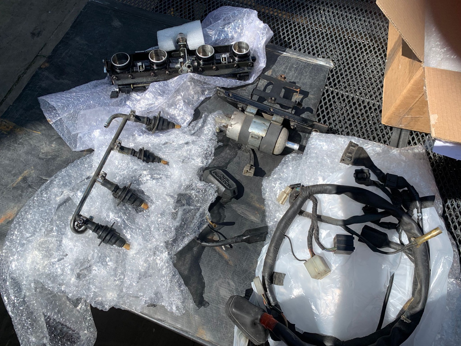

Package arrived. Some very good looking clean parts, throttle bodies look like new! (See pics)
Thank you very much for all your help and time on this
The bike is now running pretty good, even with a faulty throttle switch. I havent fitted the new one yet but the new idle switch is fitted and working
Having now ridden it, I think my injectors are leaking so the injectors you sent are going to be useful!. It wouldnt start from hot a few minutes after a long run and I found the plugs were wet and fouled. Turning the gas tap off and letting the FI run dry seems to prevent this happening. I can clean and test the set of injectors and swap them in when I do the Throttle switch.
