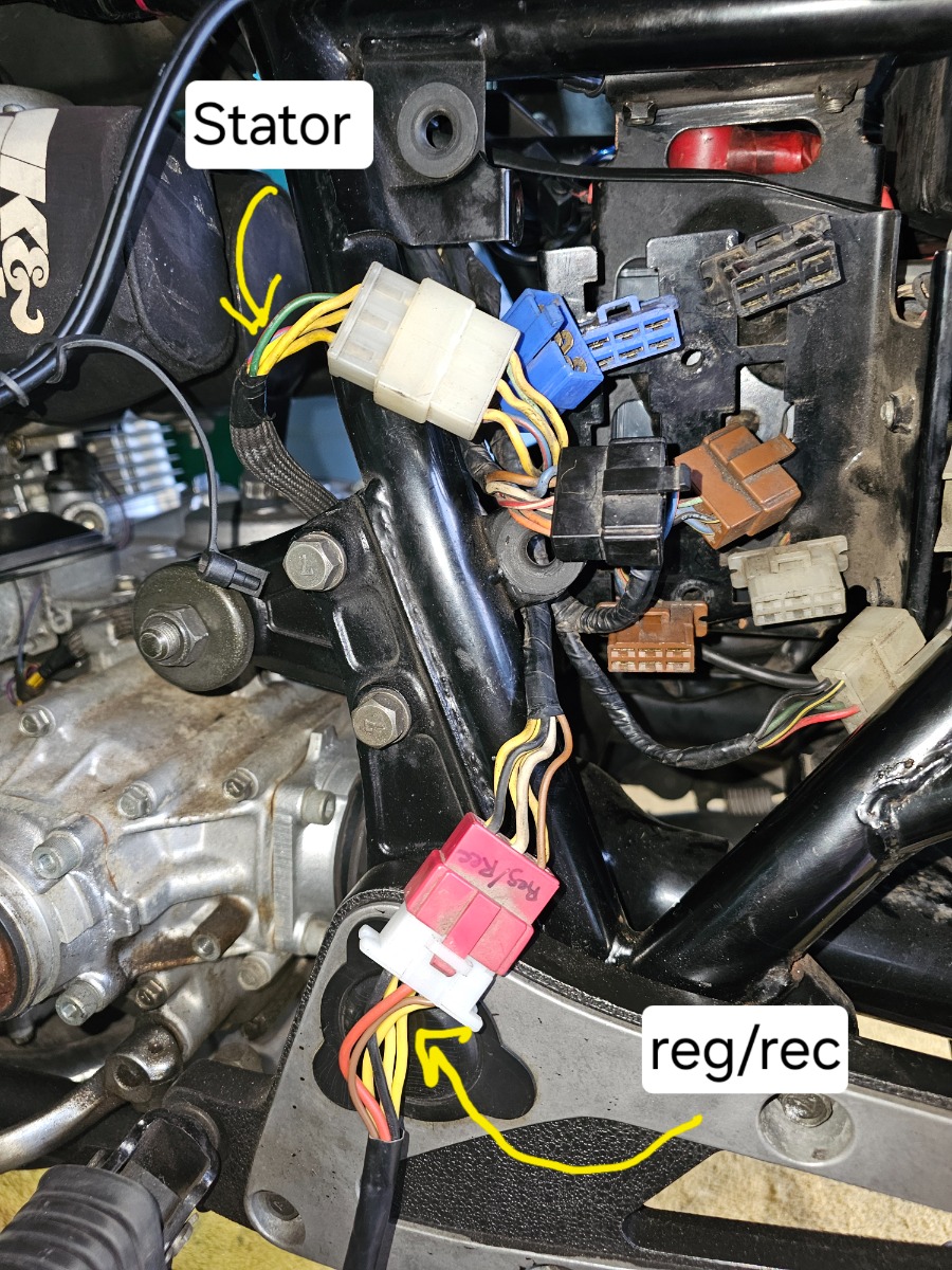

I'm a bit confused on where I'm clipping to get the wiring to the 775. Attaching a pic of my connectors- hoping someone can say which connector I can clip from and on what side of the connector (if it makes a difference). I'm assuming I'm clipping from the reg/rec connector but wanting to confirm before I go clipping away

- Posts: 6810
- Thanks: 4290
Re: Sh 775 regulator rectifier info
30 May 2024 01:01

Dude, I appreciate you so much. Prolly seems like a stupid question, and it was making sense in my mind to do it that way, but from the bits and pieces I was reading on different posts about the sh 775, I was second guessing myself left and right. Thank you so very much!
