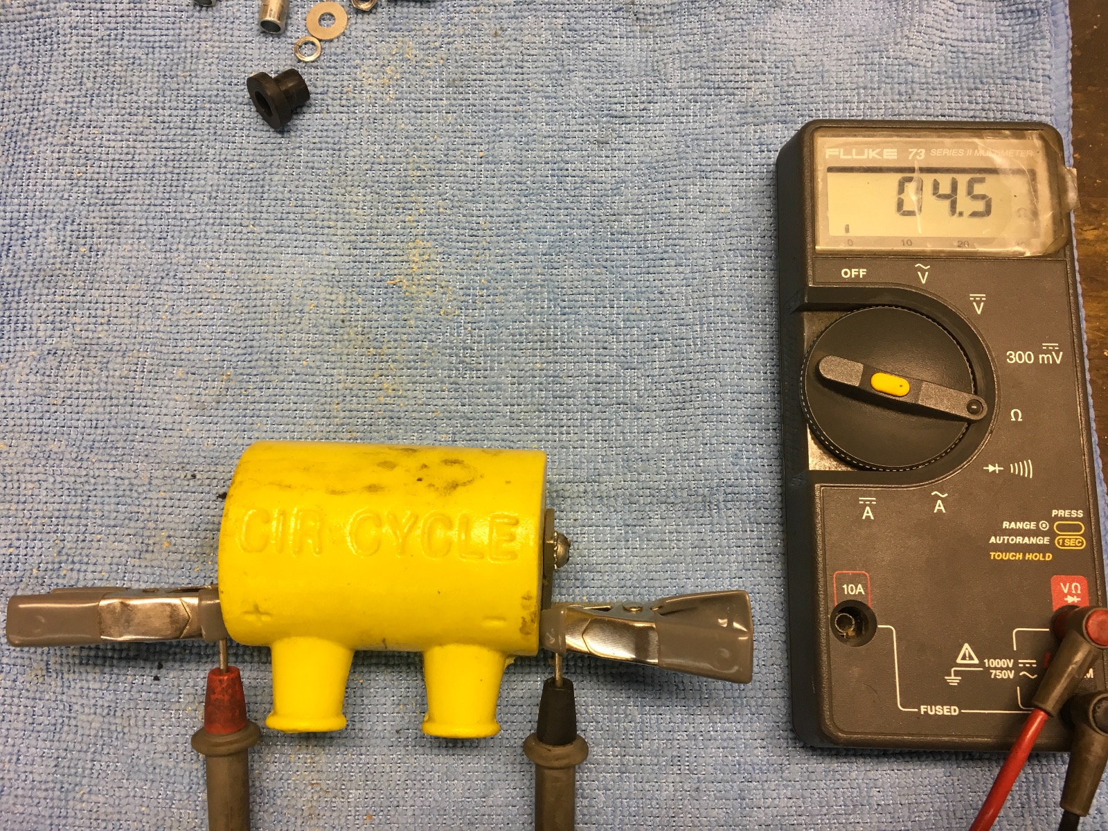

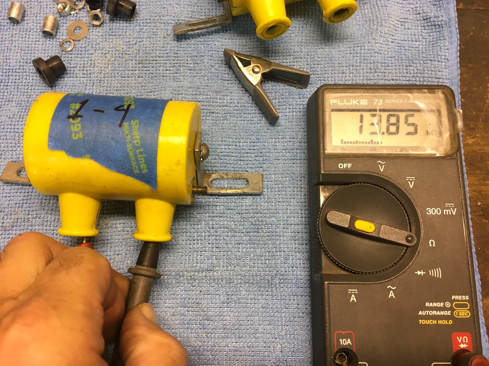

Test the coils. Need an ohm meter and check results against the acceptable range in the FSM. I’ll look to see if I can find one...
