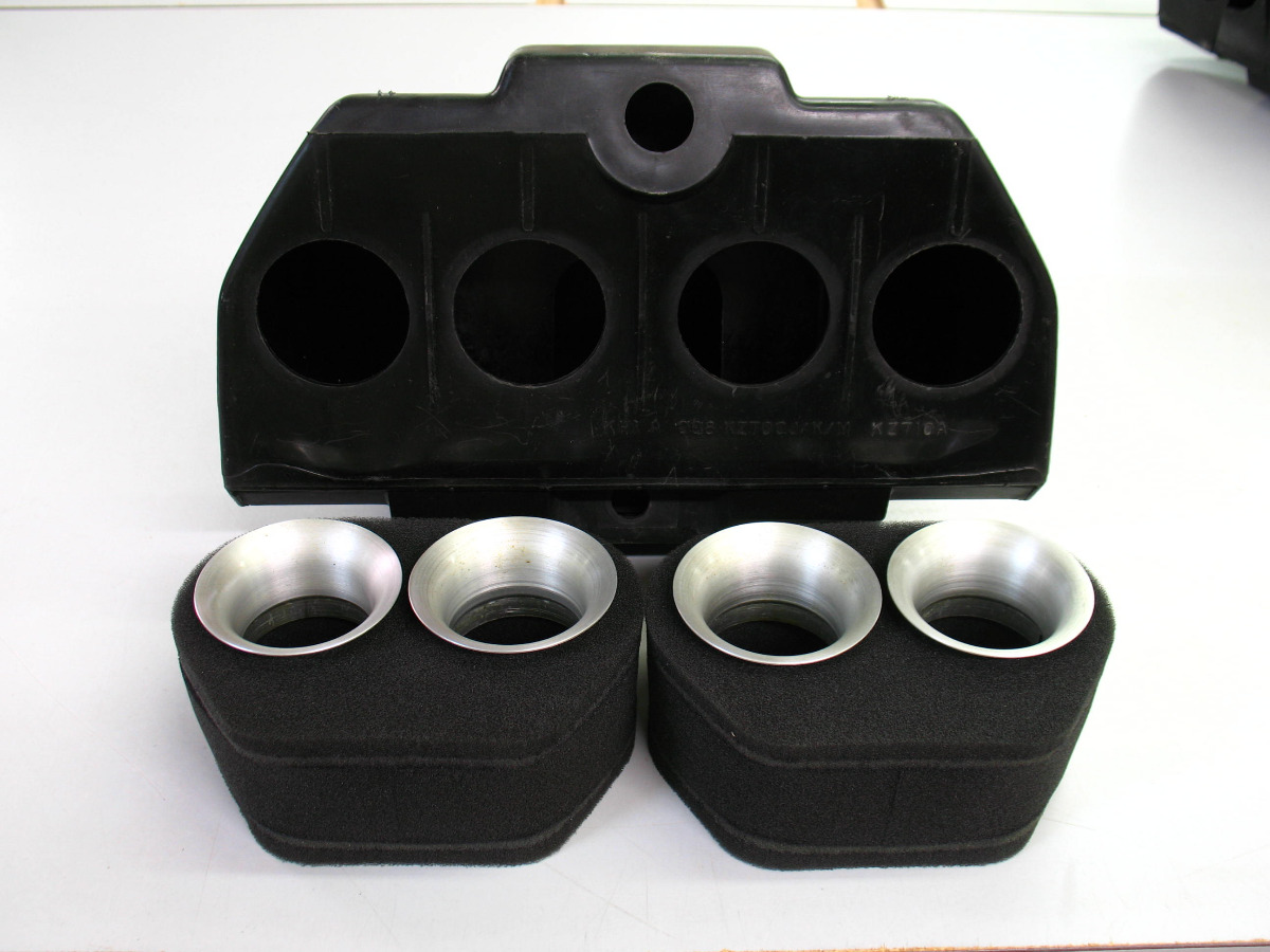

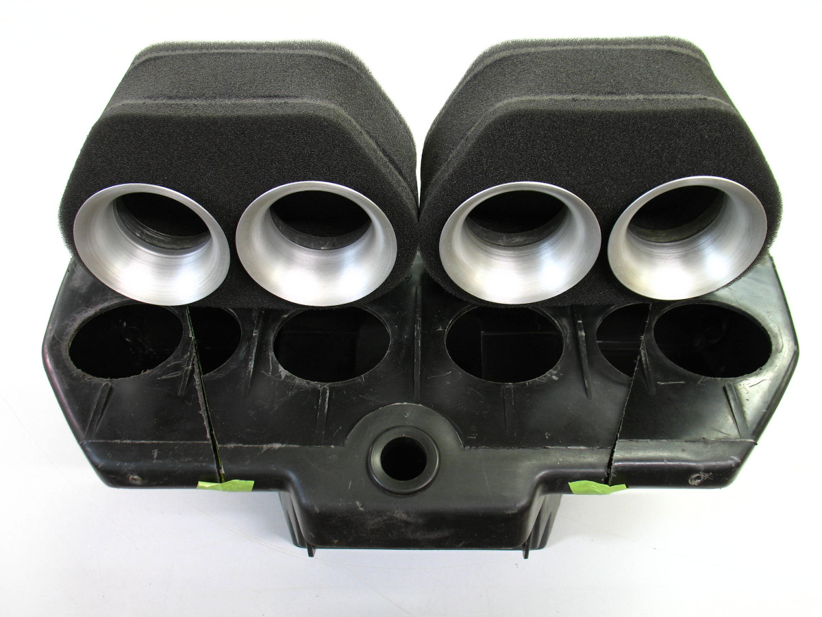

I hope to make one widened air box (from two) to accept 70mm long velocity stacks straight off the carbs, or Pipercross foam filters with shorter stacks, fit into oval shaped holes in the air box face. It would still look stock, having the original chrome covers and frame-attachment fittings for support.

As of now, I plan to remove the existing interior structure to create a large opening to the filter area.
