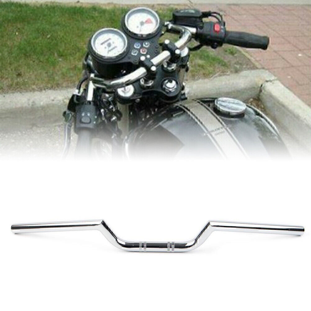

Leaning towards the clip-ons only because the clubman bars I ordered ( www.amazon.com/dp/B07LF4P57L?psc=1&ref=p...dt_b_product_details ) look to have almost the same position and rake as the stock bars. Are there different clubman bars I should be looking at?

PS: the clubman bars in the Amazon add are mounted upside down !!!!! Also don't forget if you go down to clip-ons you may need shorter brake hoses as well

Ah ok, that makes more sense. I was struggling to understand why anyone would bother with the clubmans. Thinking i'll go that route given they're pretty close to the clip-ons without as much headache for me anyway.
