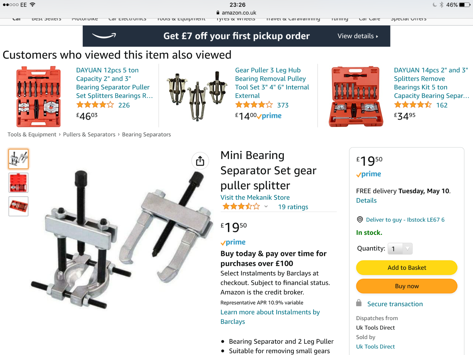

Could you use a "two legged " puller hooked under the tree to hold the plug down while you concentrate on the clip (would also allow you to release the spring in a controlled way) could also be used to compress the spring for re-assembly ? Something like this

- Sdaniels2010
- Posts: 91
- Thanks: 6
Re: KZ440 fork cap removal
07 May 2022 15:29Well I've already got a couple of dents so I'll take your advice I like Wookie's idea of the puller that would let me focus on the circlip. I tried it again this afternoon (wife was out) & I'm getting closer to managing this. I'm betting once I've done it it'll become second nature. But for the moment I decided to put her back together & will wait for the replacement forks to arrive...those are the one's that'll be getting torn down anyway.I've never removed that sort of circlip. my disclaimer. hee. I guess I would try using an awl & pry directly opposite from the gap in the circlip. If possible, maybe clamp something in place to keep the circlip from spinning, like maybe a section of coat hanger bent to fit. ??? just spit-balling. In case it needs to be said, wear eye protection in case the circlip goes flying. the fork spring seat could go flying as well & dent your head. ha ha.
