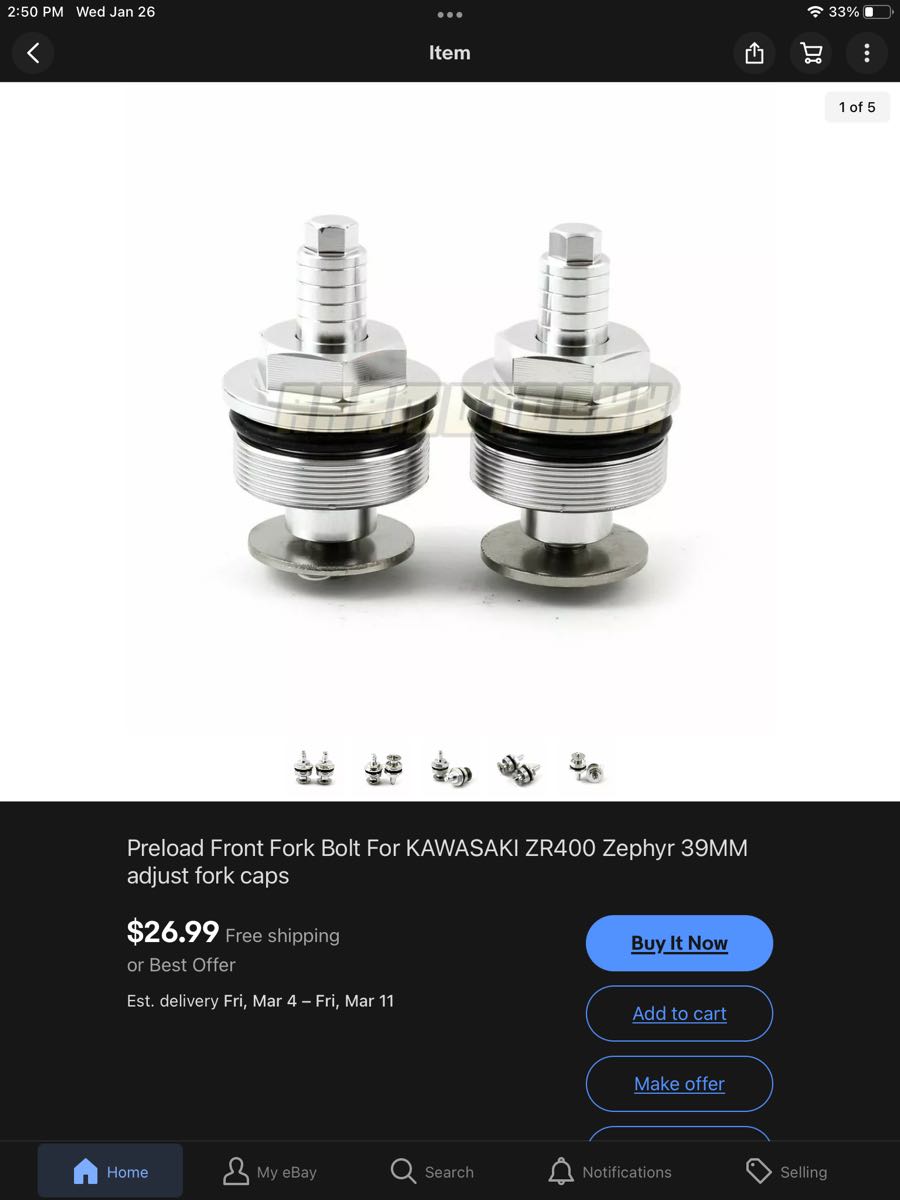

Turning my nice original 81 1100 shaft into a daily driver with ordering shocks, cartridge emulators, fork springs and a Sargent seats job to give the seat a ZRX look.
I’m thinking of fitting fork preload adjusters and getting rid of the air valve. Does anyone know of compatible fork preload adjusters such as the following link? I’m half assuming someone here’s done it already.
711-127632-2357-0
thanks if there’s info to share.

Are your forks 38 or 39mm? Why wont the ones in the link work?

I think the Z1100 has 39mm. The eBay listing, iirc, said the item has 34mm threads. Fitment parameters would be thread diameter, pitch and depth and hence the question…..

I just checked and the forks are 38mm. Does anyone know if the 82 or 83 went to 39mm?
