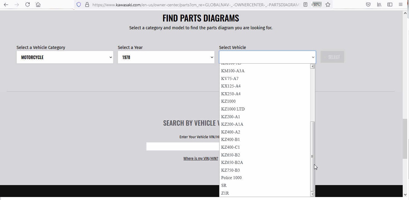

01 Jul 2021 17:29 - 01 Jul 2021 17:55I admit I certainly make the occasional dumb ass comment. However, it would seem logical for the original poster to state which 1978 Kawasaki he plans to install a front wheel on. In 1978 Kawasaki made a bunch of different KZ models ranging from 200cc models on up through 1000cc models. They do not all use the same front wheel, so specifying which model would be helpful. I looked between the lines, but did not see what model was being discussed - did I miss something? One very simple way to avoid such issues is to simply add the year and model to the signature line. That way one does not need to remember to show that information in every posting. EdIgnore ED mate, he seems to have a problem reading between the lines and adds the occasional dumb ass comment. ....
