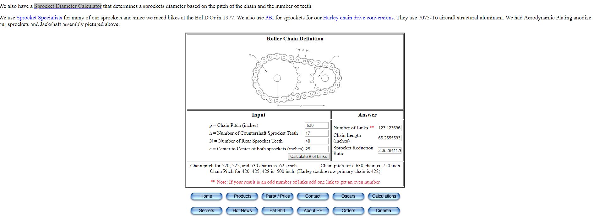

I would use the Chain Length Calculator @
www.rbracing-rsr.com/chainlength.html
If i would convert to a 530 chain (630/15/35) this would be my setup.

Put in the Center to Center of both sprockets and the calculator give you the numbers of the links....
