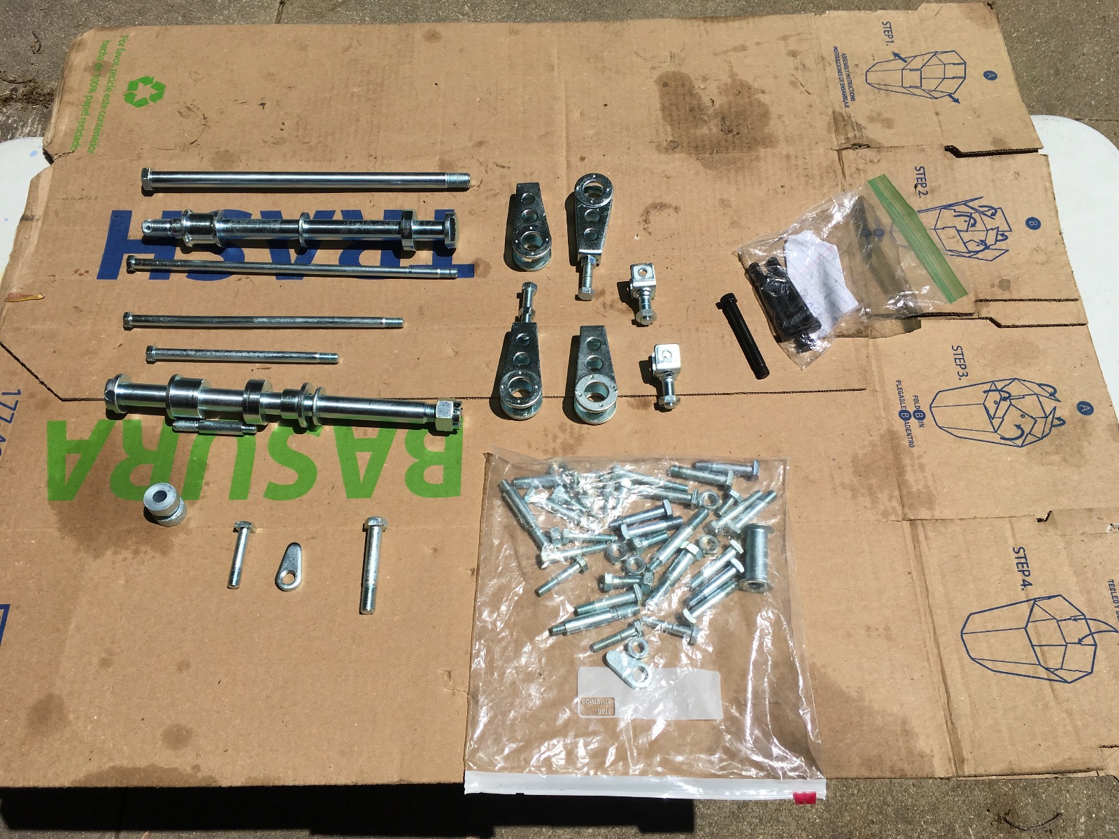

Lots of good info so far.
Still curious on the cost comparison. It seems a pretty decent setup can be had for around $300. How does this compare to most in having parts done by a plating shop? Not looking to have engine covers or anything like that plated, just nuts, bolts, axle shafts, chain tensioners, etc.

I had almost exactly the item you mentioned done for less than $200. That includes shipping and Vapor blast.
