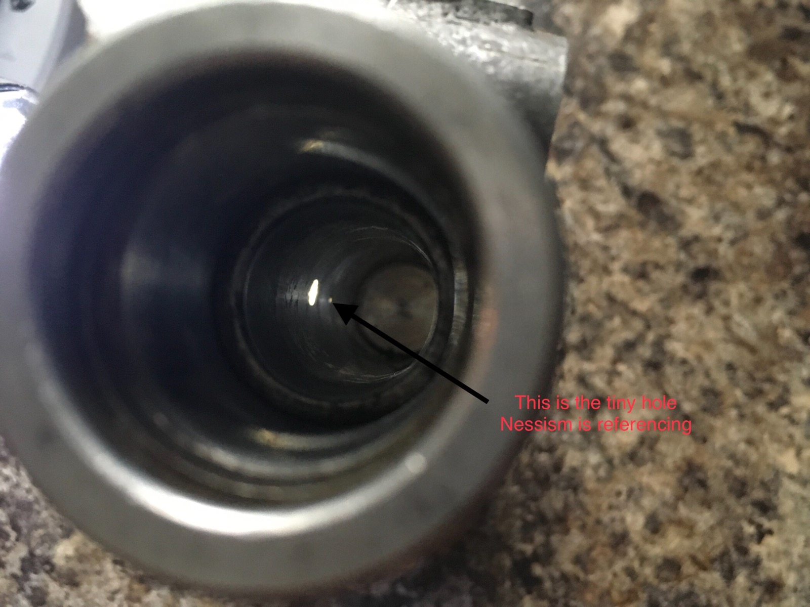

03 Jul 2020 13:09My master cylinder doesn't have that hole in it.

I removed the master cylinder and it was pretty disgusting so I cleaned it out thoroughly using brake fluid. There aren't any rebuild kits or even used master cylinders anywhere on the internet or CL so cleaning is the best I can do.
When I remounted the cylinder I made sure to spray down the lever components again with WD40 to make sure that they don't stick. I bled the brake and I found that the brake was still dragging. The lever rebounds fully and quickly, but the brake piston is still dragging on the rotor.
I removed the caliper, pushed the piston back in, then re-bled the brake to make sure it was okay. Again the brake was dragging.
I assume this means I need a caliper rebuild kit?

The MC wasn't pitted but there were witness marks (to be expected). I'm just guessing that a caliper rebuild is in order, but I'm also not sure that I did things correctly with the MC.

I’d say by process of elimination that’s your next move... before you crack the seal on the piston or brake line, check the caliper mount bolts to make sure caliper slides freely on then. Might be a simple clean and grease to free up.
