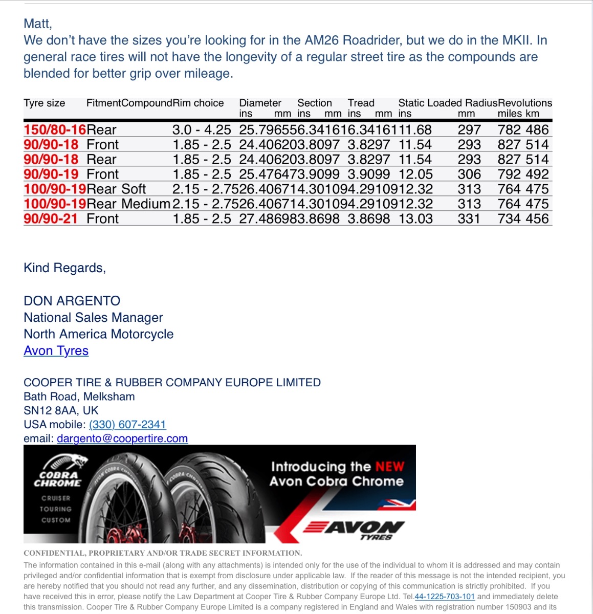

Here a screen shot of the response from Avon and you guys are correct again... looks like the ‘78 B2 will be getting the MKII’s in the fall.

Thanks for this thread. I couldn't find the AM26's over here but I can get the MKII's. Now I know that this is what I want anyway. Will be getting a set as soon as I get a chance to burn through the Conti's.
