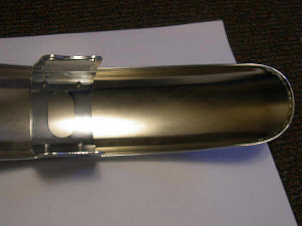

- Thanks: 2830
Re: Fork stabilizer
31 Aug 2019 08:09
