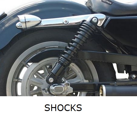

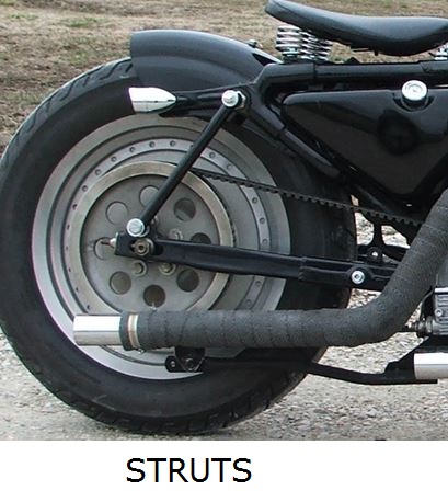

Struts are solid bars that offer zero cushion. If your bike has struts it transfers any energy caused by a bump or hole in the road directly to the frame; this is not helpful for handling, braking, or your kidneys. Shocks are generally hydraulic units and they dampen the effect of bumps and holes in the road. You stated "..... i was wondering if its possible to adjust the ride height on stock struts" but your bike never had stock struts, it came with shocks, so your question was somewhat confusing. Ed

I don't think any motorcycle manufacturer ever used struts rather than shocks. I suspect some folks use them instead of shocks because they then can mount the rear wheel very close to the fender and frame since the rear wheel will not move up and down inside the fender or frame. Of course, one big problem with struts is the fact that when going over a bump or pothole the hole bike will jump up and down rather than just the rear swingarm, and this can lead to a serious handling problem especially if hitting the bump or hole while riding around a turn. The other problem is the fact that the jolt from any bump will be transferred to the rider, so some folks using struts mount the seat on springs. If you take a look at the seat in the picture of struts I provided you will see it has springs under it. Ed
