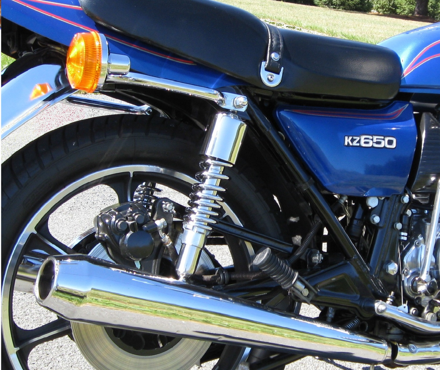

I've had Hagon shocks on my KZ650-C1 for nearly 12 years (16,000+ miles). They still work like new and look like new. I really like them a lot! Ed

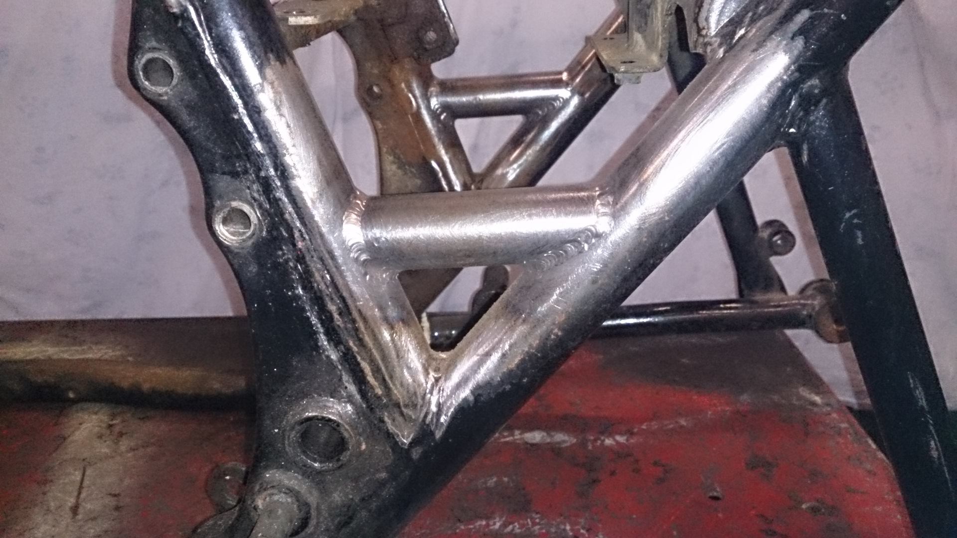

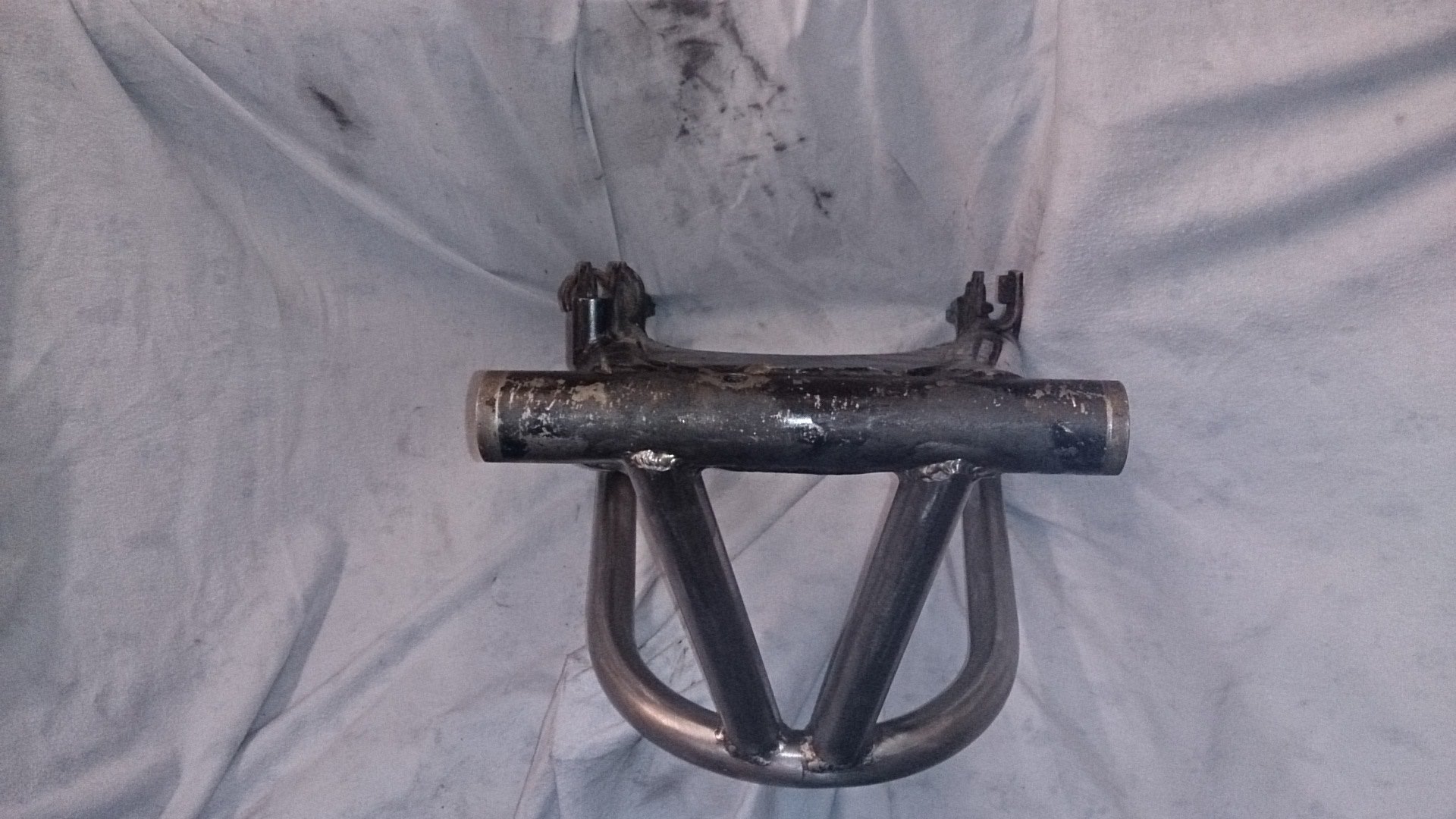

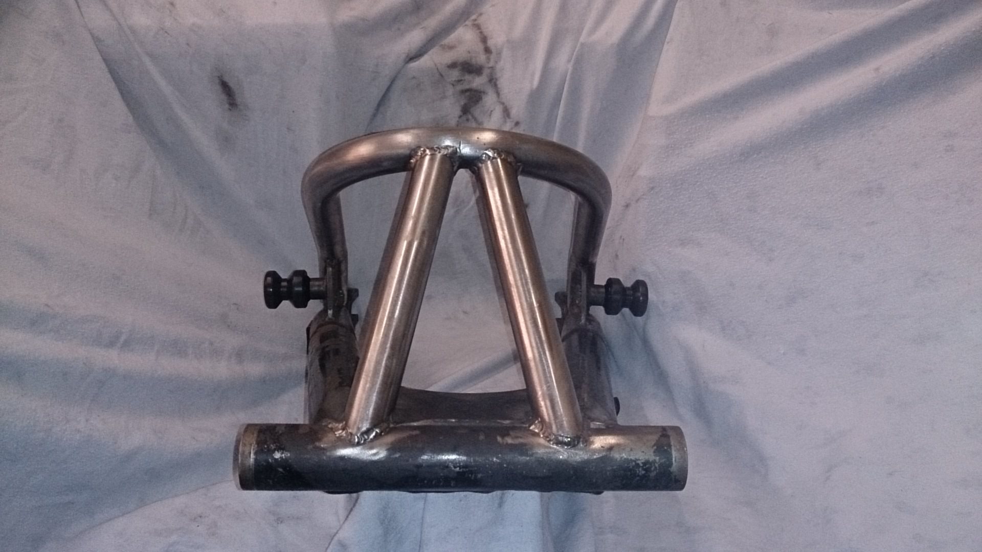

To be fair it depends on what you want out of the bike when finished, one of the best improvements is frame bracing, my own has this and it's a very worthwhile modification stiffening up the frame no end, i also have TEC adjustable shocks not expensive around $200 US, on the rear, set at around 270mm eye to eye and this speeds up the steering, tapered roller bearings for the head stock and triple trees stock forks with a slightly heavier grade oil than stock, rear arm is stock with a deep brace added needle roller bearings installed, stock wheels, a cut down seat as i have short legs at only 28 inches, with these slight improvements 40 year old bike handles a lot better than a stock zed

The frame bracing and swing arm bracing was commissioned by the previous owner, it's a common thing over here, it tightens the frame up, kits can be bought on the internet, i put the adjustable TEC shocks on, which i have adjusted to around 370mm in length, around an inch higher than stock they are made in the UK and are fully re-buildable and a good price, the front forks are just standard with a grade higher oil in them, just these simple and not expensive things make for a better handling bike, here is a link for the shocks, and cost me at today's exchange rate $180 usd, also some pictures of the frame mods. P.S i am only around 150lb's wet a year ago i was over 220lb's.

I will admit that I would like to beef up my stock swing arm, and probably will on my next build.
Thanks for the pics
Thanks for the pics
