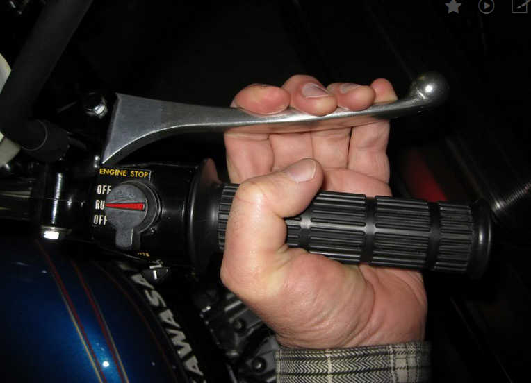

You might want to try pumping up the hand lever and then squeezing as hard as you can, then strap the lever back against the grip. The idea is to create as much pressure inside the system as possible so the pistons move closer to the discs. Leave the bike with the lever pulled back for 24 hours and see if the lever firms up.
BTW, did you lubricate the caliper sliding pins with heavy duty black moly caliper grease?

Nsssism, I've often heard the process you describe above. When I've heard it before the cap was to be left of the master cylinder reservoir. Cap on or off make any difference?

23 Mar 2018 20:18ajsfirehawk wrote: Nsssism, I've often heard the process you describe above. When I've heard it before the cap was to be left of the master cylinder reservoir. Cap on or off make any difference?
Doesn't matter.
